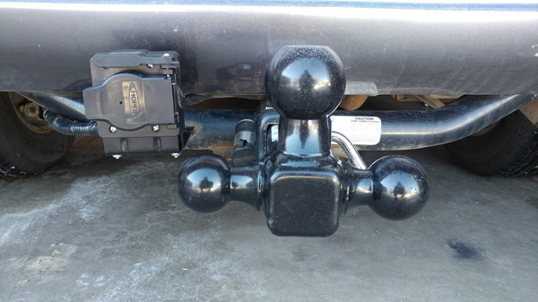

pchast wrote:I would not leave the connector there. Can it be mounted above the bumper/hitch somehow?
Hi Pete,
There is no place that I can think of. Looking for ideas. Thanks for chiming in.
Do you think it would be okay to flip it upside down on the same mount. That would be an easy fix.

look like some ground clearance could be gained by sliding the connector side ways and up the trailer hitch either way. Also, depending on what size of ball will be used - these 3 way receivers can cause problems when being used when one of the balls is in the down position - it can be a bottoming out point of contact, especially when going in/out of parking lots.

Postby MrBo » Tue Jan 23, 2018 10:41 am
gudmund wrote:look like some ground clearance could be gained by sliding the connector side ways and up the trailer hitch either way. Also, depending on what size of ball will be used - these 3 way receivers can cause problems when being used when one of the balls is in the down position - it can be a bottoming out point of contact, especially when going in/out of parking lots.
Thanks for the tip. I have never used a three way before but at least in this position there is no ball on the bottom. Not sure how to mount side ways. What do you think about trying to flip it upside down?

Postby MrBo » Tue Jan 23, 2018 10:49 am
I think you are right. Do you have any ideas on what I could use to make a bracket to mount sideways?
I may be able to r rotate 7 pin in the bracket it has and then I have one that came with a kit for hitch mount I could flatten this and would extend it out for enough to mount in the up position and then put the 7 pin in a sideways instead of upside down.
Off to ace I go.

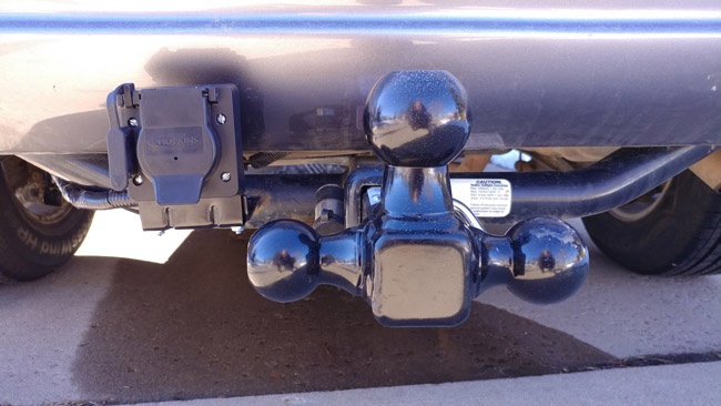

Postby MrBo » Tue Jan 23, 2018 12:33 pm
Thank you Guys for setting me straight. I think this will work. I feel much better about this now.

Postby MrBo » Tue Jan 23, 2018 2:31 pm
Correction... Just realized it could be upright...

Postby gudmund » Tue Jan 23, 2018 7:36 pm
the electrical hook-up is looking good now but you may not be able to use the 3-way being the use of the 2 inch ball may mean the opposite ball ends up bottoming out. You would just have to use a receiver with the single ball setup in the ball size you are using.

Postby MrBo » Tue Jan 23, 2018 7:41 pm
gudmund wrote:the electrical hook-up is looking good now but you may not be able to use the 3-way being the use of the 2 inch ball may mean the opposite ball ends up bottoming out. You would just have to use a receiver with the single ball setup in the ball size you are using.
Thanks! That will not be a problem because I have another single 2" ball that was on there before this. As long as this set up works with the 2 5/16 on top I am happy.

Postby pchast » Tue Jan 23, 2018 11:36 pm
Looks good now. :thumbsup:
