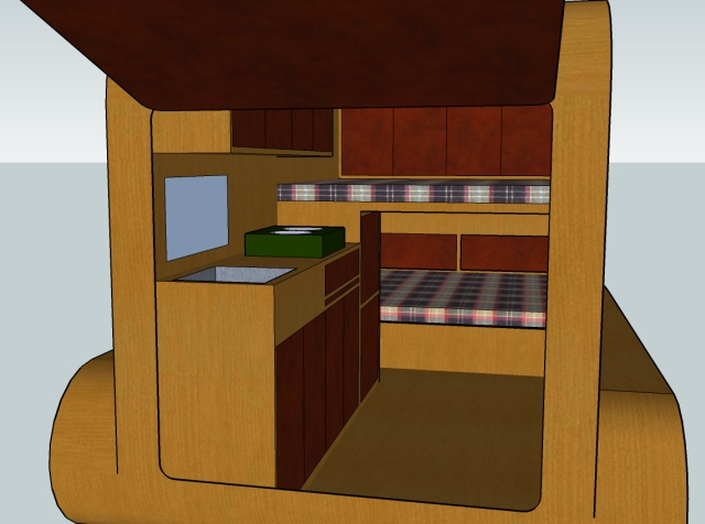

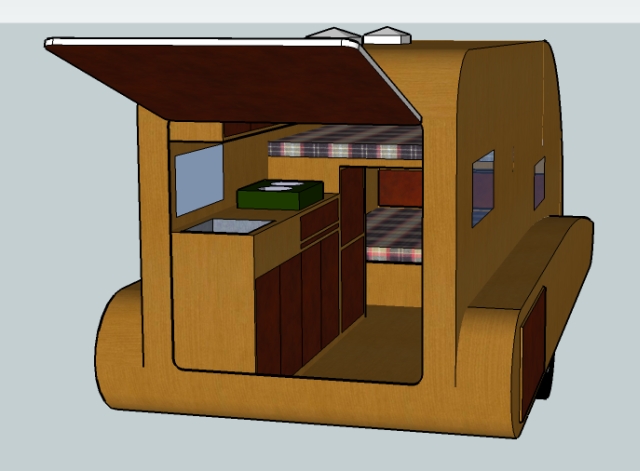

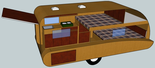

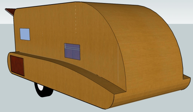

MK, I reversed my design for the aerodynamic benefits. Plus, I liked having a rear door that could double as an awning. This design caters to my wife's desire for a house on wheels for us and our two teenagers, though it's probably all my Tacoma could stand when fully loaded. Sixteen feet long, six feet tall, and five feet wide inside. Just an experiment, and it doesn't include a potty, but maybe it'll give you some different layout ideas.
Hey, I like to draw. Peace.
