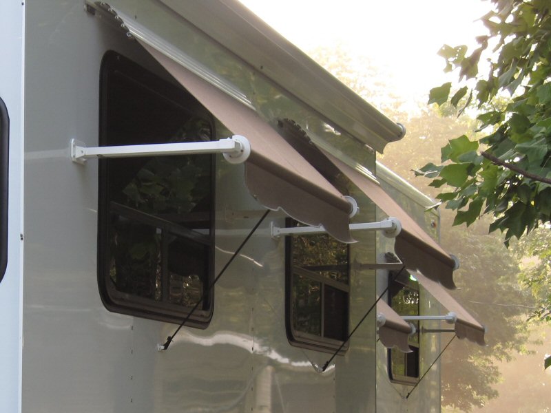

Here's some window awnings that we saw this past week. Now I know you are not looking for window awnings, but perhaps you can apply the same idea to your roof awnings.

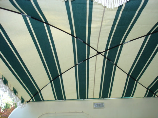

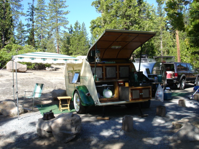

I used 2 adjustable poles, 2 ropes and some studs on the trailer edge, as opposed to the track, it fits on either side. It's a real eye catcher and I love it! Doug

Very nice Doug. How about a close-up of the stud if you get a chance?

The stud has a screw base and a twist top to hold the awning in place. It's typical of what used to be used on boats and older cars with canvas tops. The real good idea I had was to use some shock corded glass poles, cut down to fit the awning. I had Marti sew in some pockets in each corner with a piece of velcro to hold them in place in the center of the top. I'm 6'2" and can stand under it with no problem, much higher than the side of the tear where it is attached. They really punch up the flat surface of the awning, and it won't collect water....it survived the Dam Gathering and we got 6 inches of it there, awning up the whole time. Worked for me. Doug

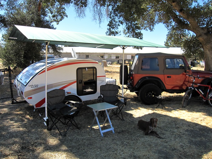

Another awning option and one that was the best solution for me in this common teardrop quest for shelter: Teardrop Awning Solution!

I like that awning Scott! Looks great and gives you all sorts of head room.

That is a cool awning.
I especially like the shorthair pointer. I lost mine in the spring. They are great dogs. Thanks for the post. :thumbsup:
