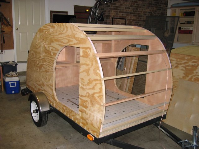

Here's where we are right now. More new pics posted in our album.
