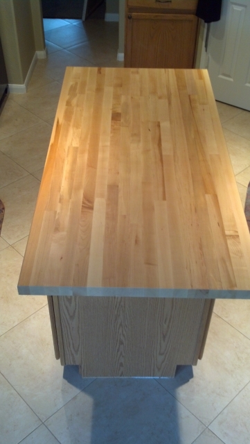

Okay, here's an easy one for you: The galley countertop is a fairly heavy piece when it's solid wood. How can I use foamie techniques to make a countertop that is lightweight, has a good work surface, and will add strength to the structure? And looks good. 60" x 30". Remember, I've got the CNC that can make molds or whatever. So if you can think it, I can probably make it. Anyone else that wants to chime in here is more than welcome.
I got a good buy on a maple butcherblock that I was going to use for the countertop, until I went to load it into my truck. Holy Smokes, that was heavy! It now adorns my kitchen island. It looks marvelous.

So are you thinking of still using the butcher block? If so, take some matirial out of the underside and replace it with foam. It would look sweet in the galley.

RandyG wrote:So are you thinking of still using the butcher block?
No, I think I'll keep it in the kitchen. It looks pretty good there. I'm going to do some R&D on foamie alternatives before I make a final decision. They'll make more if I want to get another one.
RandyG wrote:If so, take some matirial out of the underside and replace it with foam. It would look sweet in the galley.
I considered that, cuz it would look really, really good. :thinking: I would take material off the bottom and replace it with air. :D The tree hugger in me is offended by turning 40 (of about 75) pounds of that maple b-block to router dust. If I can't build a good foamie alternative, the tree hugger will have to go sit in the corner and shut up.

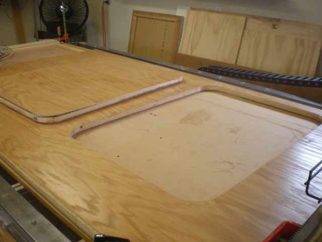

Progress progresses.
Today I got the first routing operation on the starboard wall done. Door opening, trimming the interior panel. The router is performing much better now, and things moved right along. No steps got lost, and right angles were square. :P
Here's the door cut out:

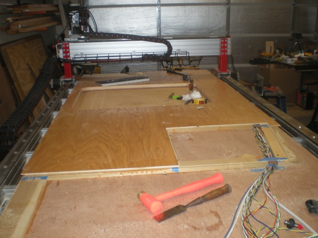

Looking back to front:
Today I discovered that the Bosch 1/4" downcut bit is much more effective than the equivalent Freud. The Bosch has a more spiral-ly spiral for a steeper downcut angle. Nice clean top edge with no splinters. The Bosch is at Lowe's, the Freud at HD. The Bosch gets the capnTelescope Seal of Approval. :thumbsup:

PS: walls are looking great !
looks like you built the wiring in ?
