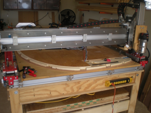

Lots of router dust!

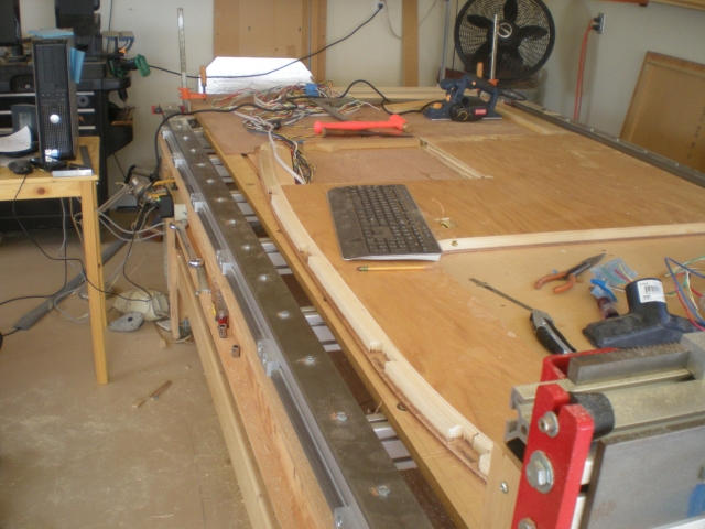

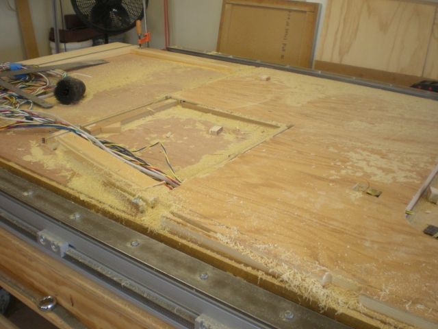

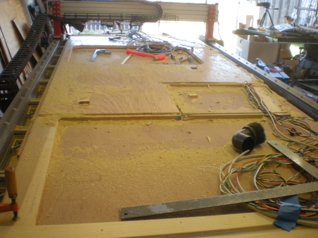

Yesterday I went to work on the starboard wall, and finished all the cuts on the front end. Both walls are now at the same level of done-ness, not counting some detail work that should get done today.
Here's some shots before cleanup:

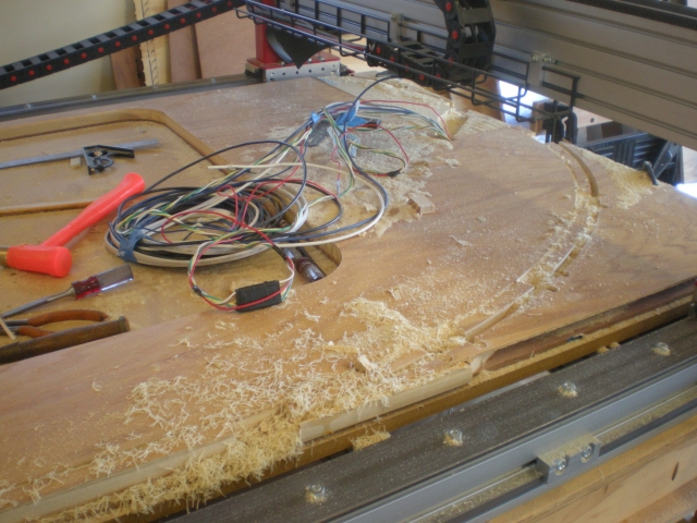

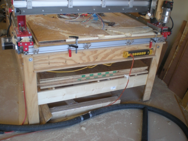

Small steps today. First, a couple more shots from yesterday, showing the semi-finished wall after cleanup.

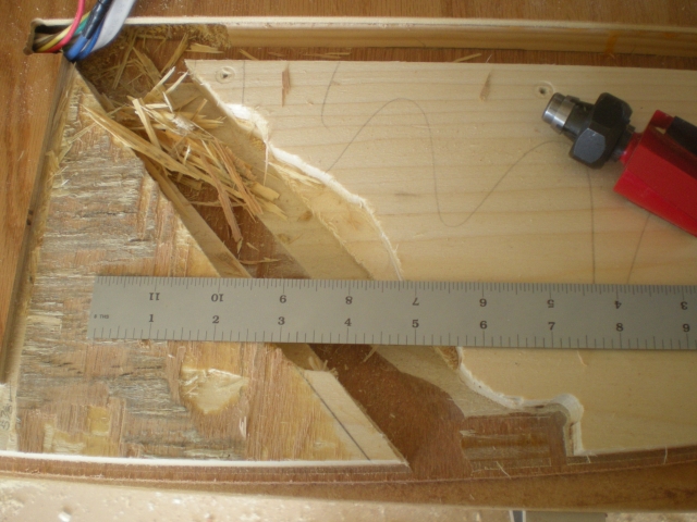

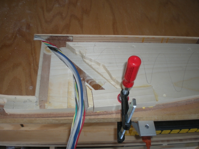

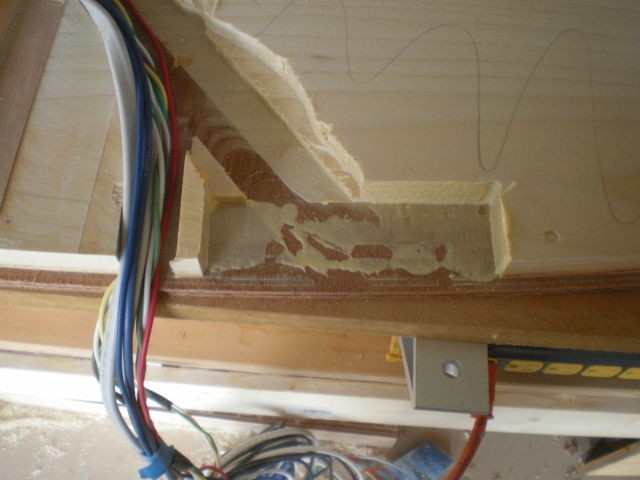

A channel I freehand routed in the nose to let wiring into the tongue box blasted through one of the spar pockets. Repair is required. :(

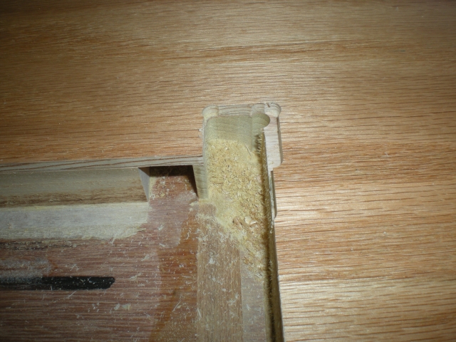

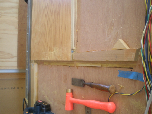

The aft bulkhead framing was off a bit, and left a big chunk of wood to be removed. Turn your head to the left and the pic makes more sense. Sorry 'bout that. :oops:

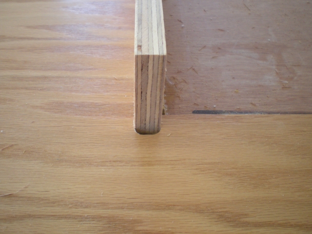

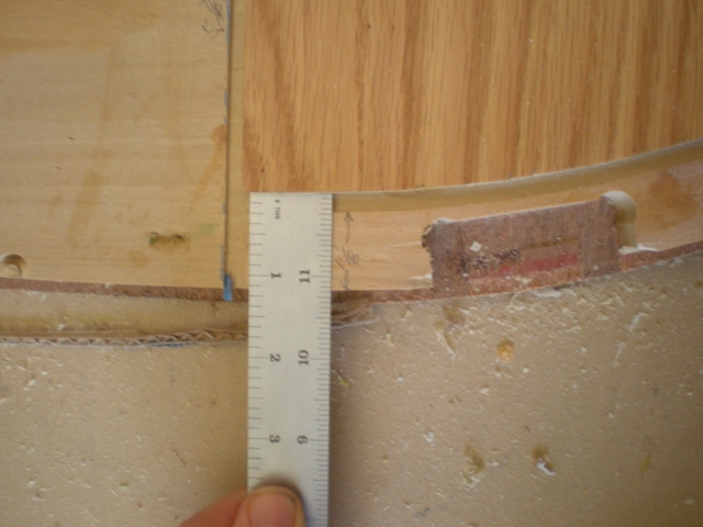

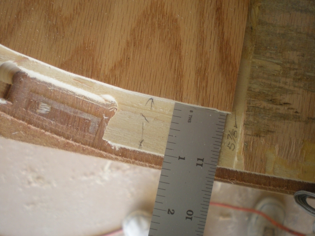

I used the 1/2" bit to rout the cabin cabinet's faceplate framer, which left gaposis at the bottom. I should have used the 1/4 and corner relief here, as well as on the left wall.
The space between the ceiling and the roof (the attic? :laughter: ) turned out just right on the right wall,
but is off by 1/8" on the left wall.
I don't think this will be a big deal, but it just annoys me. This is undoubtedly due to the earlier problems I was having with the router. BTW, the router is working semi-flawlessly since the upgrade. There are a couple of new idiosyncrasies, but the bad old ones are gone. :thumbsup: :D It's so much easier to get work done when you can trust the machine not to wander around on its own.

Fixing the zit on the nose is fairly straightforward. Rout out an area for a patch piece and reroute the wiring:
Glue in a patch piece to be machined later:

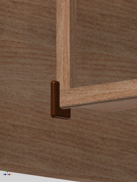

One way to hide a mistake is to "celebrate" it as an architectural style "feature". If you cap the wall at the bottom of your cabinet frames with a contrasting trim, such as a dark stained oak flange (I'm thinking a square "rosette" with rounded edges terminating the bottom of the cabinet rail at the wall), or 1/4 round molding, your eye will be attracted to it in a good way, rather than spotting it as a patch in a bad way.

KCStudly wrote:... such as a dark stained oak flange (I'm thinking a square "rosette" with rounded edges terminating the bottom of the cabinet rail at the wall), or 1/4 round molding
I'm not clear what the flange you're describing is (got a pic?), but I can do 1/4 round. Even make my own. Smaller than storebought 1/4 would be called for here, I think, because it's a small space (and goof). Half inch quarter would be too huge in there, IMHO. I'll probably want it for the ceiling, too.

Postby KCStudly » Mon Feb 10, 2014 10:29 pm
I'll try to model something up tomorrow after work.
I'll try to describe what I am picturing a little better. Let's say that the bottom rail on your face frame is 1x2. Now imagine a flat rectangle, maybe 1/4 to 3/8 thick x 2 inches wide x 3 inches tall. Now round the corners a bit, then round the edges over with the 1/4 inch round over all around, then cut a 3/4 wide slot in the top so it can slide up around the bottom of the bottom rail symmetrically (trim the side under the cabinet as required to clear the side ledger or cabinet floor).
Sort of like a flat square rosette punctuating the points where the rails meet the walls. The fit would be kind of like those pole sockets people are using for canvas bunk rod hangers, except squarish.
Re: CNC Build -- New Video
Postby KCStudly » Tue Feb 11, 2014 9:14 am
Here's what I had in mind for the rosette.
If you carry this theme throughout the build, using the same contrasting wood (like walnut) for trim, such as under your light fixtures and switch plates, paper towel rack, door and drawer pulls, etc., it would really add a nice touch of detail.
