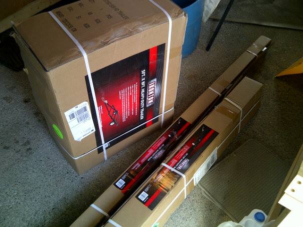

Postby absolutsnwbrdr » Thu Feb 20, 2014 11:31 am
It has arrived! Took less than a week to get here.
I'll crack open the boxes tonight and figure out the exact width of the trailer frame so I can order the Dexter Torflex axle tomorrow! :twisted:

Postby Tommy2tone_1999 » Thu Feb 20, 2014 6:38 pm
Let me know if you figure out what the 2 wedge shaped pieces are for with that Ironton Trailer
