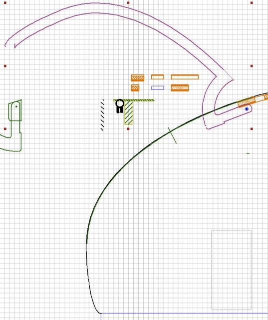

So long as the hinge center line is ahead of the forward edge of the hatch skin, and the plane of the bottom of the hatch skin is above the hinge center line, won't the skin lift up off of the seal and roof skin, rather than pivot into it? Additional separation between the surface of the skin and the hinge point may be needed to account for degree of opening and curvature.
That's an interesting detail to noodle out. Hope you are using some sort of 2 or 3D modeling.
+1. Be careful not to under estimate the forces at work on a hatch hinge. Between the weight of the hatch cantilevered on the lift struts and the leverage back to the hinge point, a lot of force can be generated.

KCStudly wrote: Additional separation between the surface of the skin and the hinge point may be needed to account for degree of opening and curvature.
You are correct, sir. I'll probably move it back fairly near where the point on the strut is. It gives a larger radius from the hinge point, so the edge goes up faster than it goes forward.

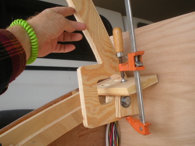

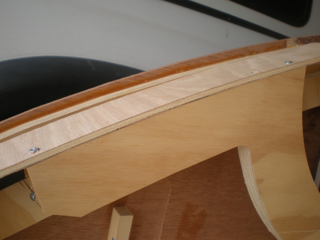

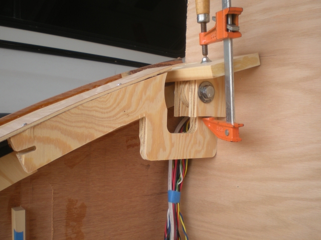

More R&D today. rolled out hinge 2.0:
Reeeeal close, but still cigar-less.
Then I said to myself, "Self, did you account for the thickness of that 1/4 ply you mounted the hinge on?" Then I said to myself, "Self, no I didn't. Quickly! To the table saw!" Shortly therafter hinge 2.1 was up:
Pictures don't really do it justice. Maybe this: :dancing :chicken:
I'm going to try a full length one tomorrow.
Thanks for stopping by! :beer:

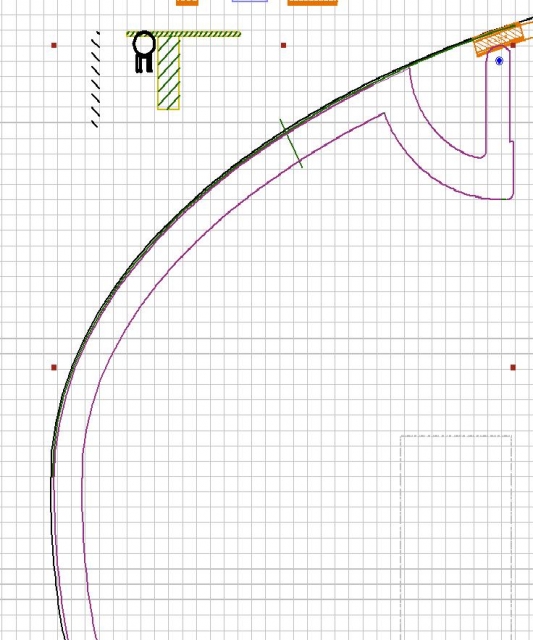

For the idly curious, here's a couple of printscreens from the CAD.
Hatch shut:
Hatch open:
Notes: The zigzag in the hinge end of the spar is clearance for the 1/4 ply it's mounted on. Also ignore the little fishhook thingy. What do you expect for <$100 CAD? (DesignCad 3DMax)
This all brings up another question. The bottom of the hatch when open is barely taller than I am. How high is your hatch bottom when open?

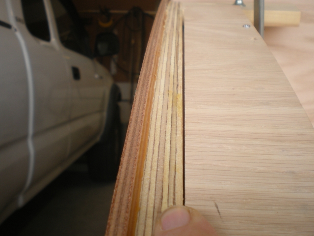

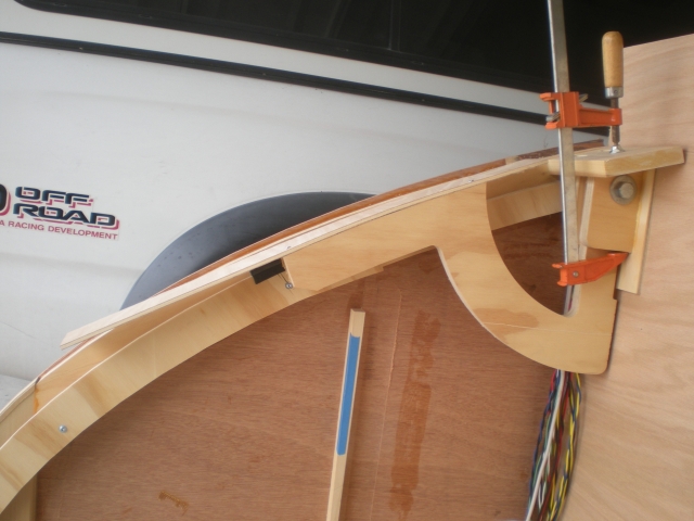

Did a quick mockup of Hinge 3.0. Results are very promising.
I'm now getting a much better open angle. I may not have to worry about bumping my head, now. :thumbsup:
This design works because the hinge has a deeper throat. BTW, Deeper Throat :shock: is now a serious finalist in the Name This Teardrop contest. I wonder if I can get that on a license plate? :scratchthinking: DPRTHRT?
