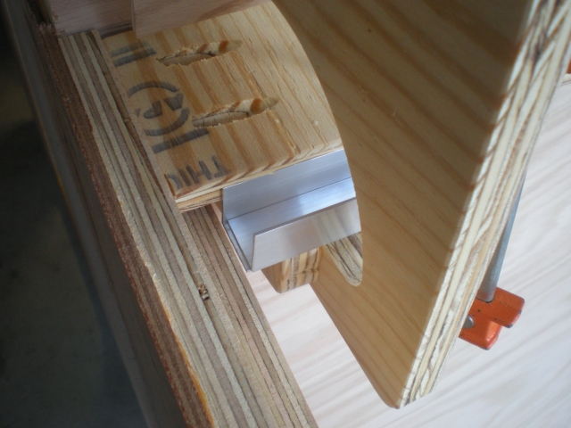

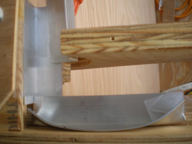

Let's look at the picture:
Here we see the top gutter actually meeting the side gutter, although there is a difference in altitude that needs to be fixed. No big deal. BUT, I'd like to radius that intersection so I don't have to cut the weatherstrip at the corner, lest some vortex form and ruin everything. :roll: The side gutter is also a mockup, so we can do whatever is necessary to join up to it. (It's missing the inner wall/side here, which is also negotiable.)
I have a few half-baked ideas about how to do that radius:
1. I could fabricate a corner block with the required radiused 1/2" high x 1/4" thick stickin'-up-thing for the weatherstrip to go onto around the corner.
2. I could make a gutter across the top that has the corners and the stickin'-up-thing built in. Material could be wood, aluminum or glass/epoxy or some combo thereof or... something else. Wood might not be too good, as there are a lot of thin cross sections. It would/could be CNC machined, of course.
3. I could make a casting pattern, and cast it out of empty beer cans and used alum foil.
4. Actually, the 2 pieces of aluminum angle that I used to get something to look at isn't all that bad an idea for the top gutter. The width of the gutter can be made to suit. Some kind of goop can seal the seam and the join to the corner blocks. I would use thicker stock than the 1/16" HD had.
No idea is too weird if it can be built. Anything goes. Don't forget that CNC is available.
Any suggestions, anyone? Bueler?

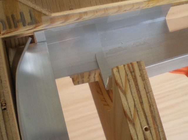

It doesn't show real well, but 3.1 has a support shelf for the gutter cut into the hinge block. That will locate the gutter on the front-back axis and square it to the left-right axis. The left-right axis doesn't currently have a stopper, but that might be a good thing?
Here's a Paint closeup, just to make it clearer:
I didn't bring the gutter wall up high enough to get in the picture, but it's (currently) 1/4 ply coming up 1/2" above the gutter bottom.

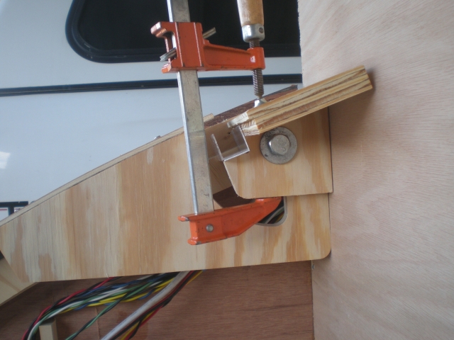

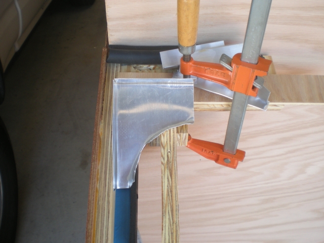

Re: CNC Build -- Hatch 3.1 Corner Tinkering
Postby capnTelescope » Wed Mar 19, 2014 3:47 pm

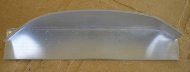

I was out tinkering in the shop today and had another successful failure. :)
I thought that if I did something like this:
and applied a pipe clamp, I might get something useful. No. :thumbdown: And yes! :thumbsup:
Not much use for this:
But I took it to the Hatch Lab anyway.
And ended up with this:
Crude, but maybe it'll help some of you see the upper transition. More importantly, a great discovery was made in the traditional way -- by accident. Notice how the two pieces of angle are not parallel. You really can't tell from the picture, you had to be there, but the bottom piece of angle is creating a downhill slope from the centerline of the hatch. I noticed this while I was trying to piece this together, and said to myself, "Self, this is one more reason to like the two-angle design." This gives the water a reason to go where I want it to go. :worship: Ommmmmmm.
Comments and suggestions are always welcome. Thanks for stopping by! :beer:
Postby capnTelescope » Wed Mar 19, 2014 4:30 pm
Oops, almost forgot...
Here's a top(ish) view of the above:

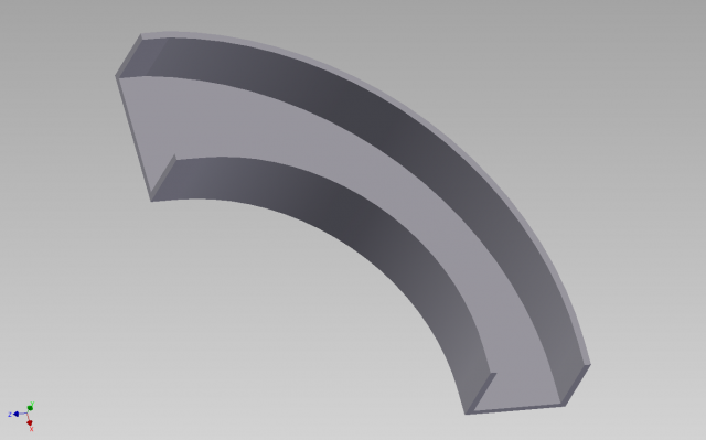

Postby KCStudly » Wed Mar 19, 2014 5:49 pm

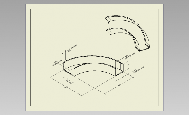

How about something like this for the corners?
One as shown, one opposite hand.
The 1/2 inch tangents in the throats would allow for riveting the top gutter on and whatever transition you want to do for the sides. Notice that the top throat is wider to allow the sloped lower half of your top gutter to be wider at each end
I think maybe I, and perhaps others are getting confused about the side gutters because you are not showing an inner wall, and there is a gap between the top gutter mockup and the side walls.
So to be clear, you do not plan to form aluminum side gutters but do plan to line wooden side gutters with epoxy, or some such super duper sealant.
I would be happy to contribute to your build by fabricating the shown gutters; just let me know what you want for dimensions keeping in mind stock flat bar sizes for the sides. These would be made from sawed flat stock for the bottom and formed flat bar for the walls welded on the outside corners. It is very likely that the material for these can be scrounged, at no cost.
The outside radius could also be squared off, if you prefer.
If you would rather form these yourself, you could make a wooden buck (on the CNC, of course), use dead soft 1000 series or 3003 alloy aluminum sheet and hammer form them over the buck, then trim the excess edges flush to the surface of the buck with a sanding disc. It is really not that difficult to do as long as the tooling for the buck is solid. Here's an example. Essentially it would be a piece of hardwood or good ply the shape of the inside of the trough with another piece bolted to the back side that acts like a clamp, keeps the work piece in place, keeps the back from warping while the edges are hammered over, and keeps you from accidentally hitting the back with the hammer. Since you don't want holes in the piece from where the clamp bolts go (and can't weld them shut after the fact), you would have to make the piece a little oversize, putting the clamp bolts thru the sandwich at the edges, then trim the excess areas with the holes off after.

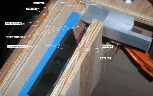

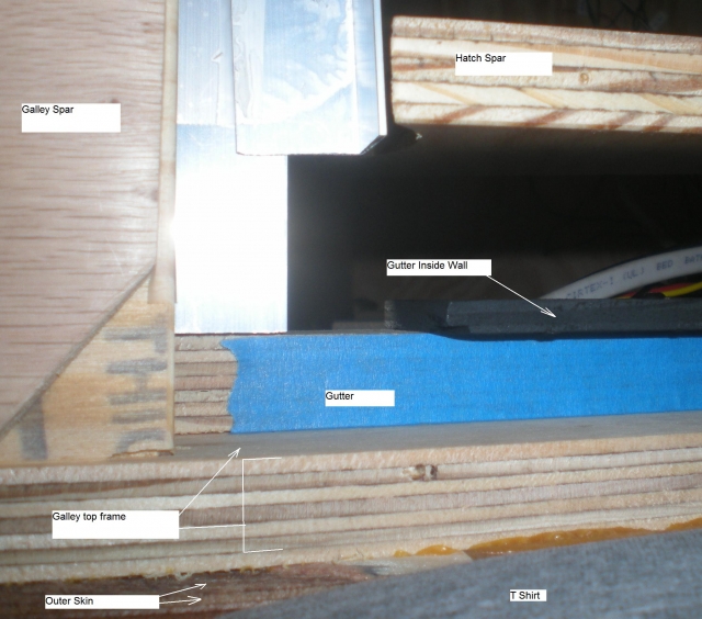

Postby capnTelescope » Wed Mar 19, 2014 9:32 pm

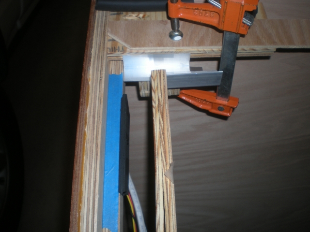

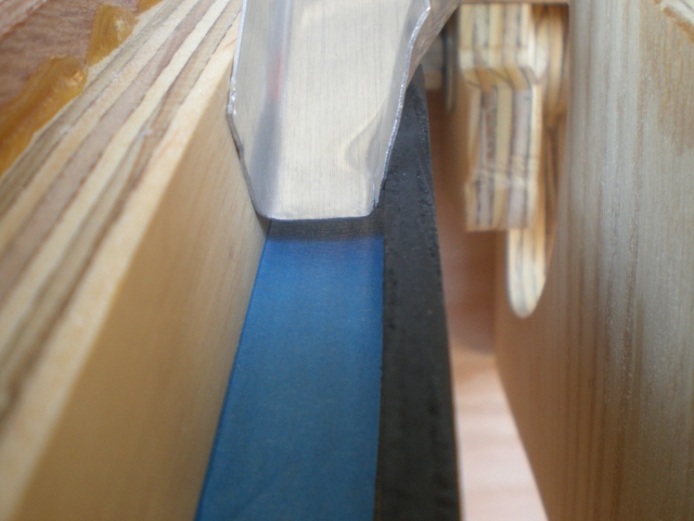

KCStudly wrote:I think maybe I, and perhaps others are getting confused about the side gutters because you are not showing an inner wall, and there is a gap between the top gutter mockup and the side walls.
Agreed. I've felt frustrated because none of the pictures showed all this clearly, causing me to have to give these wordy descriptions and ass-u-me anyone could understand. So I took on this mission, and made clear?, annotated, color coded pictures to show all the major parts (I hope).
Black = side gutter inside wall
Blue tape = side gutter bottom
Rear view, looking forward
Top view from left side
Why didn't I think of this sooner? :oops:
Postby capnTelescope » Wed Mar 19, 2014 10:49 pm
Meanwhile, back at KC's post...
KCStudly wrote:How about something like this for the corners?
That's what I'm talking about. I'll need to check dimensions.
KCStudly wrote:So to be clear, you do not plan to form aluminum side gutters but do plan to line wooden side gutters with epoxy, or some such super duper sealant.
Uhmmmm. That was the original plan. The more I work on this, the more inclined I am to think I want machined aluminum for the side gutter inner walls. .06 thickness, not the .25 I mentioned earlier, cuz HD 1/4 inch ply is ap-cray, and another sheet of 1/4 marine ply is $50. I'll CNC those (I hope). Super duper sealant on wetted wood and steel, and where wetted parts join.
KCStudly wrote:The outside radius could also be squared off, if you prefer.
If you mean the top/upper/forward edge by the hatch spar and the outer edge by the upper galley frame, yes I prefer a square corner there.
KCStudly wrote:If you would rather form these yourself, you could make a wooden buck...
That would be fun to try. Besides my doc says I need to get me 15 minutes of exercise a day. Hammering would count. I'll give it a try, which would avoid confusion or getting people annoyed if I change a dimension. If it turns out to be a fail, I'll come begging. ;)
KCStudly wrote:I would be happy to contribute to your build by fabricating the shown gutters...
I truly appreciate the offer, KC. For now, I'll try hammering them out on a buck. Let's see how that turns out. Might be worth making a vid.

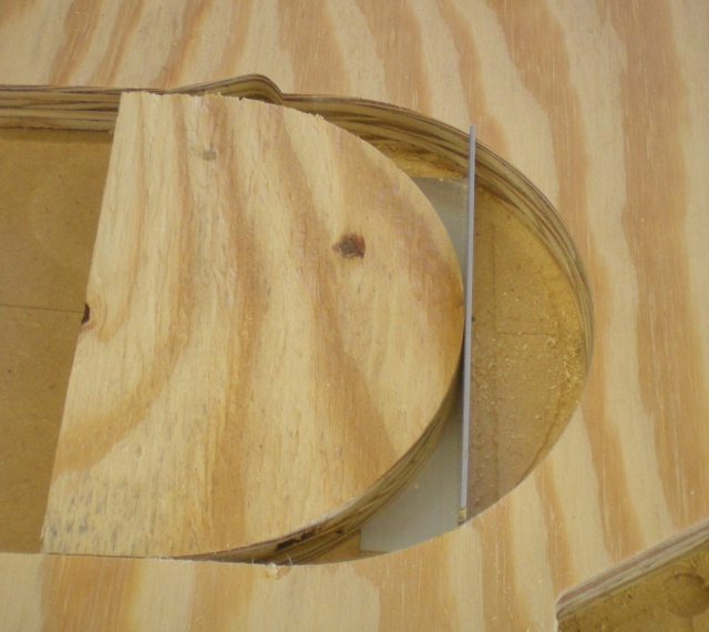

Re: CNC Build -- Hatch 3.1 Corner block hammered

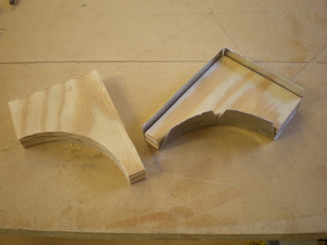

Postby capnTelescope » Thu Mar 20, 2014 6:19 pm

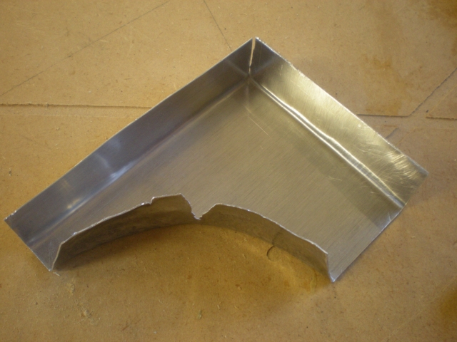

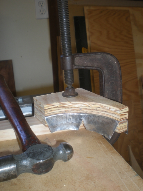

Following KC's link to pounding metal, I SWAG-ed out a buck for my corner gutter blocks (gutter corner blocks?). Ran down to the Blue Box this time, and came home the proud owner of a small piece of 26ga soft aluminum sheet. Cut the bucks on the CNC, and made an attempt to cut my chosen sheet shape on the CNC.
I need to find a suitable cutting fluid for aluminum, as the cutting edge of the router bit got gunked up with a glob of Al. Also, the cutting conditions weren't right. I think I need to keep the rpms low and get the feedrate up to encourage good chip formation. Light depth of cut, too. I'll eventually get this right, as I will be cutting stiffeners for my hatch ribs from Al. Maybe use the 1/8" bit, to keep the surface feet per minute low.

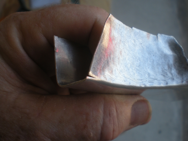

Then I proceeded to beat the heck out of my new aluminum.
This turned out about as I expected, with a tear in the middle of the 3" radius. Since I expected it, I shed no tear for the tear. :roll: Actually, I was quite pleased with the result. Not bad for a beginner, I thought.
Here it is:
The setup:
Another small crack:
Into the Hatch Lab. It goes here:
The top end is too wide to fit through Hatch Spar 3.1, but 3.2 will be better.
And it fits well in the side gutter!

I also picked up a strip of 1/16" flat bar that could be epoxied in the radius, so no scrap part yet.
