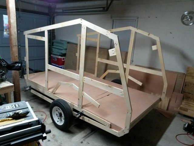

Postby absolutsnwbrdr » Sun Mar 23, 2014 7:56 pm
Things are starting to take shape! :twisted:
Wandered back into the garage this evening and started assembly of the side walls. They got arranged to form the profile, and finally glued and screwed together. Only did one side tonight, but so far so good!
Clamped it into position to get an idea of its size...
Need to pick up a couple more sheets of insulation this week.

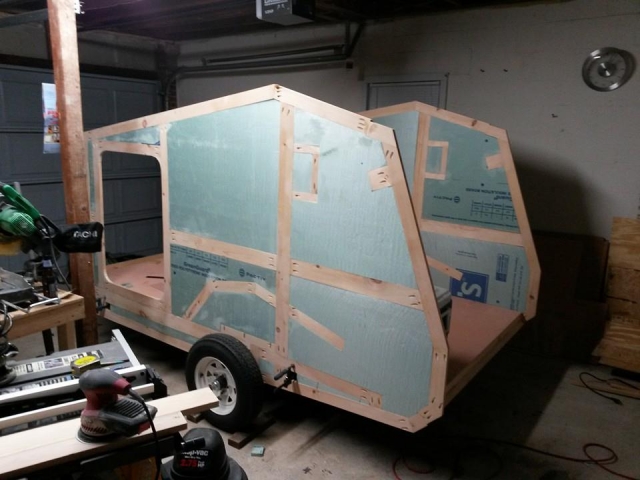

Postby absolutsnwbrdr » Tue Mar 25, 2014 9:22 pm
Little more progress tonight. Finished the mounting spots for what will be my oversized fenders, and also the mounting points for galley hatch gas struts. Having only 12" wheels right now makes the fender locations look a lot more ridiculous than they will when I'm done. :lol:
Also clamped both sdes in place to check out the alignment for the galley hatch bottom seal. The sides will get their 3/16" inside skins before they actually get attached to the trailer.
Things are still aligning pretty damn well! :twisted:
(knocks on wood)

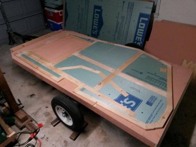

Postby absolutsnwbrdr » Thu Mar 27, 2014 9:10 am
Found myself wandering through Home Depot last night. While I was there I decided to grab some insulation. Picked up some their 3/4" Owens-Corning PINK Foamular. Got them home and they were anything but 3/4". There were some areas in the middle of the panel that maybe one could consider 3/4" if you were blind or didn't know how to use a ruler. The edges were a barely a hair over 9/16". :? :x
Immediately drove back to Home Depot, got my money back, and drove up the street to Lowes. Their sea-foam green 3/4" insulation sheets were right on the money. And a few cents cheaper.
Got home, laid a sheet of insulation on the trailer, and then placed my wall frame on top. Marked my cuts with a utility blade, then stood the wall panel up so I could cut on my marks. One piece at a time, things started to come together!
All the pieces are pressure-fit into place, so they aren't going anywhere.
