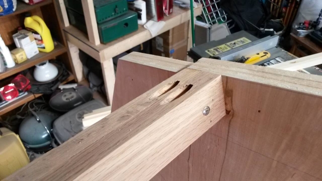

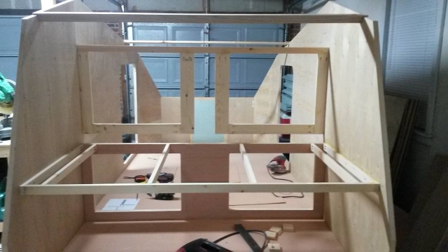

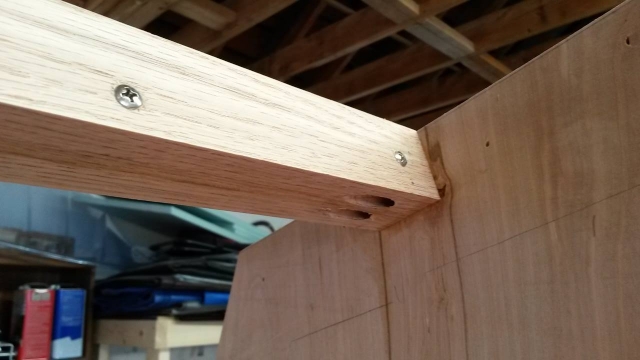

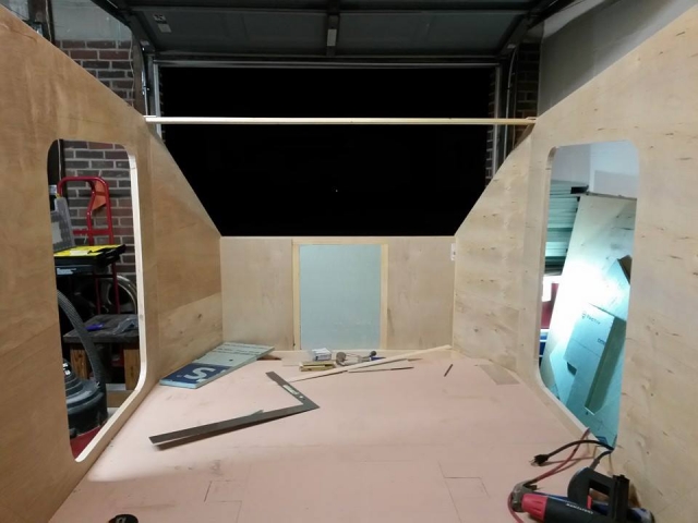

Figured it was time to tie the sides together towards the top so I made my hinge spar. I like a little extra strength in this area, so I got two 1x3 oak boards, ripped them both down to 2" wide and then laminated them together. Then I pocket-screwed each end with 4 screws (2 top, 2 bottom).
View from inside the galley, looking up and back towards the hinge spar....
Top view, looking back....

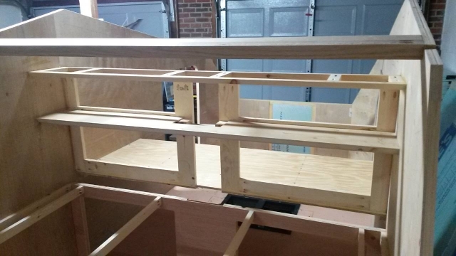

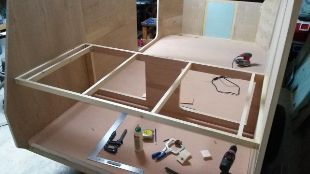

Then worked a little on the galley counter and the upper bulkhead...

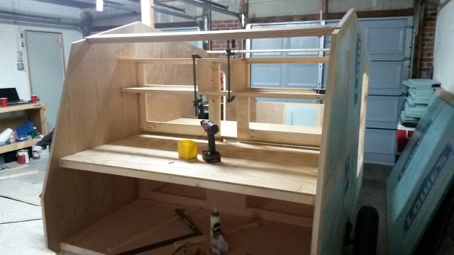

Worked on some more framing for the upper galley last night. The entire counter space will most likely remain open, but I'll make dividers similar to what I had in the X-II. Then there will be shelves on each side of a stereo enclosure that will be in the center.

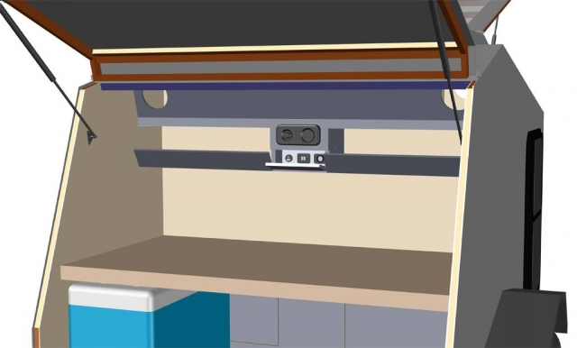

Conceptual model.... (colors not representative of finished camper)
Just below the stereo is a little compartment where I'll mount the two auxillary inputs (USB & 3.5mm jack), and a pair of powered USB ports and a 12V outlet for charging any electronics.
Need to go pick up a couple sheets of 1/2" plywood this evening so I can finish the galley and interior shelves.

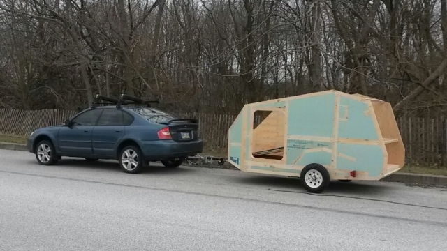

Since I don't have another trailer that I can use to haul 4x8 sheets, I guess I'll be taking this one. Just need to hook up the temporary lights again.

I went home quick on my lunch break... bolted the tail lights to the sides and then zipped over to Lowes :FNP
Two sheets of 1/2" ply and another sheet of 3/4" insulation....
Other than the tiny wheels, I think its looking pretty good behind the Outback!
Had a cop follow me for a couple blocks and passed another sitting in a parking lot. Neither seemed to care that I didnt have a license plate or fenders, and only had half of the required lighting. 8)
