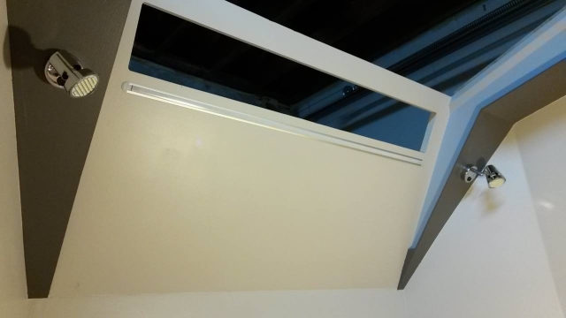

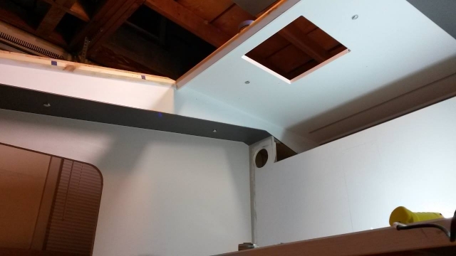

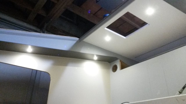

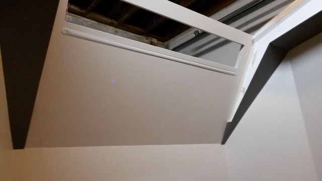

Got another color in the cabin tonight, installed the 6 small warm white LED pods (2 on each trolley top ceiling section, and one on each side of the fan) and got the RGB strips installed in their recessed aluminum housings.
The RGB strip below the front window....
Should be able to get the last color in the cabin tomorrow night, work on the wiring for the roof-top solar panel, and then maybe get the roof top skin attached. Wishful thinking! :twisted:

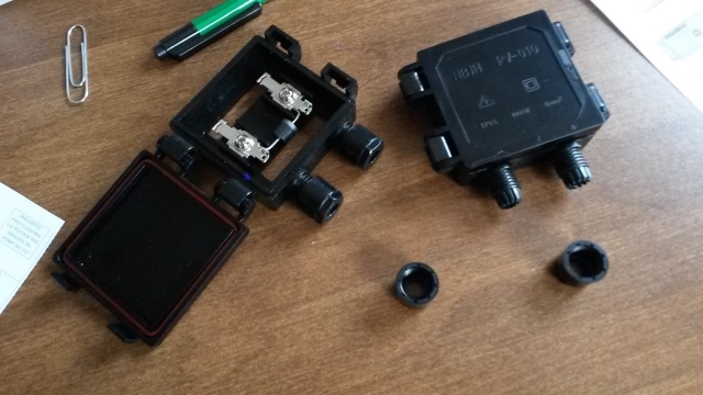

After thinking a lot about how I was going to get my solar panel wires through the roof and hatch skins to the charge controller, I decided to KISS and use PV panel junction boxes. If you aren't familiar with solar panels, these boxes are normally used on the back of the solar panels, where the lead wires from the actual solar cells are tied into the heavy gauge solar panel wiring. They have diodes in them to protect the solar cells from back-current from the batteries. Since my solar panels already have similar boxes with diodes, I'll just remove these diodes and mount these over holes that will be drilled in the exterior skin. A couple screws and some adhesive caulk will do the trick. I saw some people used actual deck grommets made for boats, but they were relatively expensive for what you get. These little junction boxes were only $5 each. They'll hardly be noticeable because they'll be underneath the solar panels.

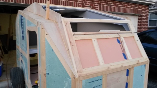

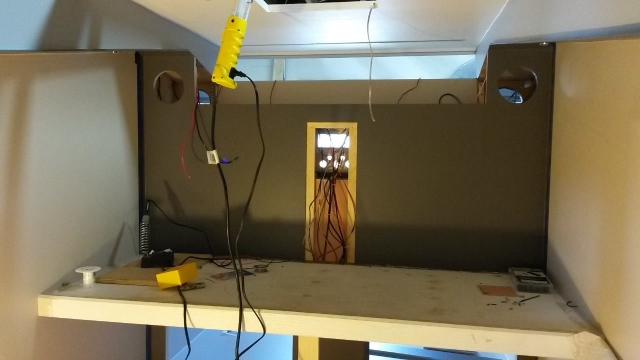

Got a lot done the past few days! A ton of wiring is done, although the power center isn't installed yet. For now, all the LEDs are just being tested with a temp lead wire. The wires to the roof-top solar panel have been run, and the one section of roof skin is installed. Also got my Maine license plate and registration! And as of this afternoon, the entire roof is read for skinning.

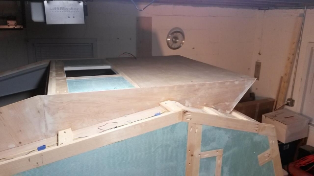

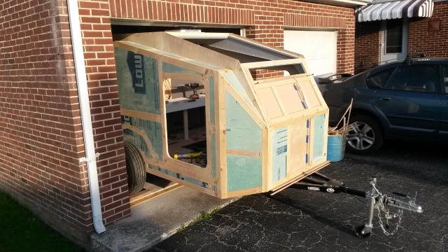

Great news tonight! Now that the roof is skinned, I could set the fan on top and actually try to get it out of the garage.... and it fit!!
Ok, so its a bit tight, but that weatherstrip is pretty flexible and won't cause any problems. And theres still quite a bit of weight to be added to the trailer.
After I puttied all the nail holes on the roof, I cut the narrow roof panels and got all but one installed before I called it a night.
Still have the front and side skins to cut, but its getting closer and closer to being ready for paint!
