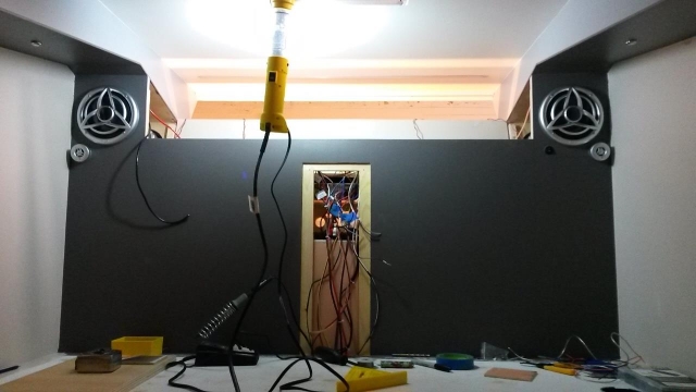

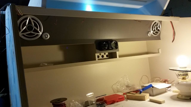

Stereo and speakers are installed. Still need to run the main power and ground wires to the stereo, but otherwise its ready to rock. Stuck with the same marine head unit I used in the X-II (Sony CDXH910UI w/ ipod controls, waterproof face, wired and IR remotes) but this time I upgraded the speakers to Kicker component marine speakers, inside and out. They do have really nice sound to them, but I think I'd still like a little extra on the low-end. The little panel below the head unit that resembles swiss-cheese will be the location for all the 12VDC & USB power outlets, the 3.5mm and USB stereo aux inputs, and the switches to control the mood lighting in the galley.
You can see a small black switch just below the right speaker... its a DPST switch, which allows me to easily mute the cabin speakers. There is another switch in the galley that can shut them off independently as well. The same could have been achieved using the buttons and settings of the head unit, but this is much easier and faster.

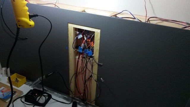

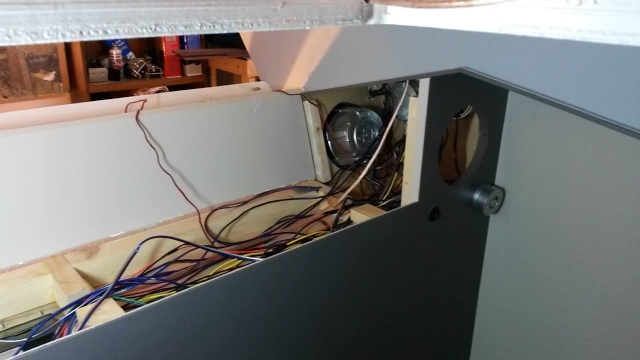

The main wiring chase and tray.... Yes, it looks like a mess, but all the wires are color-coded to specific items. Still a lot more LED wiring to be done here.

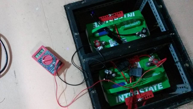

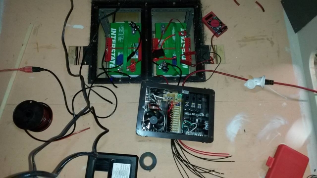

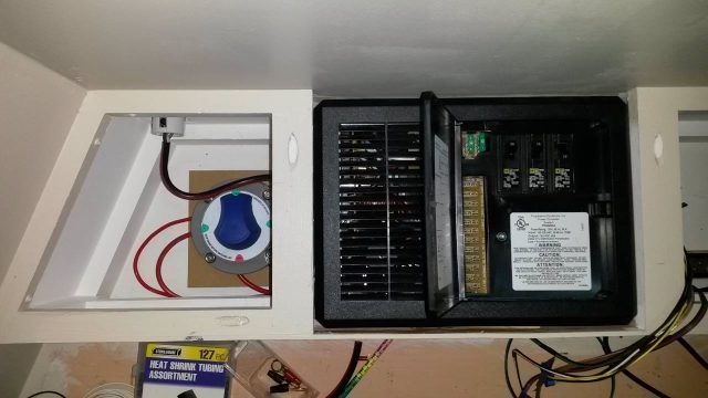

And I started getting the PD4045 sorted out. Just testing the breakers and charger here....

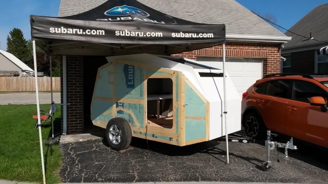

We grew up and went to college together. He helped out with the X-II, and we built he and his wife a teardrop last winter. Once again, he's been a big help getting the X-Cubed as far along as it is. A second pair of competent hands definitely makes things go faster.
He stopped over last night to lend a hand. We managed to run the rest of the wires and get the PD4045 wired up and installed. The two batteries are wired to a switch that I've had laying around since the last build, and thats hooked into the PD4045. Put some fuses in the battery leads and got some juice flowing into them from the PD4045.
Then his wife let him come over again this morning. :FNP
We got the front two skins installed and caulked the trolley-top side wall joints.

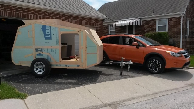

Then we had to take a break so I could go pick up my new tow vehicle!! :twisted: :banana: :dancing:

Might have to add some orange to the X-cubed paint! Nice choice on the subaru.

Good call on removing the bumper for the hitch install rather than drilling holes in the car. I had to wait for my wife to go out of town so I could pull the bumper off her Outback. She would have had a cow If she saw me do it. Nice looking TV. And the 'Cube is coming along nicely as well.

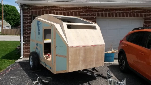

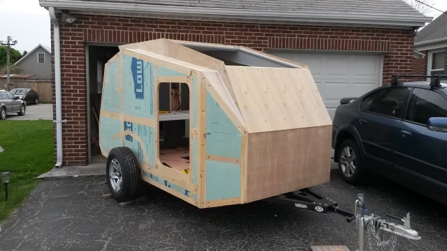

I puttied and sanded the front skins and routed out the front window.
Then it started getting pretty warm in the sun and I wanted to get some primer on the roof and trolley top so I set up my canopy. This was taken towards the end of the afternoon after the shade had shifted from the camper.
I'm amazed at how cool the primered sections were, even when compared to the bare wood. That was my motivation to keep the roof and trolley top primarily white for the final design. They still need the finish coats, but I'd like to get the side skins on first. I think Dan's coming over this week some night to lend a hand with that.

wagondude wrote:Good call on removing the bumper for the hitch install rather than drilling holes in the car. I had to wait for my wife to go out of town so I could pull the bumper off her Outback. She would have had a cow If she saw me do it. Nice looking TV. And the 'Cube is coming along nicely as well.
Thanks! Yeah, it takes a little more time to pull the bumper but it definitely makes for a cleaner install. My parents stopped over in the midst of it and were a little concerned about me ripping apart my new car. :lol: :lol:
My Dad hung around long enough to see everything go back together. Now he's talking about having me install a hitch on his Forester. He doesnt have anything to tow right now though, so I'm hoping he's thinking about getting a small camper to come along on some outings. :twisted:
