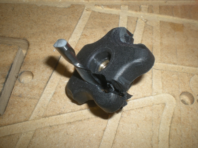

Router Bit Dies in Collision
5/11/14
A popular Bosch downcut router bit was killed today in a collision with a clamping knob. The bit was travelling at a high rate of speed at was thought to be a safe altitude when it collided with the knob. The bit was pronounced dead at the scene. The clamping knob suffered debilitating injuries. It was treated at the scene of the accident and assigned to light duty. This same knob had been in a similar accident earlier this year, and may have contributed to the accident.
Authorities are investigating the cause of the accident. Sources close to the investigation said alcohol was not involved, but they suspect the knob is jinxed. :roll:
Another one bites the dust. :shock:

5/11
Here's the real scoop on what happened:

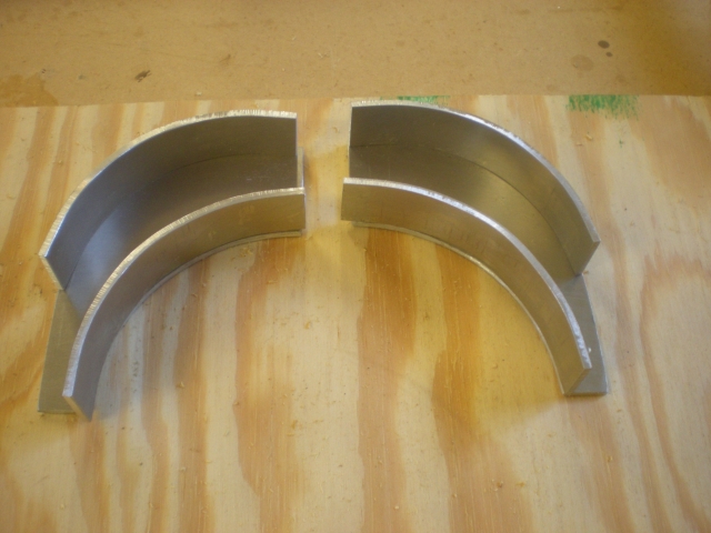

You may remember this early attempt at a corner piece for the hatch rain gutter:
Now that I have an ample supply of 1/8 aluminum sheet and some experience in cutting it on the CNC, I wanted to build up a corner piece with some nice radius bends. Simple plan: cut out a base and side pieces, bend the radius, epoxy/weld/staple together, done.

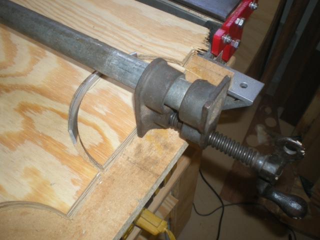

To make the bend, I built this setup:
The tool collision happened while building the plywood bending dies. Bad clamp placement, period. :cry: (Keep in mind the new meaning of "period" in this context.) :roll:
The result looks pretty good to me:
Stay tuned, there's more! :beer:

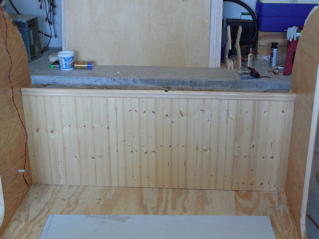

Speaking of pictures from the new camera, here's the front bulkhead/headboard that I got around to. It's HD 1/2" Sande-ply with knotty pine wainscoting applied. Thanks to OldRagBaggers for the idea.
It creates a space at the front for wiring, air conditioner ducting, and whatever else.

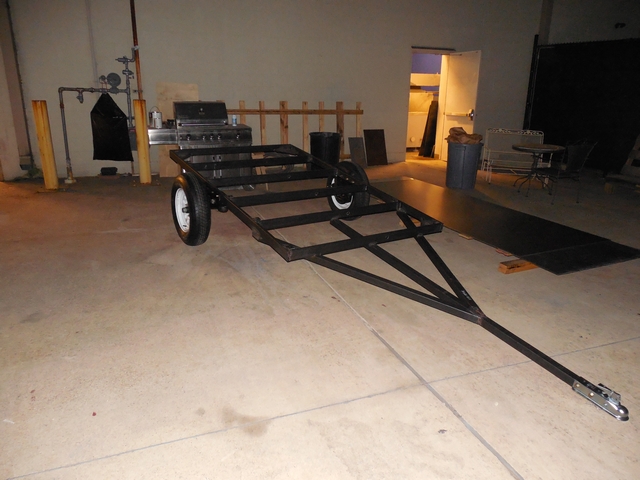

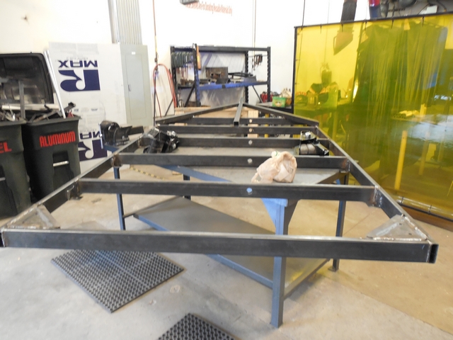

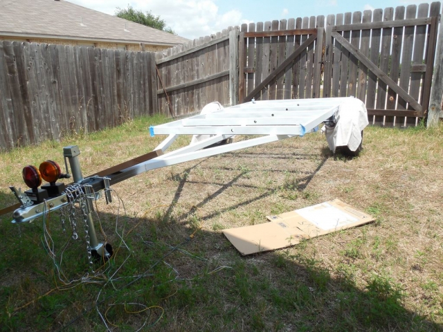

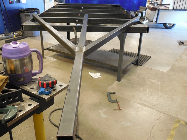

Saving the best for last, I devoted some of last week and Monday-Tuesday this week to construction of the trailer chassis. I took a few cues from everyone here, and things went relatively smoothly. Couldn't have done it without TnTTT-ers and Techshop's equipment.

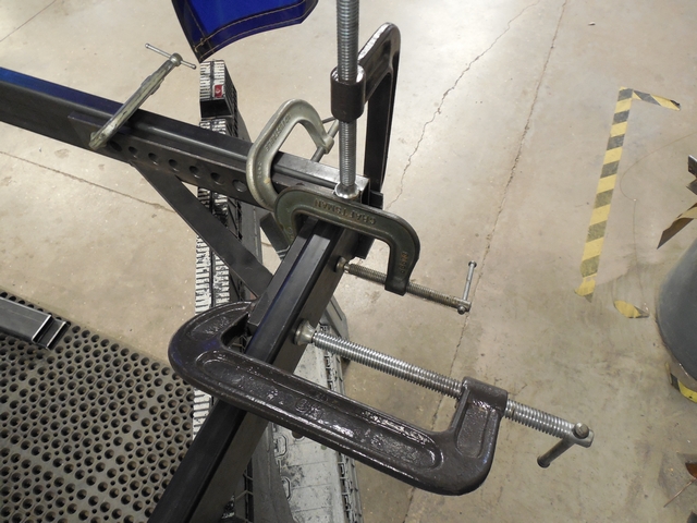

Fit, clamp, tack, repeat, weld, weld, weld, repeat. First tack up:
I spent far more time fitting and clamping than I did welding. Each set of pieces presented a new clamping challenge. By the time I got it down for a part, the part would run out and on to the next clamping challenge.
It took 4 repositions: bottom side up, down, up again, and finally down on its own 2 feet. The first one was me by my lonesome (one piece at a time), second was a two-man job, and 3 & 4 took four of us. The first two included all the welding. The third position was mounting the suspension, brakes, tires, all the bolt-on stuff. The fourth to get the frame off the workbench, onto the floor and turn the chassis right side up. This puppy weighs around 4 hundred pounds.
Bottom side done:
Standing on its own two feet:

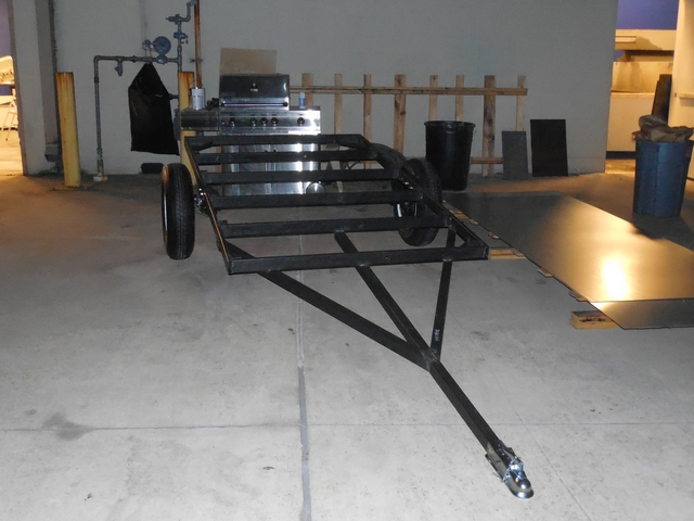

The tongue is most likely over long. Once I build the tongue box, add a spare tire and see how the tongue jack fits in, I'll probably hack a chunk off later.

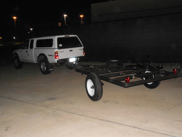

Hooked up and ready to go home:
This is about 11PM. A long day.
Besides everything else to do, the tires need balancing. If it got much over 40, it started bouncing and shaking the truck. I was too tired to drive any faster.

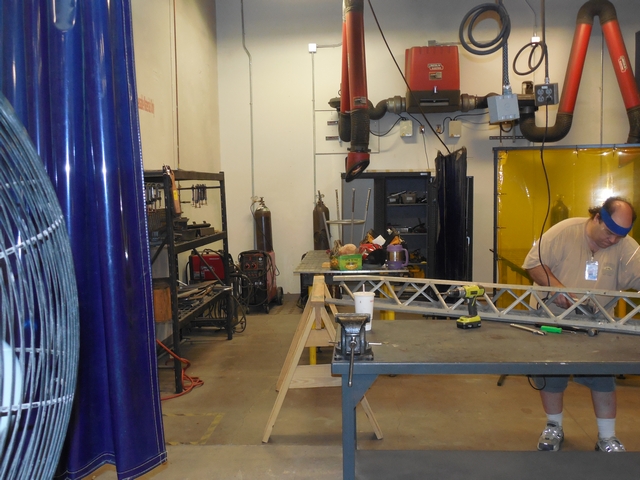

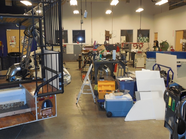

Here's a couple of shots of the TechShop metal shop:
I wasn't off that workbench for ten minutes and it's already busy.

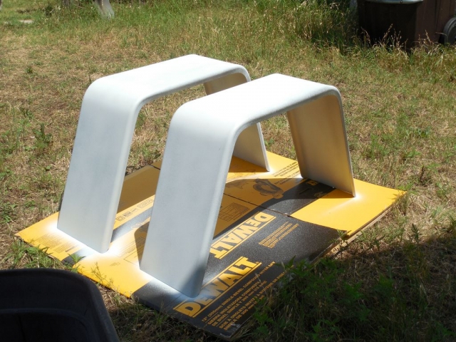

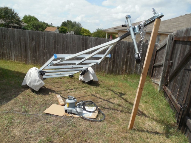

So now that I have a trailer frame, I'm all excited to actually assemble this thing. Then I said to myself, "Self, you better paint it first. and there's that little matter of some welding left to do. I didn't feel like welding today, but I did feel like painting before rust starts setting in. So I went to the garage and drug out the Earlex, which I haven't used since the last time I used it. About 4-5 years ago. Fortunately I did a pretty good job of cleaning it up then, so it still worked. Just to make sure, I filled the cup with paint thinner and used it to clean the oils off the steel. Then off to HoDePo to get me some of them Rustoleum goodies. There was the good ol' red oxide primer, which recommended itself for badly rusted stuff, which my frame isn't. Then there was this white primer, which said it was good for clean unrusty metal. I was not aware of this product's existence. What the heck? Got it anyway.
Masked off a few spots, like where I need to weld later, and got with it. Before long, it looked like this:
I got my fenders out and did them too:
I wasn't real happy with the job on the underside of the frame. I didn't want to lay down on the ground and spray upward. And I didn't want to tempt fate and maybe lie down in a bunch of fire ants. So I propped up the front end so I could get partly under with out laying flat. Everything went fine, even though it looked like I was being a danger to myself and others.
I think I'll go get the welding finished tomorrow. It's a hitch receiver for bike racks, etc., and some mounting lugs for fenders.

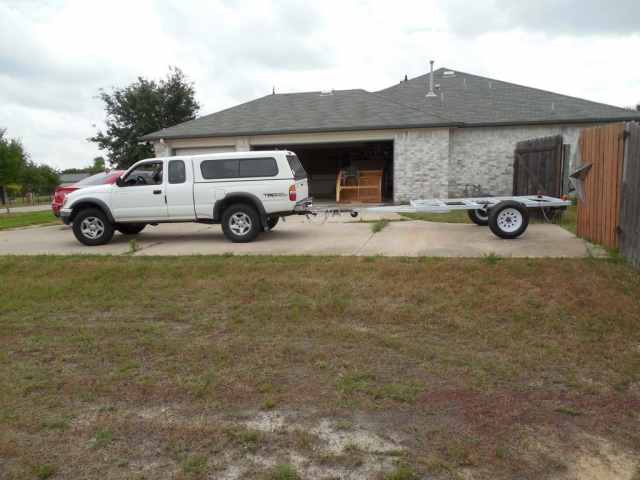

While I was hooking up the trailer to take it over there, I had the opportunity to see things from the side:
I've been stressing all along that the trailer wouldn't be tall enough for the TV. My Tacoma TRD has more ground clearance than most, and it's 20" from ground to the top of the ball. I had this vision of needing a drop hitch with a lonnnng drop. As it turns out, I've got the opposite problem. The front is low when hooked up. As it sits, the tongue jack just reached the ground, and the Atwood levelers in back come up short, so things won't get level. I know the tires are over inflated, and there's some weight to be added in the back, but I might have to go from 15" to 14" wheels. $> I can turn the ball over on the hitch and get 2-1/2" of up at the front. That's free, and will probably get the trailer level when hooked up. :fb
Anybody got any bright ideas on this one? Has anyone "extended" the Atwood leveler jacks?
