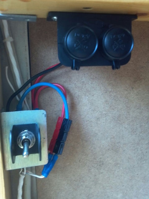

The AC install is complete, and the trailer lights have been rewired.
I replaced all the previously installed 115 wiring, and added 12V DC wiring.
The 12v powers a LED light and the fan as well as two 12V "accessory " plugs (for cell phones and such )
123411
The DC has 3 possible power sources, the toggle switch is for 1 and 2 below.
1. When the TD is plugged in 115, a robust 12v laptop power supply is hard wired in.
2. When hooked to a tow vehicle, it's tapped into the trailer wiring.
3. When boondocking, a battery can be connected.
123410
