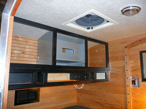

I've definitely got some kind of ground loop thing going on with the skin. I put the meter on it, and got 12V skin to ground with lights off; 0V lights on. Still looking.

I've definitely got some kind of ground loop thing going on with the skin. I put the meter on it, and got 12V skin to ground with lights off; 0V lights on. Still looking."

Power wire touching skin. 0V when better ground present.
look for staple or nail,screw through wiring! Start with
which switch gives 0 volts and work backward.

pchast wrote:Power wire touching skin.
On further investigation, if I jumper the skin to wiring ground, the light goes on. This confirms my theory that the porch light's internally grounded base is connecting to the skin. :thinking: Or Tony is right and the trailer is haunted. :frightened:
Rewiring the porch/dome lights to switched positive from switched ground should do the trick. All I have to do :roll: is swap a few wires around on my wiring panel. PITA.
... and bring in an exorcist.
Which wires? :? My head hurts.
Maybe some of my running lights are self grounded, too. That would do the trick for porch lights coming on while hooked up. Or ...
pchast wrote:staple or nail,screw through wiring!
That isn't totally out of the realm of possibility, just harder to find.

It's good to see that you've chased down you're wiring issue. My side clearance lights were self-grounded. Fortunately, I was able to isolate the grounds.

I probably should have said that the switches are in the cabinet located over the lower leg space. Here's a better pic:
Overall, the cabin depth is 80" (bottom of angled headboard cabinets at front of teardrop to bulkhead wall). The distance from the headboard cabinet to the front of the cabinet with the switches is 54". Laying down, I can reach the switches.

I'm now a happy camper. I'm now switched positive on dome and porch lights. Either switch closest to the door works the dome light, and either switch #2 works both porch lights. And I didn't have to remove a light fixture or wall switch. :D Or cuss very much. :thumbsup:
The only thing I don't like is that the black wires going to the wall switches are now positive, which kinda messes up my color code convention of black = ground. I'm not going to lose any sleep over that.
