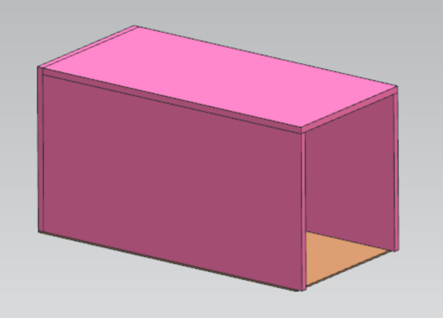

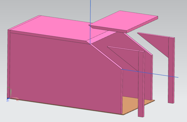

Just for fun, you can get to this point by making only 1 cut. The back piece... But notice your panels are overhanging the front of the plywood by 2 inches... In other words, now you are forced to start cutting. :shock:
Re: Latest on foamies
Postby mikeschn » Sat Jul 11, 2015 3:33 am

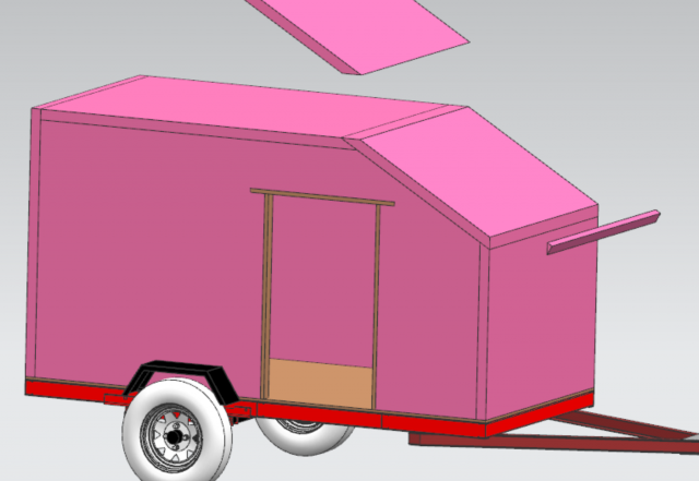

Then I would cut 4" off the front, which leaves 2" of the plywood floor showing.
Then I would cut the angle. In this case I drew a line 15" down and 26" to the left. I used those endpoints to create my line for cutting.

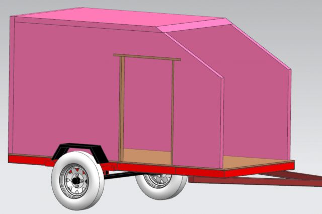

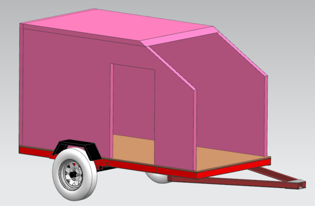

at this point I would get the trailer and assemble it. I would move the axle back 12" from the original location. Otherwise the wheel is going to be in the way of your door.
Then set your foamie on your trailer and bolt it down. Note: Even though I show the body bolted down at this point, it's easier to cut the angles and the door on the work bench before assembling.

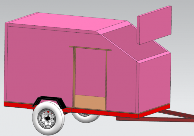

And then I would cut the opening for the door. 24 x 39, 21 inches from the front of the foam, or 23" from the front of the plywood

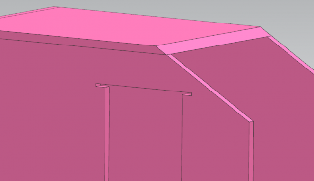

Postby mikeschn » Sat Jul 11, 2015 4:16 am
Cut out two notches 3/4" x 3" at the top of the door. These notches will help prevent stress fractures in the corner.

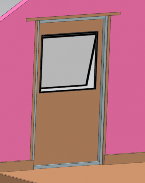

Then frame in the doorway with pine cut to 2" wide.

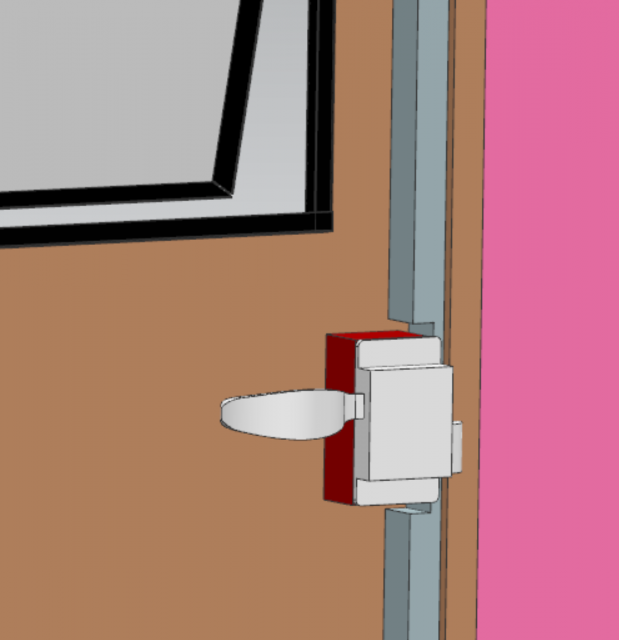

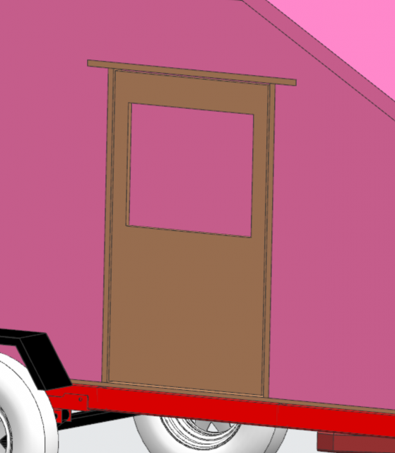

For the door I would probably just do a plywood door, with a hole cut into it for the window.
Frame in the inside of the door frame.
Add a window
add a door knob

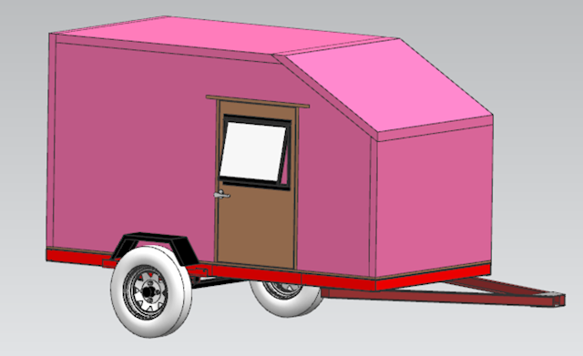

Here's the final result...
Okay, I'm done, where's the canvas guys?

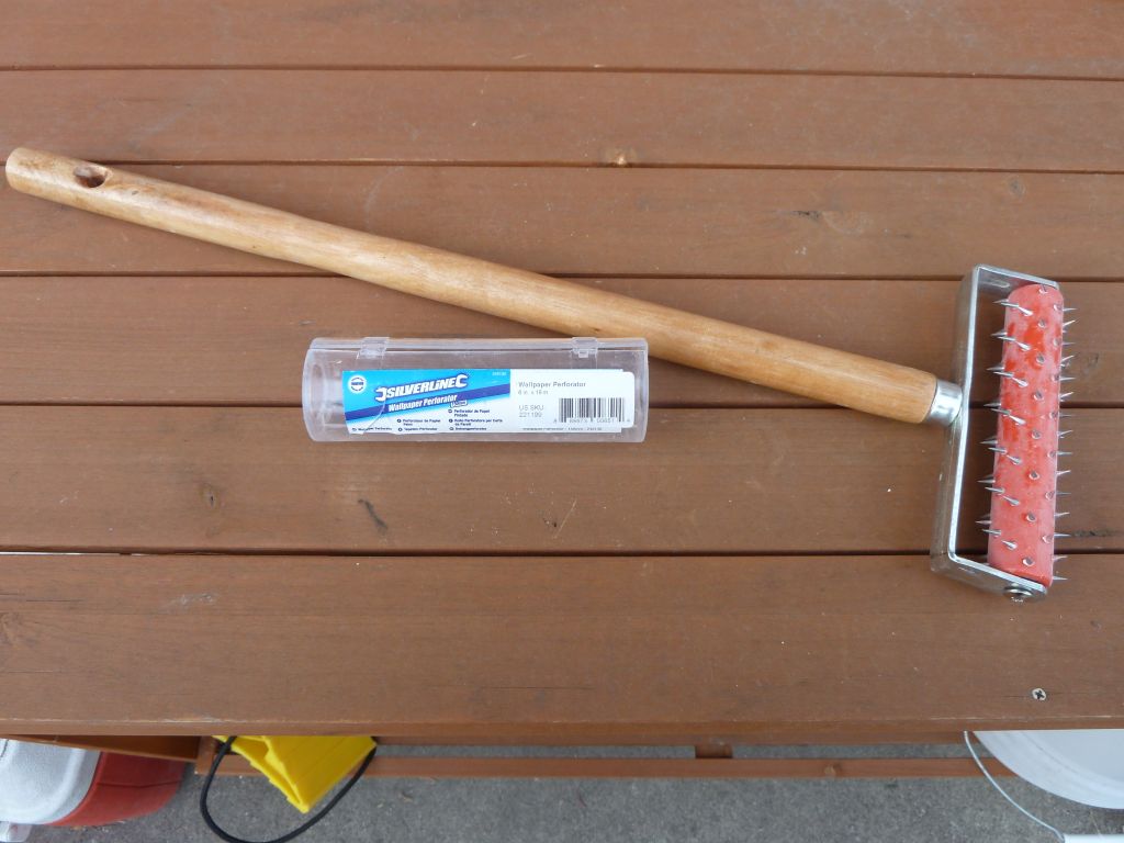

Wallpaper Perforator is useful to prevent bubbles and add some strength to the TB II to canvas bond:

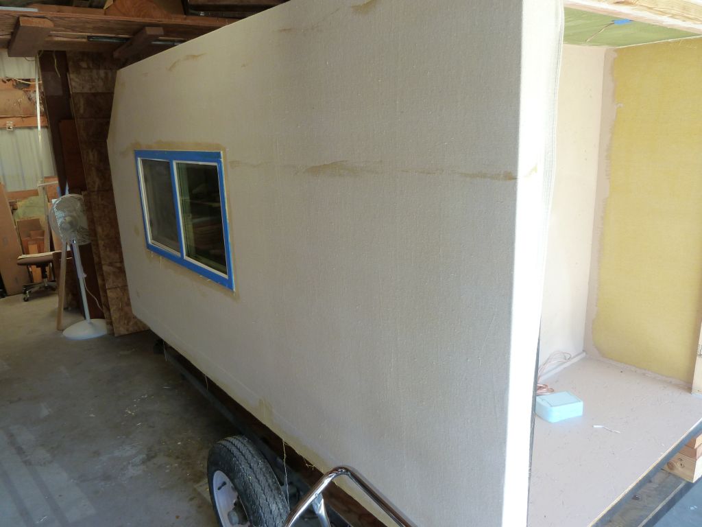

And the main canvas cover over the side:
