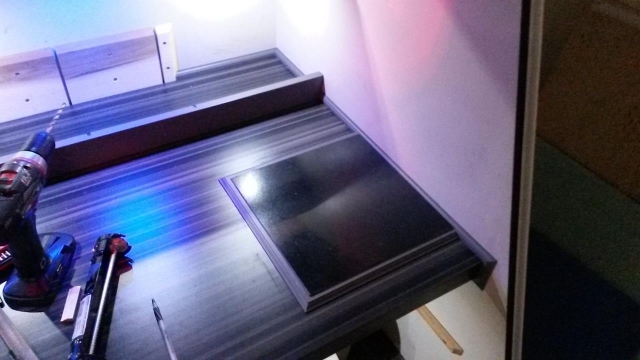

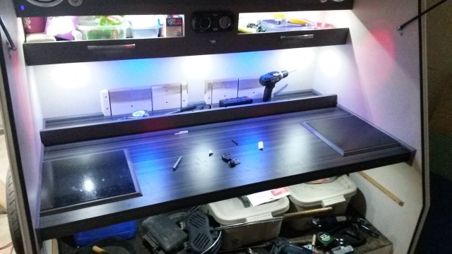

I finished the Galley counter with Formica, with granite trivets...

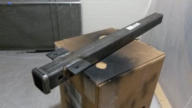

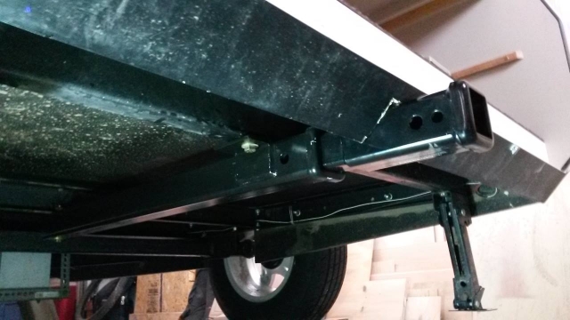

Installed a rear receiver hitch...

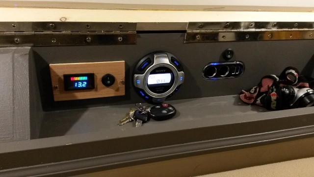

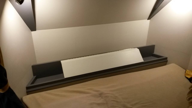

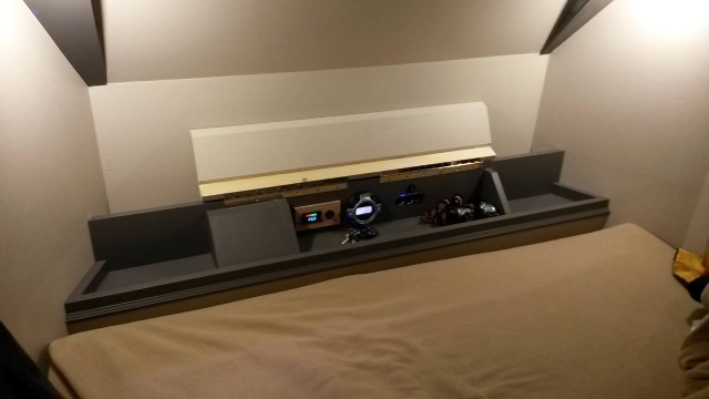

Finished the headboard/electrical compartment cover....

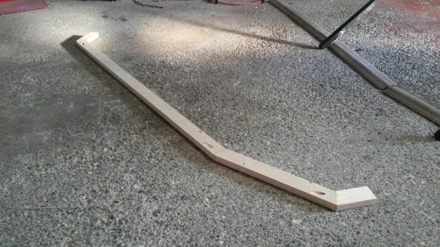

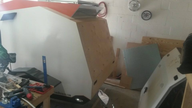

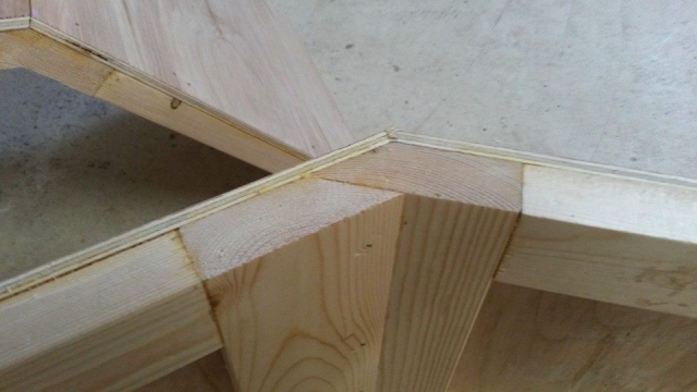

Built fenders....

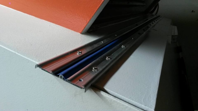

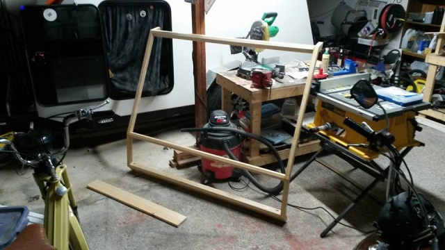

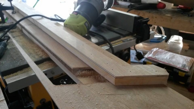

And replaced the hatch. I made the same frame rails as before, but laminated 3/16" luaun on each face of the frame rails. MUCH MUCH stronger! I also replaced the hurricane hinge with a SS piano hinge and some aluminum trim. The hurricane hinge was destroyed while trying to remove it from the old hatch.

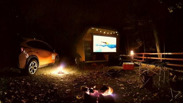

S. Heisley wrote:PS. That movie screen is a terrific idea for treardrop gathering entertainment!
That picture was taken at a TearJerkers gathering at Knoebels Amusement Resort in Central PA. I got there the night before everyone, so I had nearly the entire campground to myself! The following night we were watching some old b&w "horror" classics! Great time!

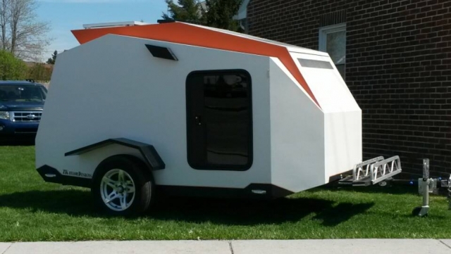

Love the build. I have a question, all you did was paint the outside, no other skin?

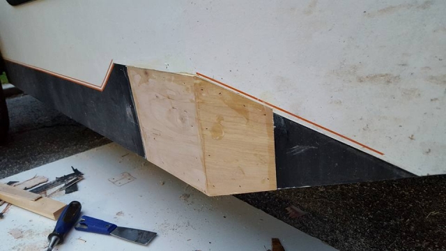

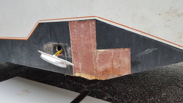

Thanks! Yes, it was primed with a couple coats of Kilz Premium, and top-coated with a couple coats of Valspar Anti-Rust Armor (same thing as Rustoleum High Performance Enamels, but can be tinted to any color.) I made sure all corners were sanded smooth so the paint would resist peeling from sharp edges.
Yes, it will need re-painted every few years, depending on how its stored. This one is garage kept, but used quite often. Paint is still as good as the day it went on. I don't expect I'll have to repaint it anytime in the next few years. :thumbsup:

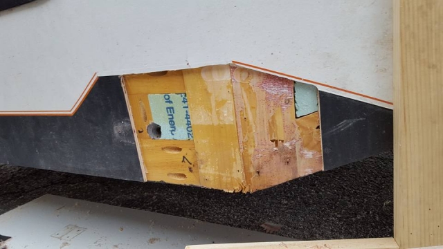

A nice thing is that if it incurs any damage, its easy to fix! I had an incident when I went to a friends cabin for the weekend. Backed into my spot and because of the terrain, I dragged the front right corner on a large flat rock. Trimmed out the damaged 3/16" skin, replaced it, puttied it, and primed it so far. No finished pictures yet... havent quite had time to finish it. Just bought a house, so I've been a little preoccupied. As soon as I get a day to finish it, I'll post up a couple more pics.

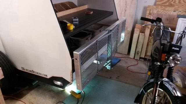

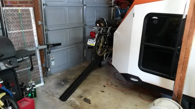

What is your tongue weight with the moped on there?
My wife drives a XV CrossTrek and if I recall correctly, it's maxed at 200#.
Conversely, my Forester XT is maxed at 175#, but same tow capacity of 1500# ... figure that out... lol.
Alan_H
Posts: 245
Joined: Mon Dec 02, 2013 4:44 pm
Re: "The X-Cubed" C.T.T.
Postby absolutsnwbrdr » Tue Mar 08, 2016 2:09 pm
I think the smaller moped is around 95lbs, so tongue weight is probably up around 150lbs with the moped on there. Yeah I was surprised to read the tongue weight for the crosstrek was 200.
