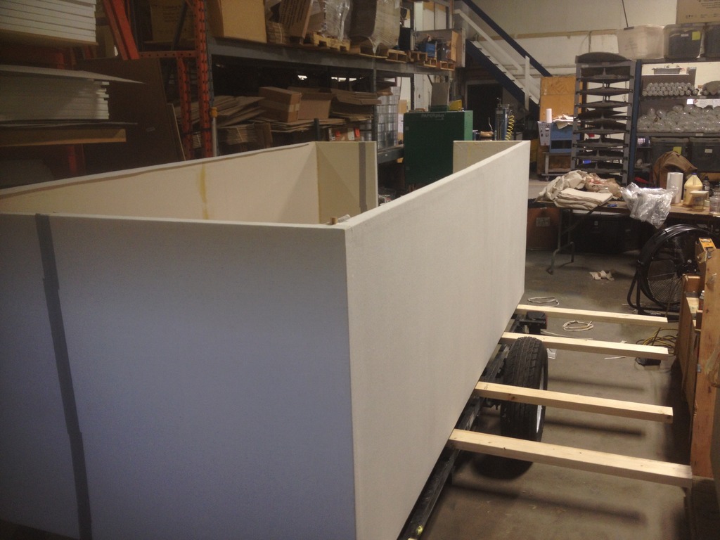

So I quit work early at 4pm on the friday and we started. Got the trailer leveled with jackstands and put the plywood on it and glued and screwed the perimeter 2x2's on with pl premium. Then I started cutting foam and we started on the first wall!
We drilled holes in the foam to fill with pl premium. The first wall we didn't think of doing that on the foam to foam joints for some reason. Also from the front to the upright is 6ft, from the upright to the back is 4ft and on the 6ft length on the front there we had a hard time getting everything together in the working time of the glue. I forgot I needed to push the top down, so its bowed up in the middle about 1/4in. With the rest we secured the top beam level though so the glue couldn't push it up.The top half of my trailer wont be resting on it so its fine.
We were done this first length at 20 past midnight. My wife had had to go get some brackets for the upright 2x2's and had a hard time finding them plus it took a while to set up the tools and level the trailer. I used a router by hand to cut the slots for the 1/4in strips and that wasn't quick either.
We kept going and had these 3 walls done and were ready to leave at 3:45am. Julie got really tired and messed up which way some of the foam went, I forgot to put the 1/4in strip on the end wall and we were just too tired. Its an hour drive home from my work and she couldnt make coherent sentences anymore so I drove us home. I had been planning to sleep at work but I was soaked with sweat and needed a shower. We got to bed at 5am.
We got up at 8:30 Saturday morning, bought some more supplies and were back at it by 11:30am, a lot later than I had hoped. This is the walls with all my clamps off.

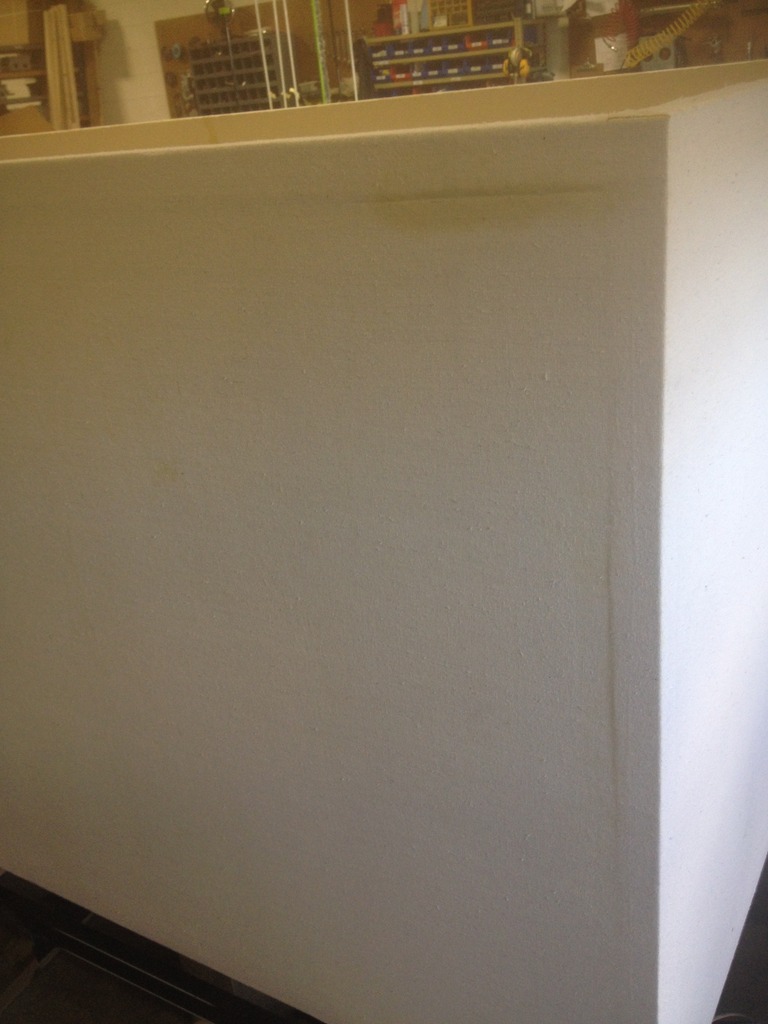

I sanded the foam on the trailer with 120 grit on my orbital air sander trying to get rid of the dents. Julie started filling dents after i sanded with that super light filler on the still super incredibly dented foam... pl prem Didnt sand well with the soft pad on my sander because the glue is a lot harder. Then i cut a strip out of the foam on the rear where I forgot it yesterday and glued in 1/4in wood with gorilla glue. didnt start building second side until 4pm. Sanding took forever.
Tried to keep everything level and square but it wasn't easy. Think I got it though.
We finished the other 2 walls at 9:15pm and braced the one corner because it wanted to bow in.
Then I raced over to home depot and got a can of sprayfoam. We had filled the dents in the foam on the first side with filler but I didnt want to use it in the deeper gaps along seams as it might not dry all the way through. I figured sprayfoam would work great. filled all the seams on the side I already had sanded with it and then filled every gap and dent I could with it on the side we just built where the clamps werent in the way. I smashed it all down with a putty knife like what was suggested on here. This was my second biggest mistake. It was fine on the second side, but on the first side that I had already sanded I had to sand it a lot farther down the next day to get rid of the sprayfoam and took the blue foam down too far. I used pl premium and spacking to fill the rest. I finished at 45 minutes after midnight and then had an hour drive home and had to shower yet... Julie had left around 10:30.
