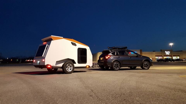

Postby absolutsnwbrdr » Mon May 02, 2016 10:34 am
FInished my repair 2 weeks ago. As good as new!
And traded Clementine in on a 2016 Crosstrek!

Postby KCStudly » Mon May 02, 2016 10:54 am
Looks like the color scheme still works well with the pinstripe tying things in. :thumbsup:
Why the upgrade/trade in? Seems like the 2014 should have just been getting broken in. :thinking:
Re: "The X-Cubed" C.T.T.
Postby absolutsnwbrdr » Mon May 02, 2016 3:28 pm
:lol: Had the dealer put the orange stripe on it. :twisted:
The orange one was just getting broken in, with 32k miles. My local dealer gave me a heck of an offer to trade in for a new one. And the 2016 has a few more bells and whistles compared to the 2014.

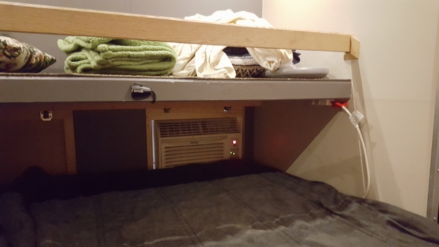

Postby absolutsnwbrdr » Tue Sep 27, 2016 10:14 am
The latest addition to the X-Cubed was a 5000btu A/C unit. The opening was already in the galley bulkhead, so it was just a matter of building a base. This unit is completely removable because I dont need to drag around an air conditioning unit in the spring, fall, and winter months. The condensation drain line is just a length of clear tubing that runs out the galley. Because of how its mounted I do have to leave the galley hatch cracked open for venting purposes.
I used the A/C a few weeks ago at the TearJerkers Liberty Bell Chapter Knoebels Gathering, and I'm sooooo glad I had it! It was sooo hot and humid.

Postby SCwood » Fri Sep 30, 2016 1:13 pm
Nice! Does your drain tube hook up to a fitting on the A/C unit or do you have some sort of drip pan under there?

Postby absolutsnwbrdr » Mon Nov 21, 2016 9:01 am
SCwood wrote:Nice! Does your drain tube hook up to a fitting on the A/C unit or do you have some sort of drip pan under there?
Since it was thrown together at the last minute, there's a drip pan under there. For next year I plan on getting a 1/4" fitting for the bottom of the A/C unit. I took the A/C out a few weeks ago... no need for it in the winter months :lol:

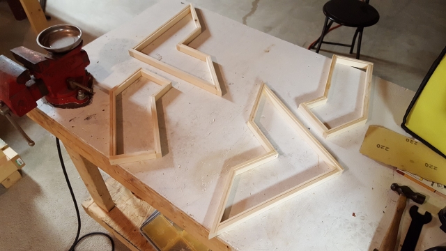

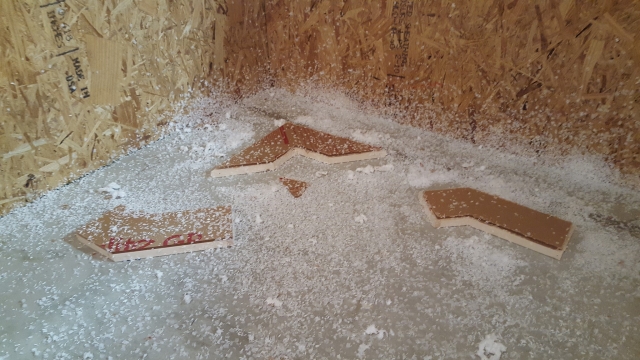

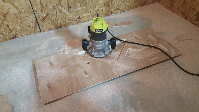

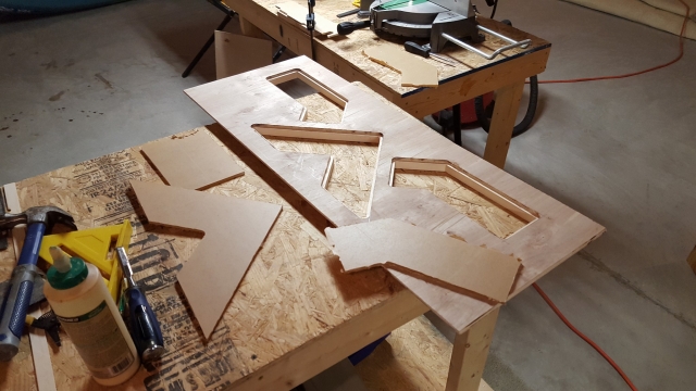

Postby absolutsnwbrdr » Mon Nov 21, 2016 9:30 am

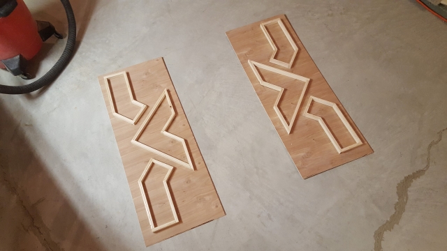

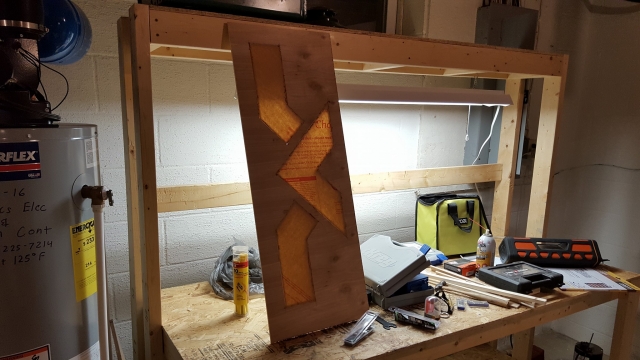

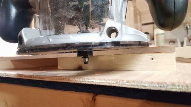

I'm FINALLY getting around to finishing the inside of my galley hatch :? Since I rebuilt it a while ago, I still havent finished skinning the inside.....
Instead of just keeping things simple, I decided to add acrylic panels that will be backlit with RGB LEDs. And of course they couldn't just be simple rectangular panels.... they had to be all angular to match the rest of the design. I've never tried making router inlays before, and I didnt have template guide, so I made 1/2" wide "frames" that would attach to the inside of the hatch skin. Then I used the frames as templates, and used a 1/4" rabbeting bit to trim the acrylic panels and make the cutouts in the luan skins.

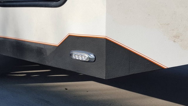

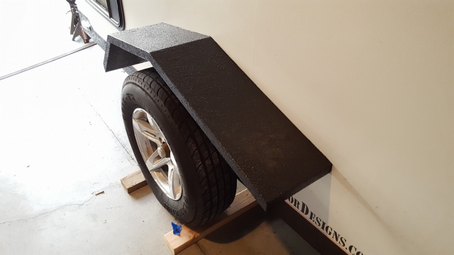

Postby absolutsnwbrdr » Mon Nov 21, 2016 9:51 am

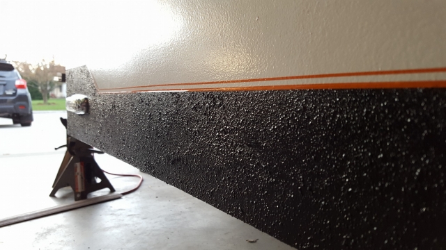

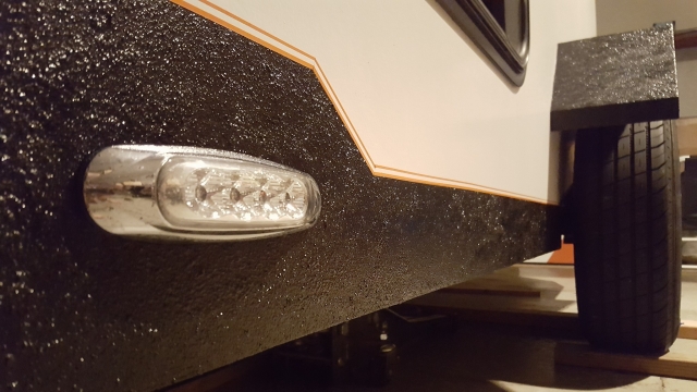

I've also coated all of the black trim & fenders with Herculiner - a roll on bedliner, available at big box stores. I've never used anything of the sort before, so to me the stuff is pretty interesting. Its like a black paint with rubber particles suspended in it. I brushed it all on, being sure to spread out the particulate somewhat evenly. It took a few days to lose its tackiness, but it seems like it will hold up really well!
At $25 a quart, its not cheap.... but I like it. 8)

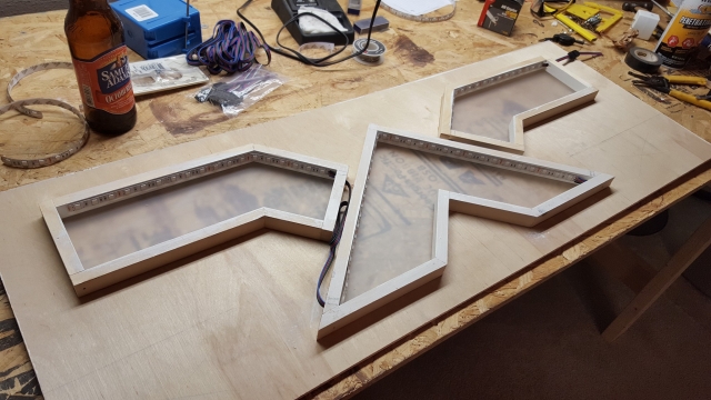

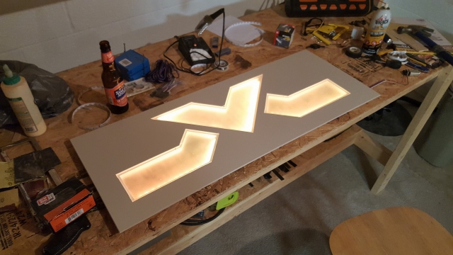

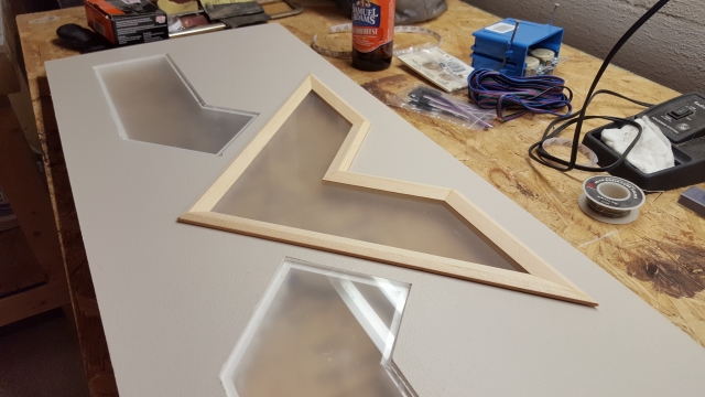

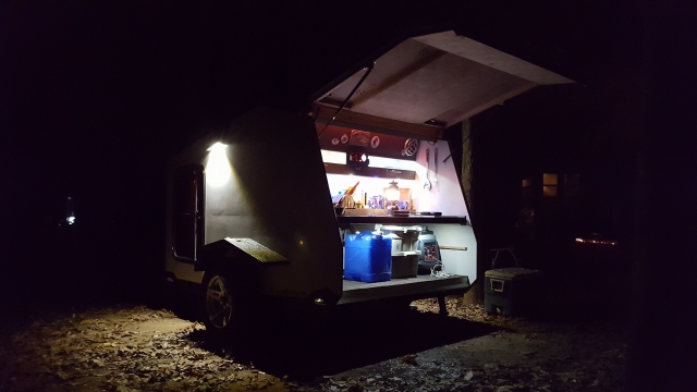

Postby absolutsnwbrdr » Wed Nov 23, 2016 8:54 am

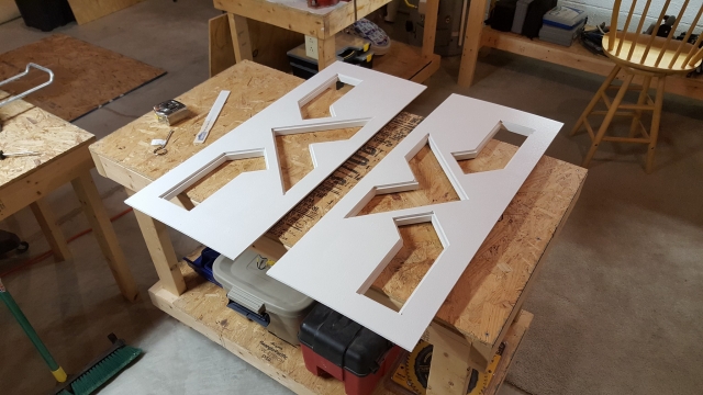

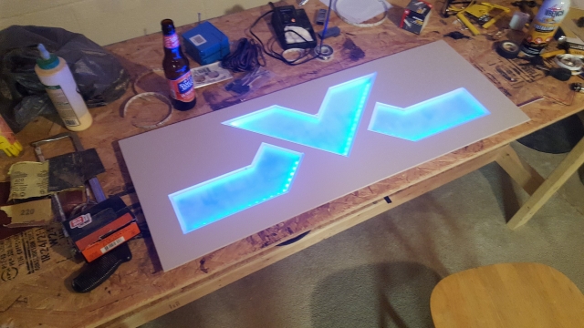

More progress on my illuminated galley hatch panels! These will be on the inside of the hatch, and will provide overhead lighting when the hatch is open. Of course they can change color too :lol:
Primered...
LED strips installed and wired...
Testing them...
And making trim rings...
