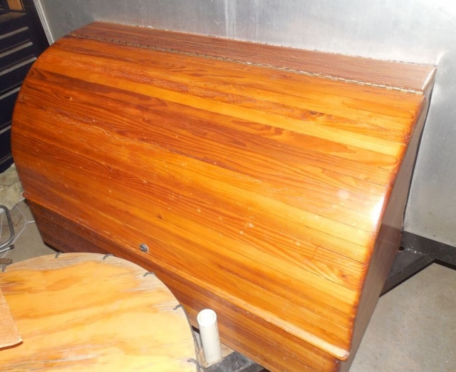

Tongue box
Inspiration from KC Studly's fiberglass-epoxy adventures led to this masterpiece:
