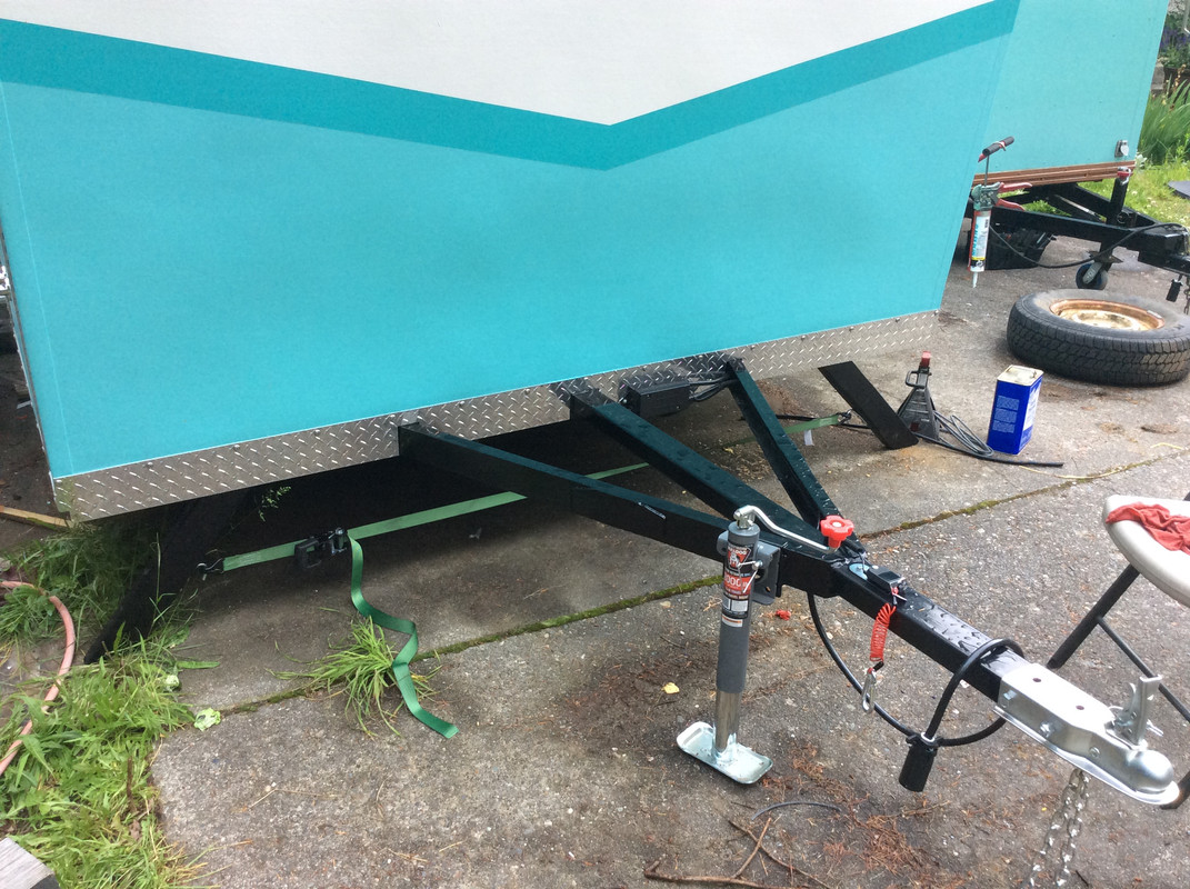

Got the diamond plate fitted and caulked across the front. Still working on the back...

Need to get some more pictures, but since these were taken, I’ve wrapped up the front bird box w/ breakaway switch, new hubs, brakes, etc, plus wheels and tires.

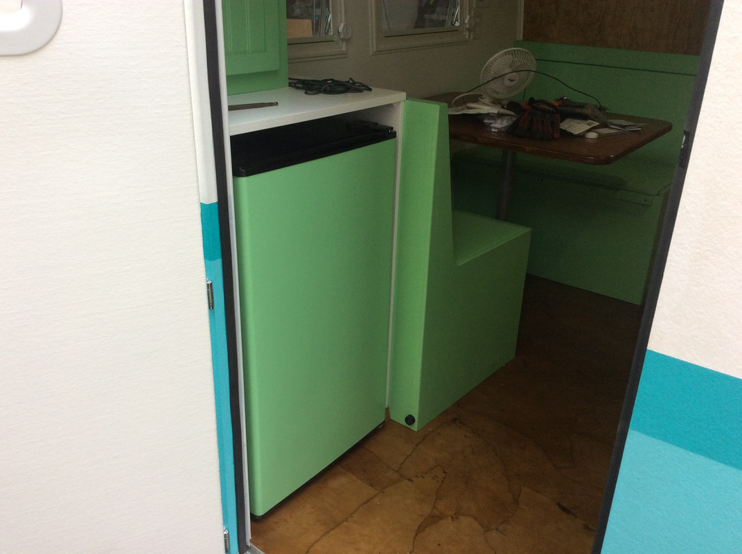

The fridge is painted and installed. When operating on shore power, it runs as normal. When on inverter power, it is connected through a digital controller which reads the temp, and turns the inverter on and off as necessary, not just cycling the compressor. This will keep the inverter from running unnecessarily, conserving battery time.

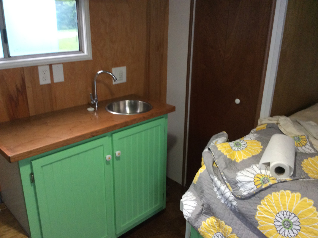

Got the sink and faucet all plumbed and tested. It just draws from pair of 3.5 gal water jugs, one for fresh, one for grey.

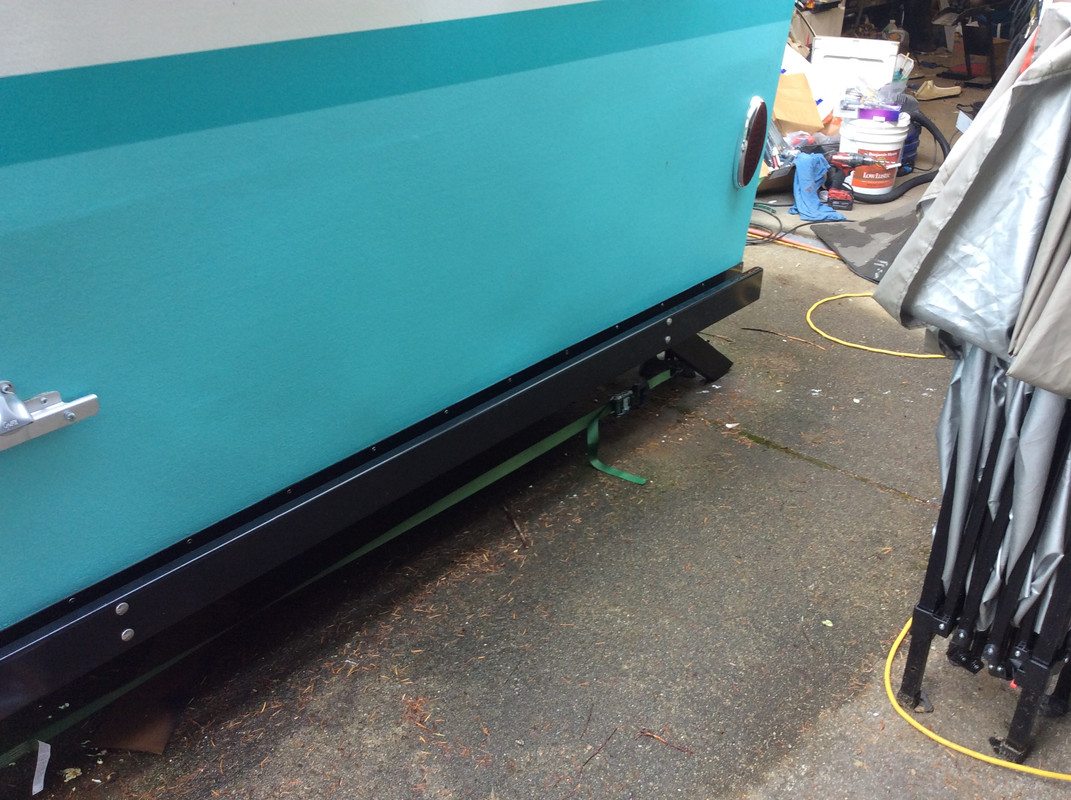

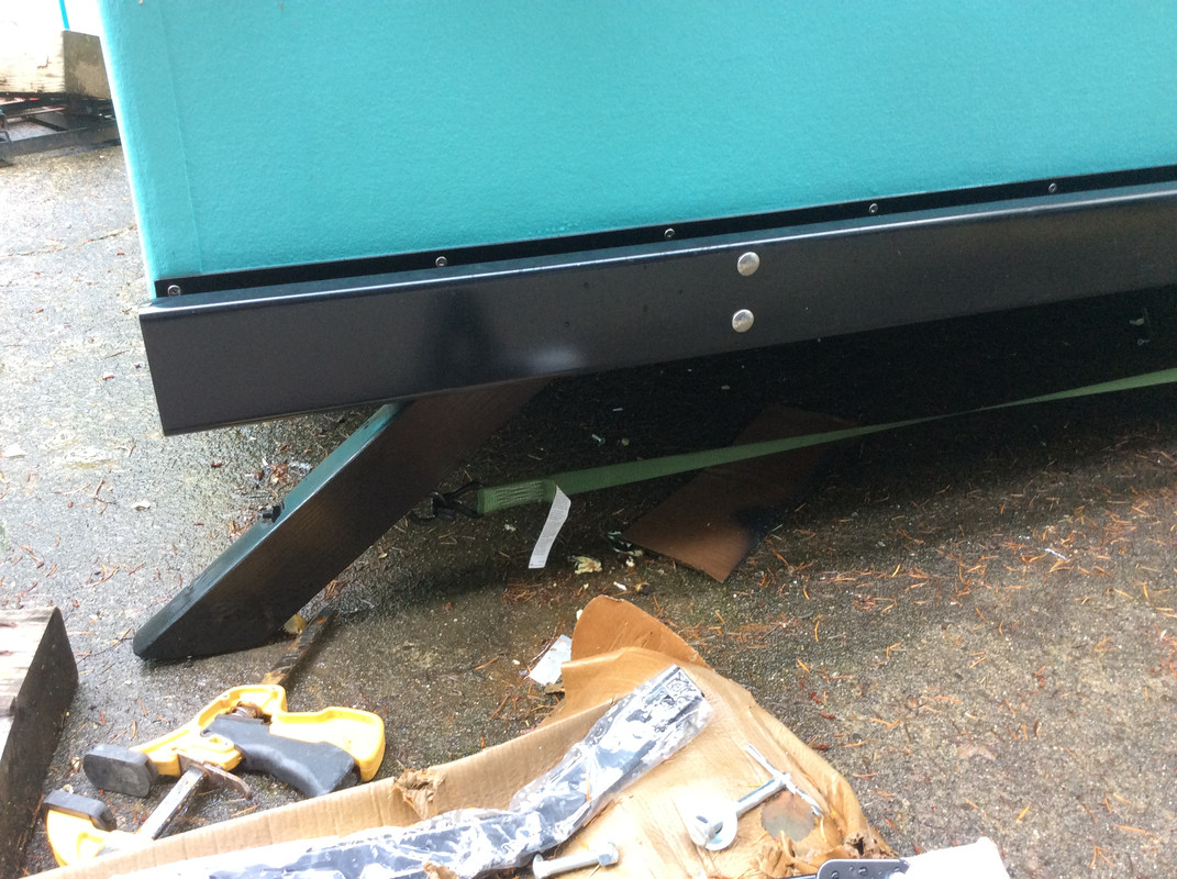

Got the trim fitted and caulked across the front and back, as well as a bumper built for the back end. I also built a pair of 2x4 stabilizers, which work great!

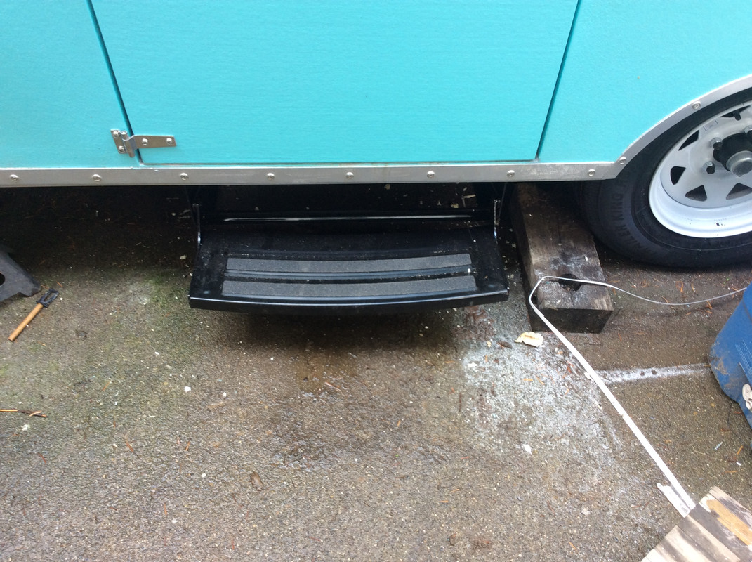

Got my pull out step mounted as well

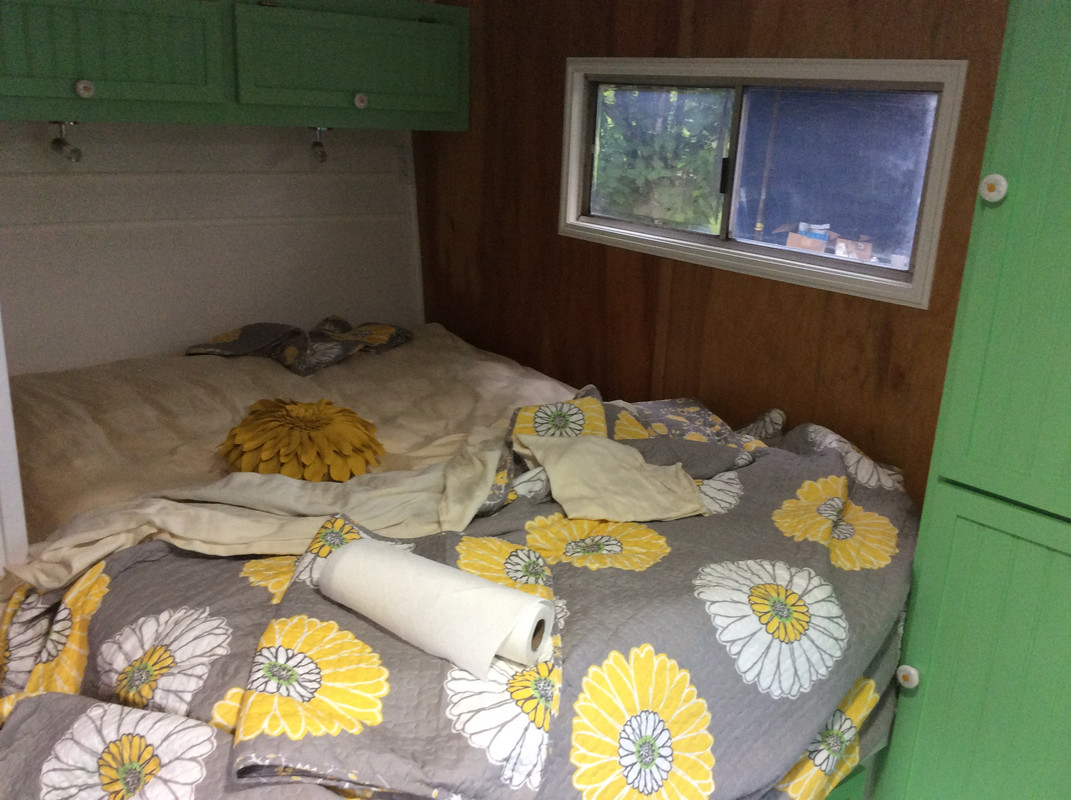

The bed is super comfy! It is SUPER tall however. Lol. I had to add a step for my wife to get herself up there. :lol:
