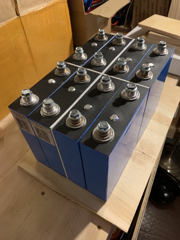

- LiFePO4 prismatic cells, 3.2 volts nominal. You need a minimum of 4 cells. I have 8, with 4 sets of 2 run in series (2 parallel, 4 series or 2p4s). The outcome is a 12.8 volt nominal battery. There are many sizes (amp hour ratings) of battery cells available on the web, but many are used or repackaged factory seconds labeled as new. Beware and do your research before purchasing. I got mine from http://www.BatteryHookup.com, a company located in Bensalem, PA that tests them first. They have a discount code available in David Poz’s video above that will take 5% off the price.

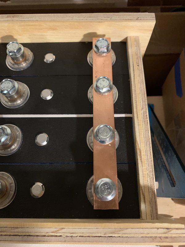

- Bus Bars to connect the cells together. If your batteries don’t come with them, you’ll need to make your own. You can flatten copper pipe as Dan Lin did, or get copper bars, as I did. I got 1/8” thick 3/4” wide copper stock from http://www.onlinemetals.com and built my own.

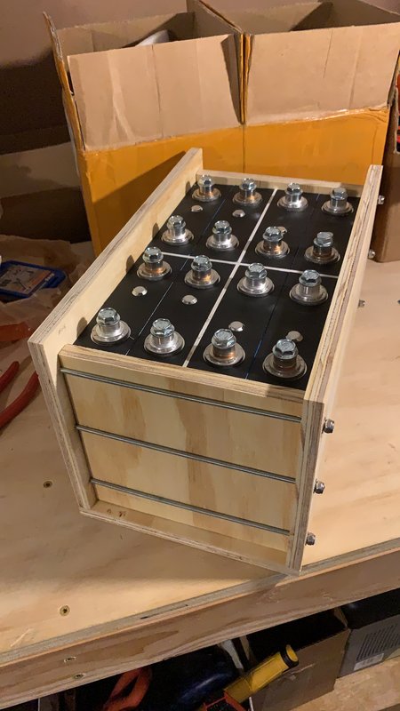

- Prismatic LiFePO4 cells last longer when compressed (not allowed to expand) so I built a tight fitting battery box using 1/2” plywood and threaded metal rods sourced from the local home goods store. I also got hardware for attaching the bus bars to the battery terminals from there.

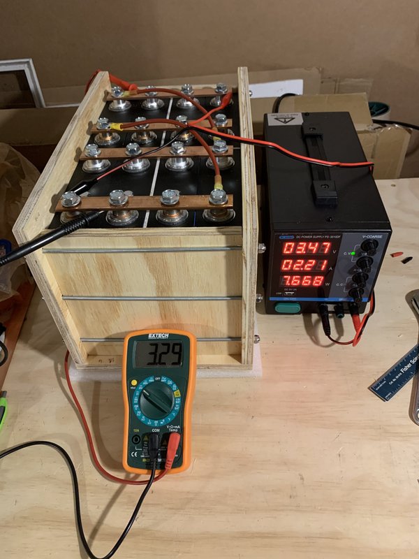

- Bench top variable power supply. In order to balance the cells at the beginning, you’ll need a power supply that can go as low as 3 volts, and be capable of continuous voltage and continuous current. It should be able to charge at least at 5 amps of current, but 10 amps is better (faster). The one I got:
- Multimeter. You’ll need to be able to precisely measure voltage on your batteries while balancing them on your workbench. Two decimal places on the voltage meter works ok but a resolution of 3 decimal places is better.

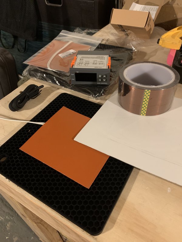

- Because I want to use my battery in winter, I made a battery warming system composed of a thermostat and beehive heaters. The heating pads, similar to mini seat heaters in your car, were placed under the battery and below an aluminum plate that helps distribute the heat. I followed Dan Lin’s design for the battery heater. This system will keep the battery above freezing so it can be charged during winter camping trips. The heating system is optional, especially if you rarely camp in freezing temperatures. (You can buy off the shelf LiFePO4 batteries with built in heaters by companies such as BattleBorn and ReLiOn if you wanted an all season battery but didn’t want to make one.) Parts for my DIY battery heating system are listed in Appendix 2 below.
4. Assembly and Top Balancing
Before your battery can be usable at 12 volts in the real world, the individual cells should be top balanced. The cells may all test a similar voltage out of the box (mine shipped at 3.28 volts each) but remember the voltage curve on LiFePO4 is flat. Anywhere along that center part of the curve, a 25% charged cell might have nearly the same voltage as a 75% charged cell. Thus, all the cells need to be slowly and carefully raised up to the right hand side of the voltage curve so they all measure 100% charge at the same time. The reason this step is important is that if one of your cells has a higher level of charge compared to the others, it can be pushed into overcharge territory by a 12 volt charger even as the average voltage of the battery bank is not that high. And overcharging = permanent cell damage. Top balancing also insures that you get the most amp hours from the whole battery if all the cells are working in unison. While some people may argue top balancing isn’t necessary with a good BMS, it is good practice and ensures proper functionality. If your battery cells get out of balance over time, you can periodically top balance them (like every few years) to get them back in sync.
How to top balance:
- Read read read before starting this step. Be sure you understand what you’re doing and have the time to devote to paying attention to your battery. The BMS is not involved in top balancing. You have to be the BMS yourself and make sure you don’t overcharge and puff your cells.
- Arrange your cells in parallel to make a large 3.2 volt battery. Connect all the positives together and all the negatives together. Check the voltage with your multimeter. It should be somewhere around 3.28 volts, same as an individual cell.
- Set the voltage on your power supply to 3.45 volts continuous voltage. Then after setting, attach the leads to the battery. (Never change voltage on the machine with the battery connected.) The leads can be at either end of the pack or central depending on how many cells you have. The idea is to provide the same voltage to all the cells simultaneously. If you have a 10 amp charger, dial back the current to 8 amps if it reads over 8. If a 5 amp charger, make it 4 amps. Keeping the current at 80% of max keeps the power supply from wearing out. If amps seem low, use thicker gauge wires and ring terminals instead of the supplied alligator clips. It makes a big difference in how much the charger can put out to the battery.
- Wait. For. Days. The power supply will be charging at 4-8 amps, but if you have 8, 78 Ah cells like me, that means to go from 0-100% you need to fill up 624 amp hours (Ah). 624 Ah / 4 A = 156 hours (6.5 days)! It won’t take you quite that long because your batteries don’t start at 0% but they could be as low as 10-20% to start. You can set the charging voltage level and then check on it a few times a day at this stage.
- When the voltage of the pack approaches the target voltage of 3.45 volts, the amps will decline to zero and charging will automatically stop. Once it reaches zero amps and 3.45 volts, you are ready to continue to the part of top balancing where you need to pay very close attention. You want to be in the same room and checking every few minutes because voltage will skyrocket exponentially at the right side of the charging curve and overcharging = cell damage. Disconnect the power supply and set it to 3.65 volts as the target voltage and then reconnect it to the pack. It should take less than an hour (varies depending on the size of the battery and charger) to reach 3.65 volts. At the end, voltage will climb quickly and you have to be ready to disconnect the charger immediately at 3.65 voltage and not let it get higher. Measure the voltage on the battery itself using your multimeter to determine if it’s at 3.65, and don’t rely on the power supply’s readout. There may be voltage drop between the battery and power supply especially if using thin wires, which can throw off the reading. Measure voltage at the battery using your multimeter for this step.
- Next, after the batteries reach 3.65 volts, wait 30-60 minutes. If the battery pack drops back below 3.5 volts, charge it back up to 3.65 volts again and repeat. If it stays above 3.5 volts, you can consider the pack successfully top balanced.

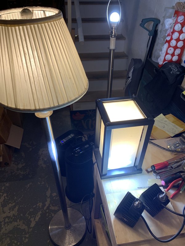

5. Capacity Testing
LiFePO4 batteries do not like to stay at 100% charge, meaning cell degradation can occur if left at full capacity over long time periods. It is a good idea to do a capacity test immediately after top balancing to bring the charge down, or at least put a load on the battery to get the voltage down around 13.5 volts if you’re going to store it for any length of time.
How to run a capacity test:
- You need to disconnect your bus bars on your top balanced pack and rearrange the cells in a 4s or 2p4s configuration to make the pack into 12.8 volt nominal. (At 3.5 volts per cell it will read 14 volts on your meter). Put plastic dividers between your 4 units to keep them from shorting out if vibration eventually wears through the blue vinyl coatings around the cells. (The aluminum housings are all continuous with the + terminals if I remember correctly.)
- You’ll need to hook up your BMS. The BMS connects to the negative terminal of the battery on one side and to the chargers and loads on the other. It has a series of small wires called balance leads that tell it the individual voltages of each cell. Follow the directions of your BMS to hook these up carefully because doing it wrong can burn out your BMS. Tape the BMS’s temperature sensor to the battery cells so it has good contact. Once the BMS is working and on, you should register 14 volts between the positive battery terminal (+) of the battery pack and the load side of the BMS (-).
- You’ll need a battery monitor with a shunt (Victron BMV712 for me but check out the AiLi battery monitor for a cheaper alternative). The shunt goes on the (-) of the BMS so that every device and charger must go through it to get to the battery. The shunt can measure the amount of current (Amp hours) that passes through so you can see how many Ah your battery has when you fully discharge it. You can also measure the consumption of specific devices in your system if you want.
- Attach multiple loads to the other end of the shunt and watch the current on the battery monitor. For LiFePO4 cells, the optimal discharge rate for a capacity test is 0.2 x the number of amp hours in the battery (0.2 C). For example, you can draw continuous 20 amps from a 100 Ah battery, or 30 amps from a 150 Ah battery at 0.2 C.
- For a long time the voltage of the battery will seem to remain the same. As the energy of the battery gets low the voltage will drop fairly suddenly. When the first cell in the battery reaches 2.5 volts the BMS should shut down the discharge to protect the battery. At that point see how many amp hours have gone through the shunt. It should be close to or a small amount better than what the battery was advertised for. If the battery had significantly less amp hours in it than advertised, you can try to get your money back or exchange it.
- Now that the capacity test is over, hook up your 12 volt charger and don’t leave the battery in a severely discharged state.
