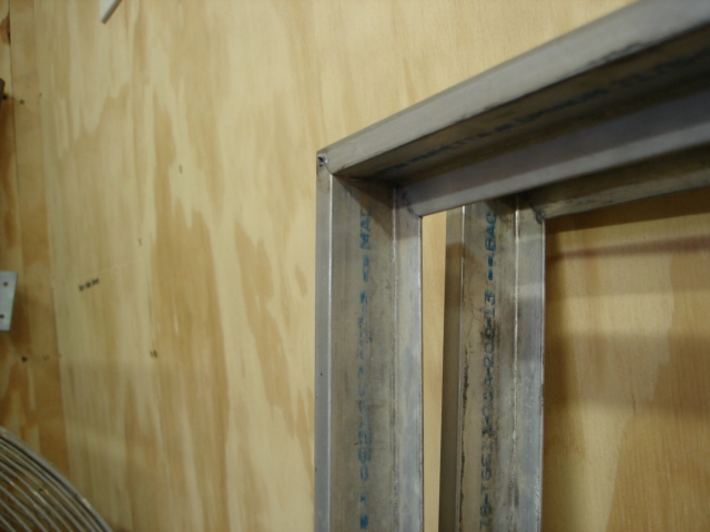

Postby Keith B » Thu Apr 12, 2007 5:30 pm
Well, I found some properly sized Z channel in aluminum... Got it welded up and ready for more modifications...
