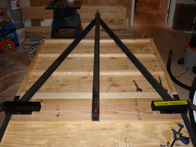

Built mine like this.
That's a 2x10 (or was it a 2x12??) cross member/axle.
Angib was most helpful in this project and it's very similar to the current "minimalist" frame in the design library.
Let's see . . . . Ummm! 4 years and going strong. Made a couple trips cross state and several trips "up in the mountains" dirt roads and such.

Now that's what I had in mind. Big question, did it save you any time? Money? Both?

Lou Park wrote:Now that's what I had in mind. Big question, did it save you any time? Money? Both?
Lou
Can't rightly say. Haven't built a metal frame from scratch.
Money: Metal was/is high back then, but I bought 2 lengths instead of 5-6?
Time: Bolted (grade 8 bolts) to an already square floor (which I had to square anyway ;) ) so not fussing with squaring/racking a welded frame (time saved) but who counts - it's teardrop time!!!!
Weight: Minus 5-6 pieces of 2x2 angle.
A metal cross member/axle might be lighter than the treated 2x. All through bolts were reinforced inside the tear with steel plates and/or washers and split lock washer and nylocks.
2x10 was epoxied to the floor.
That's about all I can recall.
I found my receipts for the trailer parts. Of course the metal bill was not with them :roll:
geron
