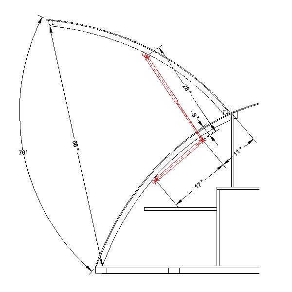

This drawing was posted by Andrew,
I've been studying it, but haven't found the common denominator (if there is one) that I can use to apply to my hatch size.
Is there a formula?
Rob

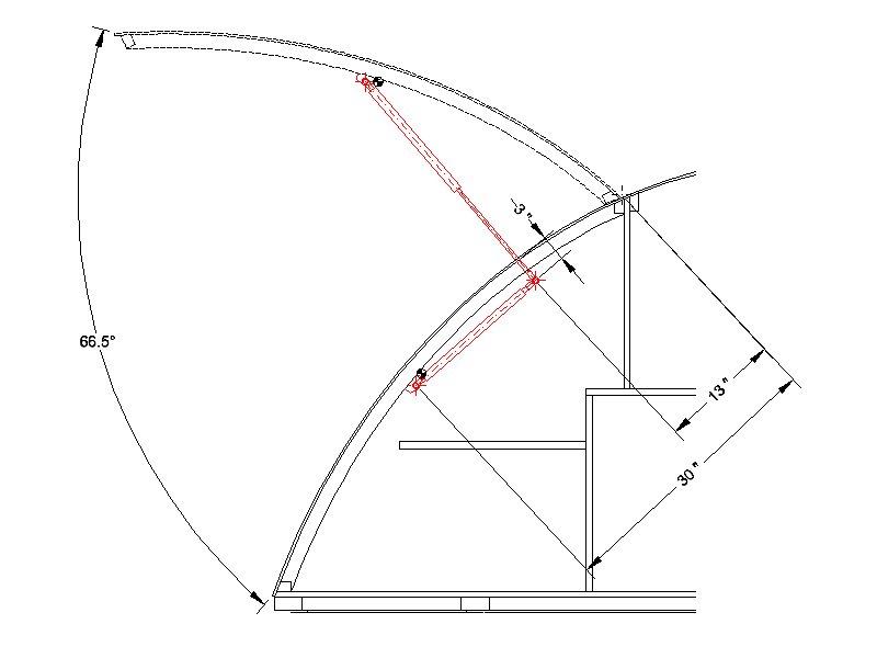

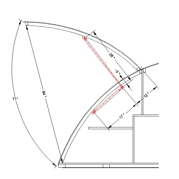

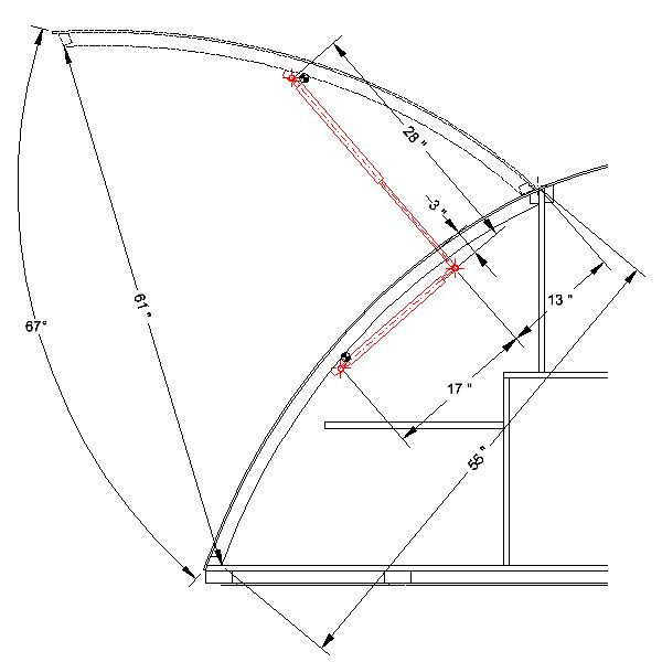

48Rob wrote:Is there a formula?
Aaaiiieee! You mean, like, a formula for world peace? 'Cos that's easier than a formula for hatches and gas springs.
The diagram above works with the NAPA gas spring that was quoted in the original message (sorry, lost it!). The main variable for positioning the gas spring is how far you want the hatch opened. To make the hatch open through a bigger angle, you move the whole gas spring arrangement nearer to the hatch hinge. To help work this out, here are two more diagrams with the gas spring moved 1" and 2" nearer the hinge. I've had to redraw the original so here they all are.
Original:
Moved 1" nearer the hinge:
Moved 2" nearer the hinge:
To save working out angles, I show the 'opening' dimension of the hatch compared to its length, so:
- the original gives an opening 111% of the hatch length (ie, 61"/55");
- the moved-1" gives an opening 116% of the hatch length;
- the moved-2" gives an opening 124% of the hatch length.
If that helps. But maybe not.....
Andrew

Joanne wrote:Now, as you move the lower attachment point closer to the hinge, isn't there a greater "lever effect" on the strut? Doesn't the strut see more apparent weight on it?
Joanne, you're absolutely right. Moving the strut nearer to the hinge means that you would need a higher-poundage strut to hold up the same weight of hatch.
Grant, the logic to putting the gas strut cylinder-up/rod-down is that virtually every strut will damp itself as its reaches full stroke, as long as it's this way round - it's why car trunk lids ooooze into the fully-open position rather than simply banging open. This may be a country-specific thing - gas struts very rarely fail here, maybe because we don't get the extremes of temperature that you do.
I can see the sense in both points you make about fixing the strut the opposite way round to what I've shown - I would go and correct all the drawings above, but then subsequent posts wouldn't make any sense!
Andrew
