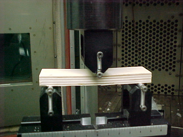

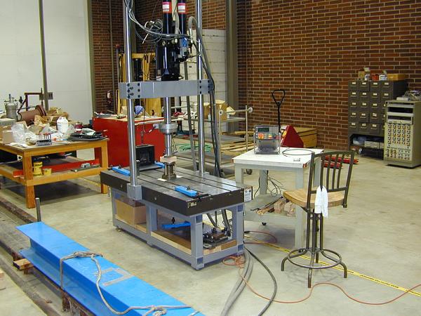

all samples were four feet long and compressed in an MTS test stand. each sample was 3 1/2 inches in width and thickness varied. with the exception of the 2x4 all samples were of baltic birch plywood. each sample was compressed until failure. no injuries were reported to operator or observers.
2x4 2917 lbs
1 1/2 inch 2647 lbs
1 inch 2169 lbs
3/4 inch 1658 lbs
1/2 inch 1291 lbs
3/8 inch 1046 lbs
1/4 inch 743 lbs
1/8 inch 215 lbs
Notes:
2x4 was a home depot average stud material. failure point was not specfic to any knot or joint.
1 1/2 inch was made from 2 pieces of 3/4 inch plywood glued together with gorilla glue to an approximate thickness of 4 to 10 mil clamped every 6 inches for 8 hours. Failure point was in plywood glue point 2 layers from aftermarket assembly joint.
1 inch was made from 2 pieces of 1/2 inch plywood glued together with gorilla glue to an approximate thickness of 4 to 10 mil clamped every 6 inches for 8 hours. Failure point was in plywood glue point 1 layers from aftermarket assembly joint.
test setup was a basic 3 point bend test fixture with the contact support points at 6 inches from end, load cell at 24 inches from end and contact support 42 inches from end. File picture of set up attached to notes. May not reflect actual test samples. File picture of test equipment used. May not reflect test location or setup. Extension supports used due to test samples lengths. See Engineer for any questions.

Postby Cdash » Fri Dec 02, 2011 12:21 pm
It is really cool that you did this testing, but I think you said and what I see seem to be two different things.
Forrest747 wrote:all samples were four feet long and compresses in an MTS test standImage
What I see in this picture is that you applied the load (and the supports) to the flat face of the plywood. If what I see is correct, this would test a bending load, which would be better indicator for the floor or roof.
It seems like the right test for a wall panel would be to - (this is the best way I can think to describe it) - would be to place a 4x8 sheet upright on the 8' edge and load it (on the thin edge) vertically until it fails. I know this wouldn't be practical due to the size and I don't think the test would scale well either since a small width of the material material size isn't braced the same by the rest of the material around it.
I wonder if anyone has an old teardrop that could be backed under the load cell..... :shock:
