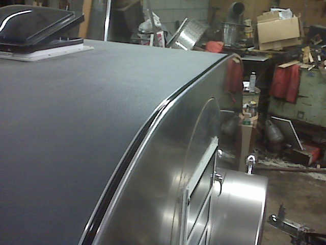

Postby Woodbutcher » Tue Oct 02, 2012 7:06 pm
I ended up using a marine vinyl over 2 coats of epoxy. Contact cement for bonding. It has worked out great so far. Good luck with your build.
