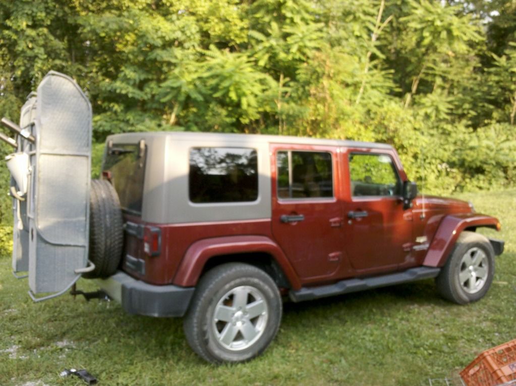

Mezmo. I have thought of the added heat of painting the top black but I will be installing an air conditioner and once the top is up a large portion of the top is white so I am hoping that this will kind of work itself out. I really like your idea of adding weights to the front to even out the load. I am planning on putting a vertical 2" receiver on the front so that I can attach the support for the jon boat I could easily make a weight bar that would side into the receiver.
The folding boat does lock in place. When you unfold it and slide the seat forward it locks, it also has 2 pins on the bottom that lock it .
I have not been able to do any test runs.
The boats can be carried on their side , stacked if I put the boats with the rod holders sticking up on top. and ever hauled vertically. see below pic.

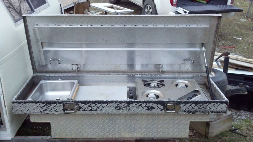

This an idea that I have. I am thinking about putting the kitchen in a aluminum tool box. It will contain the stove sink and water tank and storage. This will allow me to move the kitchen around to equalize the weight. I can haul it on the front on the back on a carry all attached to a 2 in receiver or it will slide in the side door. Has anyone ever tried this. Pic below is just the parts sitting in the box.

Re: teardrop toy hauler
Postby RandyG » Sun Feb 24, 2013 12:58 am
I was going to suggest using a water bladder to balance the trailer when you're not hauling toys on the front. Maybe put one in the frame under your front deck and fill it so much to give you more tongue weight.
Postby sumo » Mon Feb 25, 2013 6:46 pm
Added bottom cover piece. Went back with the wider wheels. Trim and paint is next. I am still toying.with the kitchen in kitchen in the toolbox idea.

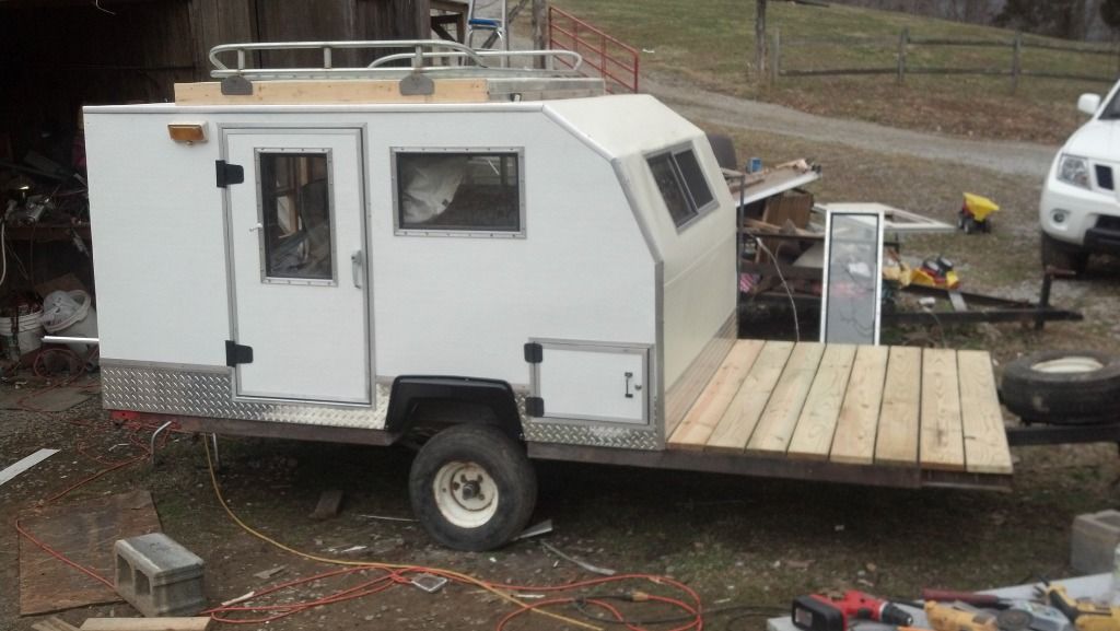

Postby sumo » Sat Mar 02, 2013 4:59 pm
Little more progress. Added dimond plats to tbe bottom. Done a little trim work and put on some decking.
sumo
Posts: 130
Joined: Thu Aug 23, 2012 8:05 am
Postby KCStudly » Sat Mar 02, 2013 7:25 pm
That is shaping up nicely. Keep up the good work. :thumbsup:

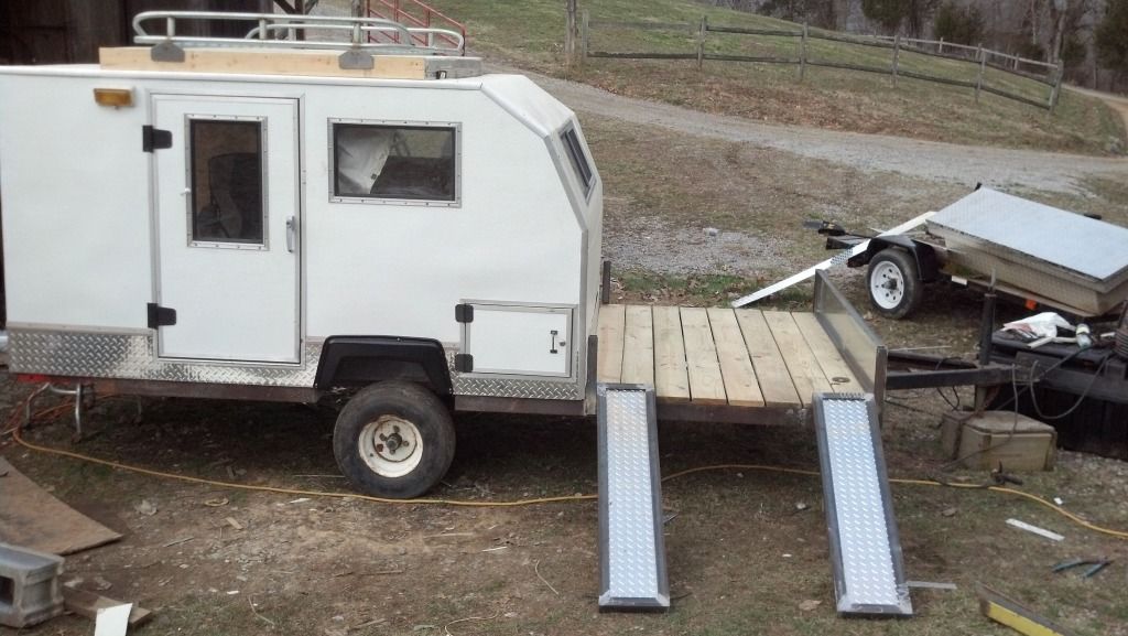

Postby sumo » Sun Mar 10, 2013 6:59 pm
Front railing welded up. Railing doubles as ramps
sumo
Posts: 130
Postby RandyG » Sun Mar 10, 2013 7:24 pm
:applause: :applause: :applause: Nice dual purpose!
Save some of that plate for the trim around your top where those 2x4's are. Looks like you're on the "back 9", keep it up.
