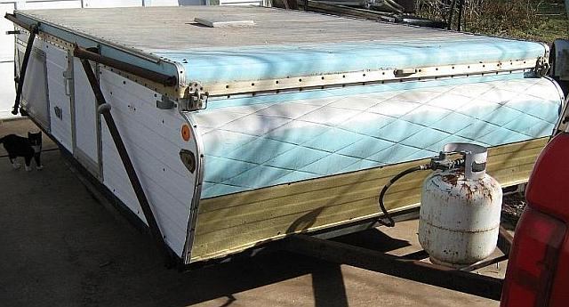

The externally mounted "arms" that hold the top up were designed without much attention to user safety. I suppose raising an intact roof might have been accomplished more easily with one person on each end but when I attempted to "pop the top" it took a nose-dive towards my garage door, not good. Time to get the socket wrench out and remove the arms. After twisting two of the four bolts off I decided using the grinder and cutting wheel would be safer and quicker. Four spring/cable arms into the metal salvage pile.

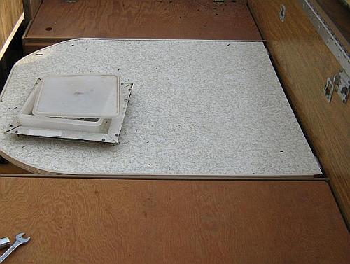

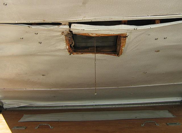

The roof vent had been a source of water leak and the ceiling in that area was deteriorated. The ceiling was a thin layer of cardboard material with a foil surface on the upper face, attached with screws and those clear plastic "star-shaped" things,,, (can't think of the proper term now),,, you used to see wall mirrors mounted with.

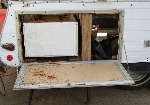

Water had penetrated the corners where the "arms" were attached and also on the leading and trailing edges of the curved aluminum skin at the corners.

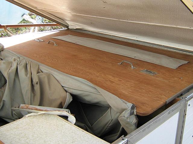

The flooring was intact, both the interior vinyl and underneath. No soft spots. The plywood doesn't appear to have ever been treated with anything and shows nothing other than slight weathering.
After finding this much water damage, I was surprised to see the inside about 90% free of damage. A few water stains on one cushion and the particle board counter was swollen and crumbly.

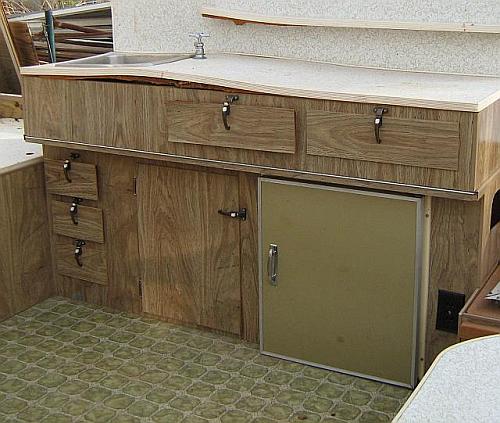

The rest of the interior was in remarkably good shape and all parts were there. Both fold-out plywood bed platform pieces are good, along with the dinette table and seating, remaining cushions, cabinets and appliances. The canvas had no holes and zippers worked great but the vinyl windows were toast.

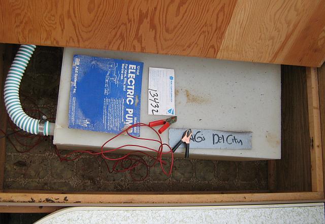

The sink, stove, frig and water tank appear to be in good shape. And, there was even another tire/rim in one cabinet!

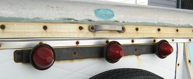

This light bar might be a nice touch on the next build:

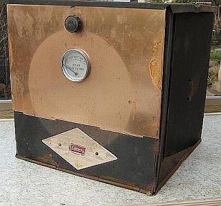

The pics are very interesting, too. I want a Camp Toaster!!! The bowl you've pic'd is fantastic... is there more? And is that a Coleman oven or something?

The treasure hunt was fun, I'm a sucker for old stuff especially camping gear. There are 4 bowls, 3 in perfect condition and 1 with some enamel chipped off on the rim. And, you are correct! That's a collapsible Coleman oven. It needs some cleaning but looks to be in pretty good shape.

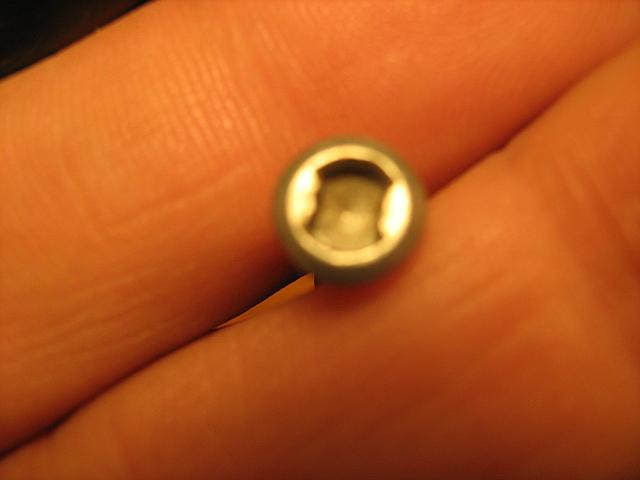

Gorgeous day on Saturday in between snow storms and I got a chance to work on the pop-up conversion. Blurry pic, but this screw head was a new one for me. It's called a clutch head. The builder used them almost exclusively. I was able to find a Vermont American bit at a local hardware store that carries a large inventory. You won't find it at most stores.

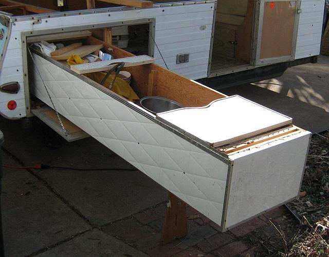

An interesting design concept was this slide-out stove/galley. The tracks were made of hardwood and there was a hinged/adjustable height leg to support it when it was fully extended.

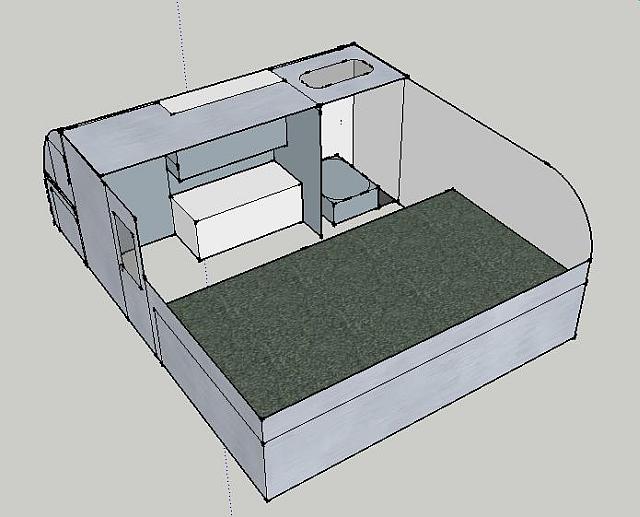

Evaluating what's available,,,, I'm considering something like this. (Newbie SketchUp attempt).
This design includes a bed which converts to a dinette, a portapotty/shower area and storage cabinets inside. I will add the hatch/galley area on the back with a/c. Total height will be lower than a standy but still allow head room while sitting at the dinette or seated on the portapotty while showering. I have removed the built-in cabinets and can easily lift the tongue at this point. Hatch width will probably be less than the trailer width for ease of lifting. Still tossing all these ideas around,,,,,

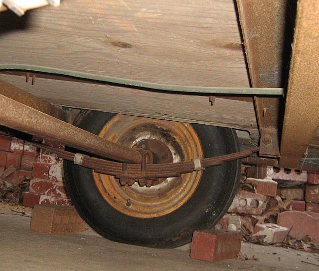

Just a word of warning I tried to use the frame from a smaller version of the same brand of popup on the Winter Warrior but tried, for some stupid reason, to open up the wheel wells. If you cut that plate that is outside the wheel the whole frame collapses that is the main strength of the frame front to back. I used a custom built frame on our trailer and the rebuilt trailer from the pop up now has a 500 gal. smoker on it that my son built.
