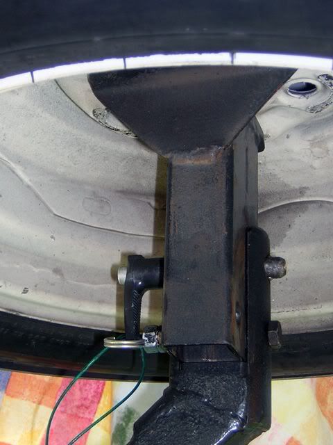

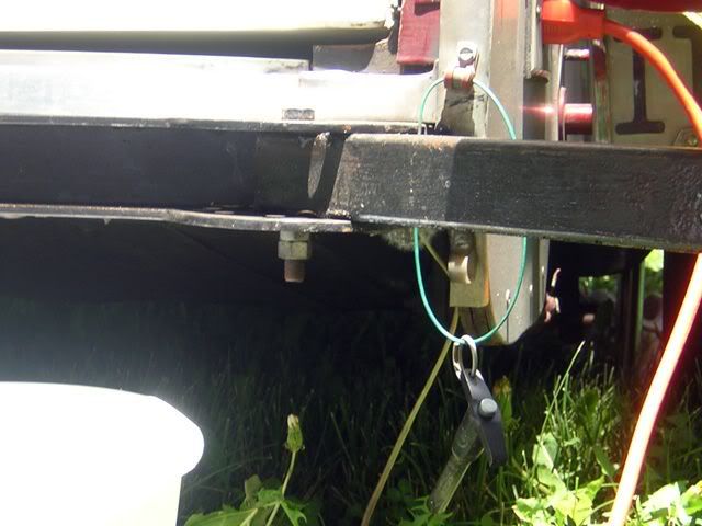

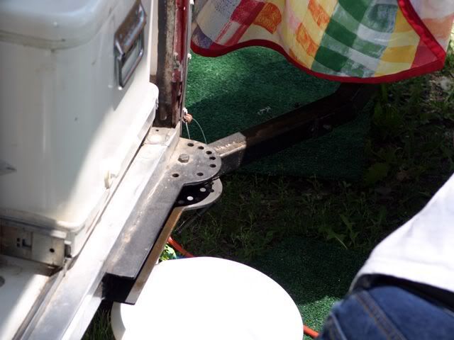

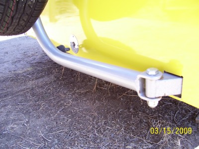

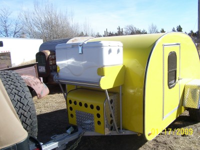

We finally got some close up pictures uploaded to my album. If you have any questions, ask away. (But I will have to ask KP as I am very mechanically challanged! :? ) He also built a platform to carry my ice chest on the front of my teardrop, it sits over the A/C.
Here are a couple of them. This is the outside view of the bracket that holds the tire.
Here is a view of the inside.
Here is the ice chest holder.

Postby Classic Finn » Sun Mar 15, 2009 8:05 pm
enigmak wrote:We finally got some close up pictures uploaded to my album. If you have any questions, ask away. (But I will have to ask KP as I am very mechanically challanged! :? ) He also built a platform to carry my ice chest on the front of my teardrop, it sits over the A/C.
Dana
Hey There
Thank You for posting the photos. :applause: I really like that set up.
I think I,ll get our neighbor to do some stainless pipe bending and welding since Im not a welder and I dont have a bender for it.
It looks like real clean styled setup. No too heavy either.
So that pin or bolt slides out and you turn it to set it as the table then?
How is it installed to the frame?
In the first photo it looks like it locks into position? Or how is that?
I know I know Im curious and full of questions. :lol: But that is nice.
Thanks again for the photos.
Classic Finn

Postby enigmak » Mon Mar 16, 2009 1:01 am
Classic Finn, I posted more pictures in my album. They show how it is mounted on the frame and secured in place. If you need me to I can try to get some more pictures.
All I have to do is pull a pin, swing tire out, pull another pin, lay tire flat, and I have a table. When it is returned upright it is secured with the second pin, then it swings back into place and is secured into the hole with the first pin inserted to secure it in place. Does that make any sense? It is very easy to use. Now I just have to make a table cloth for it.

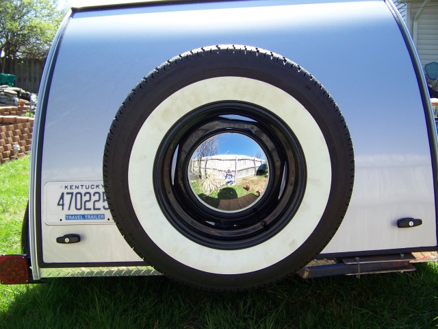

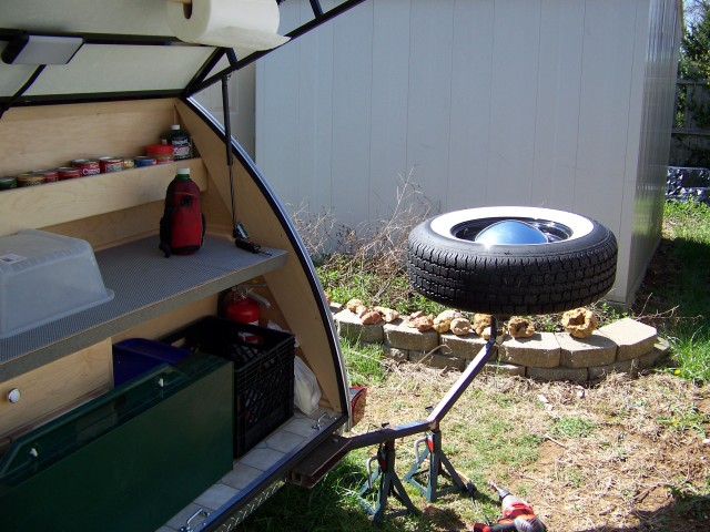

Postby skulli69 » Tue Mar 31, 2009 10:45 am
Ok you guys got me to thinking :thinking: , very dangerous :twisted: . Here are some pics of the out come. :applause:
more photos in my album
