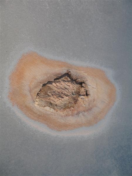

Postby john » Sat Mar 20, 2010 4:41 pm
It's warm! Time to work...New update.
First off I'd like to mention how well the aluminum tape has lasted. I brought a roll of the stuff with me on our family trip west for emergency use.
I first started "fixing" issues with the roof with the tape at Ten X campground while visiting the Grand Canyon. I never expected the stuff to last nearly 9 months. It could have lasted longer.
I kept the camper in the weather during the winter. Sun, rain, snow, cold. I hoped the weather would bring out more flaws in the wood. I would periodically check the roof for new flaws so as to cover them with tape before any water damage was done.

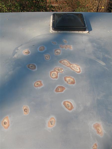

After removing the tape and sanding I was left with this.
And here is a closeup of one of the bad spots.
I am not sure what the problem was. Most of the bad spots are located on a single sheet and after prepping them I found they were usually knot related. They seemed to be related to bad filler by the manufacturer, but the filler could have been damaged by water intrusion. A couple were indications of a void underneath.
In the end I may have put one sheet on upside down. I will never know for sure.
Question:
In repairing this, would you first coat the area with epoxy then fill it in with bondo followed by fiber-glassing the entire area for a final coat ?
Or would you fill the hole with bondo then then fiber-glass the area?

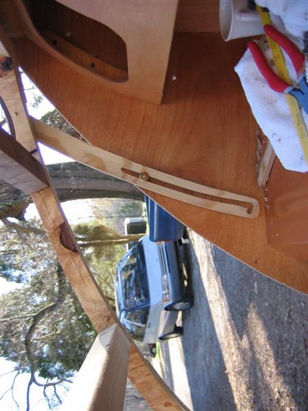

Postby john » Fri Apr 09, 2010 8:19 pm

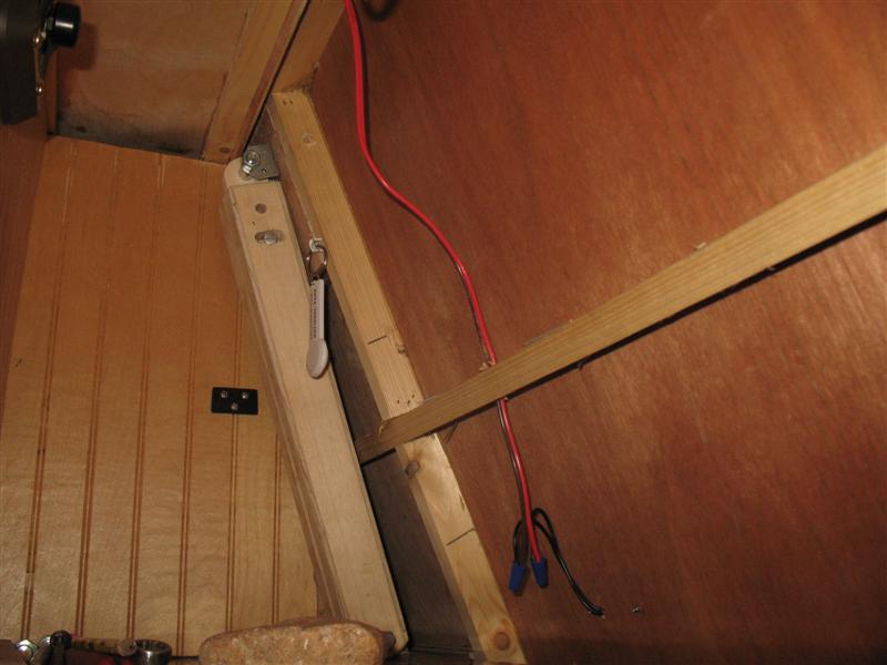

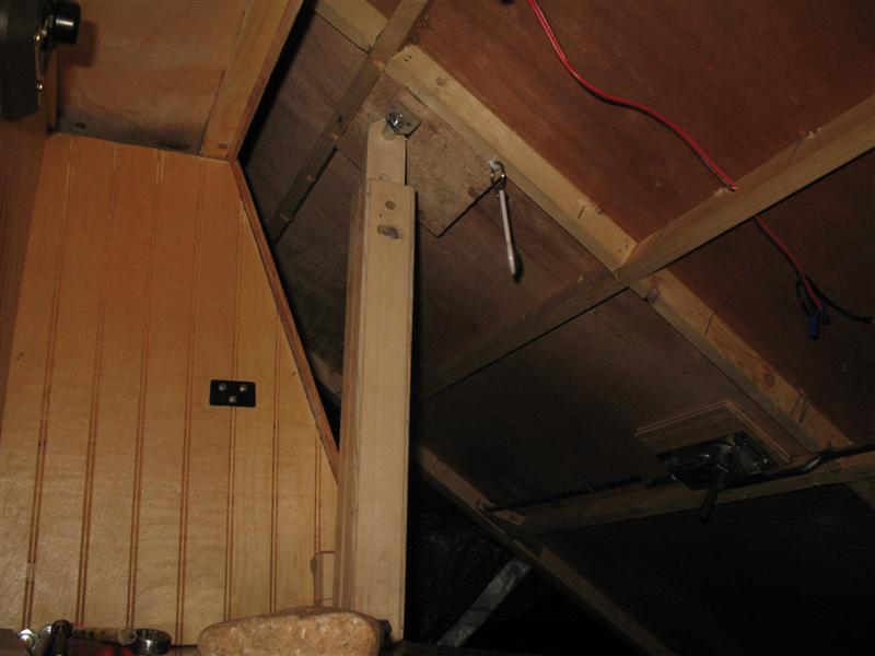

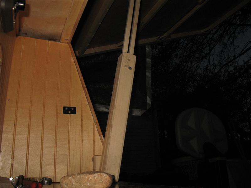

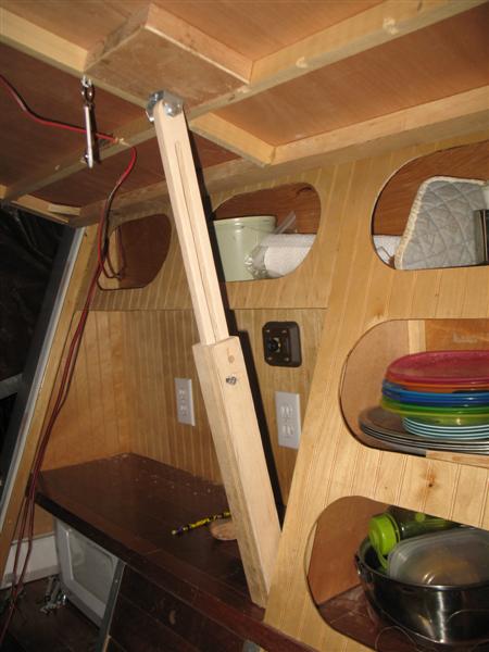

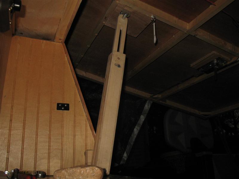

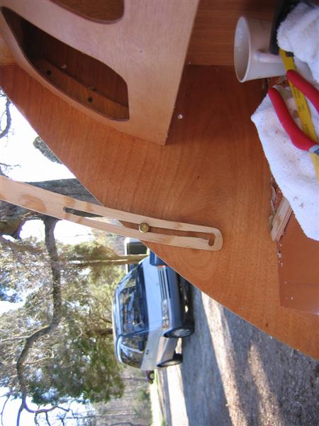

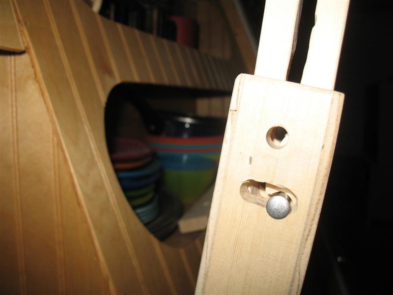

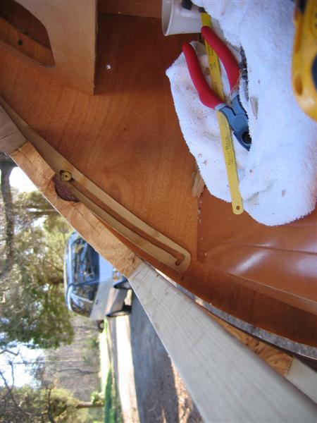

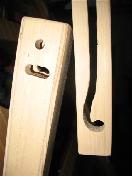

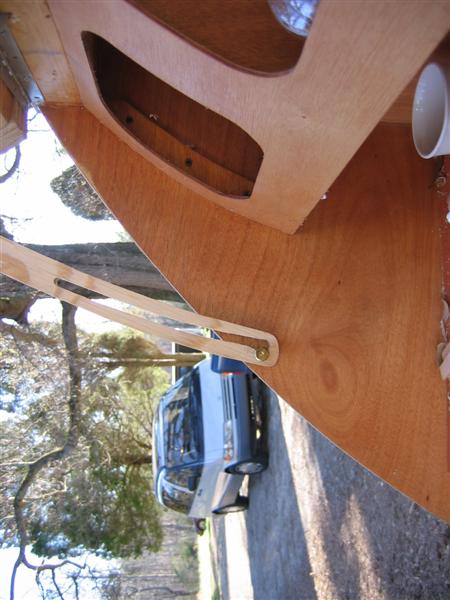

I finally got around to moving beyond the scrap stick I have been using as a hatch prop.
I had bought a couple of locking hatch struts early in the build, but when I got around to installing them, my build precluded their use. There was not enough room for gas struts either.
The only place with the room to install a strut was near the middle of the hatch. The full extension length that was required and the limited room available for closing forced me to use a strut that telescopes. A one piece strut similar to my first build wasn't going to fit.
I wanted it to latch open automatically when opened and to be wind safe also. I didn't want the wind to catch the hatch and lift it enough to cause the prop to fail and let it fall. My prop only allows the strut to telescope when unlocked first.
This is the first prop of this kind that I have made and, unfortunately, it has suffered from my normal overbuilding. It looks a little chunky, but it works well.
I still need to line my hatch...
Here is a video...
http://www.youtube.com/watch?v=unMNp4f_BME
and pics...

Postby sagebrush » Sun Apr 11, 2010 9:06 pm
Looks like it gets the job done! :thumbsup: I would say that is Yankee Ingenuity but you might be insulted. :lol: Will

Postby H-Balm » Mon Apr 12, 2010 5:12 am
cool work on those struts.

I have had to repair my boat and from what I've learned and experienced epoxy with or w/out filler is the only thing to use where there may be moisture or any flexing involved. The close up looks like it still may have damaged and loose bits in it; even clean, the procedure would be to paint on liquid epoxy to soak in and then put the mix cup in the freezer to stretch the pot life. In about 30 minutes (if you're using fast setting hardener) the repair will have started to gel; get the cup from the freezer, mix in filler to make putty and apply. Letting the first coat of liquid gel makes for better application of the putty because it doesn't immediate dilute with the applied liquid; putting the mix cup into the freeze gives you just enough longer open time with that cup that you can make the repair using the same mix (assuming you used the minimum measured amount to reduce heating in the pot). I'm cheap and epoxy isn't so I don't like to toss any but it's hard to mix tiny amounts accurately.
Sheathing boats with GRP which is similar to what you're doing only more so and is considered problematic because it will quite often delaminate. Even with excellent product and proper application the epoxy will still be stuck to the top surface of the wood but the wood will separate; this could be because of moisture working through the wood from the _other_ side. Thus the attempt to soak the wood w/liquid first to get as much penetration as possible. When sheathing boats one expert (I can look him up if you like - I think - been 7-8 years since I referenced him) will sheath in 2 layers: The first layer of glass is applied and allowed to cure just barely solid. Then the whole area of applied GRP is _stapled_ to the base at 3"-6" centers using the longest SS staple possible; you gotta do this before the cure progresses too much or the staples will just bend over. Then the second layer of epoxy and GRP is immediately applied over the staples. This is all because the likelyhood of delam is so great.
If epoxy is left to cure past a certain point in will "blush" (develops a haze on the surface) and you must then wash the surface fully with water and sand to give the next layer grip; don't simply sand or you will grind the blush into the surface and next application won't adhere as well. Before the blush occurs epoxy layers will unite chemically which gives the best results. The time to recoat depends on the mix and you have to check with the vendor for thier instructions. For example IIRC West Systems needs to be recoated w/in 8 hours but it's been a few years since I did any real GRP work to don't rely on that - I could be remembering wrong.
