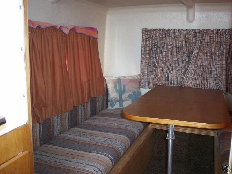

The Compact design:
If you look at the Compact, the wedge on mine forms the walk-way right down the center and the cutouts are basically storage near the door and a seat area for the dining/bed. Going to a single door may be best but I doubt I'd be able to keep its 'originality' look to it.
