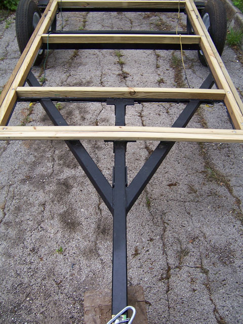

I lengthened the tongue 16" and added an "A" frame of 2"x2" square tubing to mine. Also I welded all of the areas where the tongue was only bolted from the factory. Of course this was easy at the time, as the trailer was still in the "no floor" state!
Others may have better Ideas for strengthening this area.

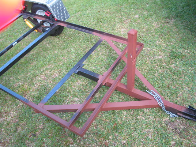

I just thought it was a weak looking tongue and a little cheap fix would make it better. Was planning a cross country until financial disaster struck (a personal one). The box of the tear will stiffen the trailer bed but really does little for the tongue with so few weld points with some unnecessary flexing.
I lengthen min a foot so ignore the extra and the vertical piece that I may use for my gas tank or spare tire depending on hitch weight.

Postby SmokeyBob » Mon Sep 29, 2008 9:26 am
Not sure if this is what your looking for. Maybe it will give you some ideas.
Pics for Building the Alegria I

I did end up bracing each corner and installing a longer tongue that almos goes back to the axle. Pics are in the album. I will eventually get back to working on my teardrop after my shoulder gets better.
