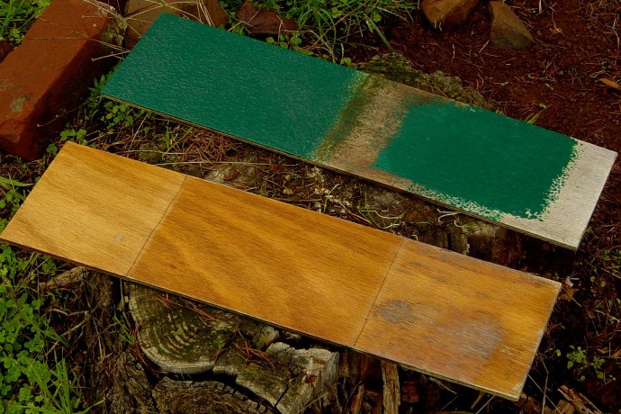

So I set up and started a durability test November 2007. The test panel is a piece of 9mm marine grade Okoume plywood. It was first sealed on all sides with CPES. The CPES was cured for 5 day. It was then sanded with 220 and 6 coats of HybriVar were applied. The panel was cured for 2 day then positioned horizontally in full sun outside.
** December 2008, one year results:
Over the year the panel has seen a temperate range of 22-100 degrees, it’s seen lots of rain, been cover with snow for about a week, been through many freeze-thaw cycles and baked in the sun. I’m happy to report that so far it is holding up great and shows no signs of degradation. It also shows no notable fading or change in color.

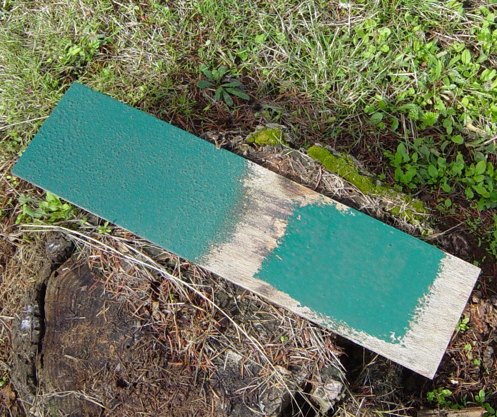

The other finish I mentioned is a colored polyurethane, this is sold as a roll-on finish for pickup beds. It is very durable, holds well against rock chips, is low maintenance and the textured finish covers up minor surface imperfections. The brand I use is Durabak. I’ve been using it over epoxy (normally CPES) sealed wood with no problems for a while now. Since I was doing the clear finish test, I decided to test Durabak over bare plywood.
As with the clear finish, the test panel is a piece of 9mm marine grade Okoume plywood and was started November 2007. The panel was light sanded with 80 grit and two light coats per manufactures instructions were applied. The back and edges of the panel were left bare. After the same 2 day curing period it was also positioned horizontally in full sun outside.
I’m happy to report that so far this test reveals no signs of problems; there is no instance of checking, cracking or delamination. The finish is still shiny and hasn’t faded.
On top one is the Durabak test panel, on bottom is the HybriVar one. The HybriVar is in the middle portion of the panel. On the right side is what happens when an interior clear finish without UV additives is exposed. On the left is a “box store” exterior finish which is still intact, although started to have fogging issues when water pools on it one month into the test.
Based on these results I’m definitely going to start using more HybriVar for my exterior clear finish needs. It also looks like forgoing the CPES sealing of Okoume plywood that will be coated in Durabak will work. For Fir or Pine plywood I’m still thinking I’ll first seal with CPES because of their higher tendency to check. One last thought; if your Teardrop or Tent Top camping trailer is stored inside or under a cover when not in use like I do, this one year full exposure test is probably equal to the exposure your trailer would see in 6-9 years.

Time for an update, my test panel has almost four years of weathering on them now.
Durabak Panel: It's holding up just fine with minor fading. What I'm finding is some rotting away of wood where the panel has not been coated, but just fine under it. I poked around the edge and there is no sign of lifting.
HybriVar / EM2000 Panel: This test has made it to the end of it's useful life. In the Summer of '10 it started breaking down around the edges. From what I could see, as the finishes on either side failed, the CPES failed because of UV exposure. This started lifting the edges and causing the bond to fail. Before the end of Winter it had completely failed. So it lasted a little over 2 1/2 years. Again assuming indoor / out of the weather storage when not in use, I would see a 10 year useful life.
