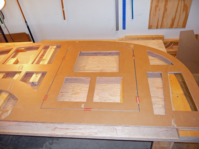

Postby aggie79 » Sun Nov 01, 2009 8:23 pm
My vote is for a router. I used a template and router with bushing and 1/4" spiral cut carbide bit. It does create a 1/4" clearance between door and opening. My trim will take the gap down to 1/8". If you need a smaller clearance, you can use an adaptor and a 1/8" Rotozip bit.
Template:
Routed door:
