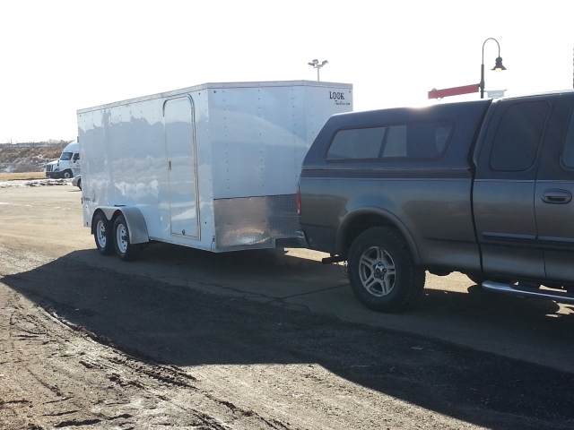

I've been lurking here for awhile admiring all of your conversion projects, and dreaming of some day starting my own project. That day has finally arrived as I've purchased a slightly used 7x16 trailer and can't wait to get started. I have a lot of ideas in my head, but I now have to get get serious about what I really want and need, and fit it all in. Progress will most likely be slow because of funds, time, or a combination of the two. We'll get started with a pic of the trailer on the trip home from Michigan.

Welcome! Nice looking trailer.
You are going to have fun.

Trailer looks nice! Wasn't Look Trailers started by the former owner of another very reputable company? I forget which one.

For used, the outside is in really good shape.
