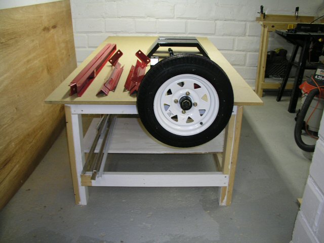

Built a table to build those durn walls on... Unlike the last table I built, which was a wimpy thang, this one will hold bags of sand, or 14 feet of water, or a vaccuum bag, what ever is the handiest, without collapsing. :banana:

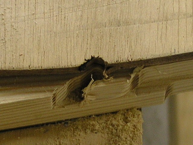

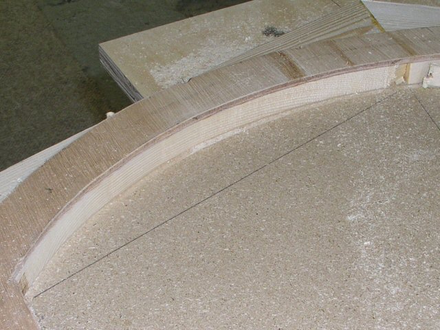

After I glued up those 1x4's I cut the template out of the 5.2mm luan... that's less than 1/4". Let me tell you... that luan is like a rubber band... it moves all over the place.... I figure, no problem, I'll clamp it down... Later on I find out that the 1 1/2" width isn't really enough to keep the router stable... but I'm getting ahead of myself... I set the template on top of the pine frame, and figured I'd make a practice cut...
The inside cut went fine...
then I tried an outside cut.... suddenly I noticed that the bit was cutting into the pattern.... :shocked: Image

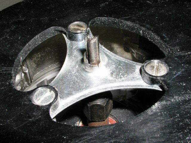

Hey, that's not supposed to happen... So I look at the collar on the router... it either melted, or got chipped away... Needless to say I am not a happy camper...
I either need a better router guide, or I have to change my method of construction to the one that Subtear is using...
http://www.teardrops.us/userfiles/33/te ... anean.html
Hmmmm :pipe: I think it's time to bounce this off one of our experts... Steve Frederick... Steve, your thoughts...

...get a Porter-Cable router with the 2 piece, screw together bushing set...we just luv it at the shop.................. 8)

Postby Steve Frederick » Sat Mar 04, 2006 7:58 pm
Two things..I use a top-bearing pattern bit when the pattern is on top..a bottom bearing bit otherwise.
For pattern work with a guide bushing..get a Porter-Cable-Type base and some brass screw-on bushings..
I get my stuff fromMLCS
Also, For really critical cuts, coat the pattern edges with epoxy, paint, or even wax, to keep snags and bumps to a minimum.
I'd fix the pattern with some schmutz (epoxy/wood dust/silica) and carry on!
Blessings, Steve

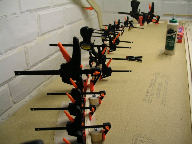

Postby mikeschn » Sun Mar 05, 2006 3:53 pm

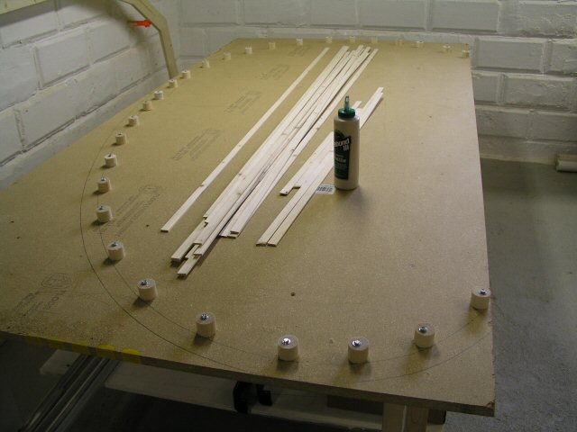

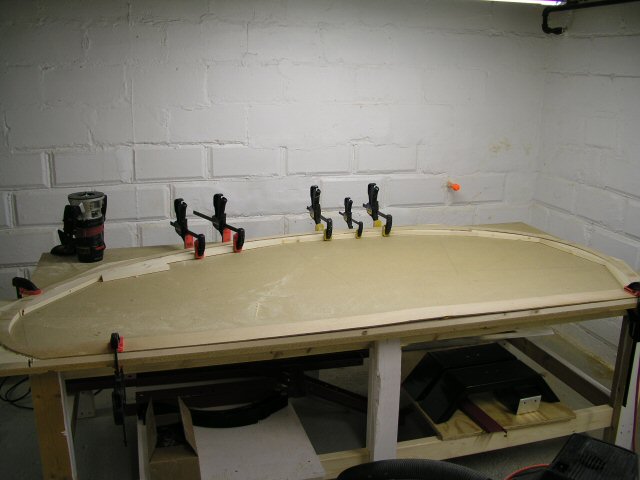

Today is a better day... Went to HF, where they were having a big sale, and took my 10% off coupon... Got that portable bandsaw, and a bunch of clamps.
Got home and fit up the table with a bunch of dowel pieces...
Then I started glueing up my strips... (which are 1/8" thick btw) The first two strips were a little tricky, but the third one went on really easy. I'm experimenting with titebond III, and it appears I can put on another strip every 30 minutes... The most important thing I learned today is, I didn't buy enough clamps... You need one on every dowel piece, and one inbetween...
It's getting to be fun now!!!
