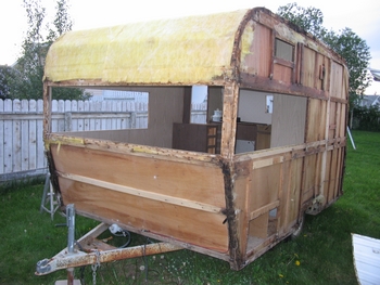

Although this is not to be a teardrop, I think it qualifies as a tiny travel trailer, since it is starting as a 14' Travelair, and getting smaller from there. I hope you guys don't mind me posting about this project in this great forum.

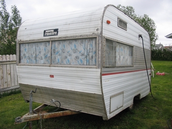

Here's the trailer as found. Towed it home yesterday, and snapped this pic this afternoon.
Started right in by taking off some trim, and pulling off one sheet of aluminum siding. As expected major rot to be found. I think this is a 1967 year.

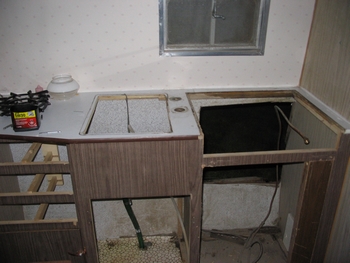

This is the galley before I started in tonight. I will try and recycle much of these parts, so I started by removing them :-)
And the kitchen after some working time.

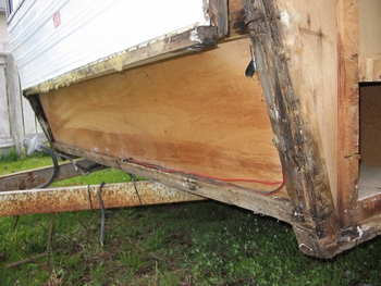

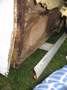

Did some more demolition today day two. Removed furnace, cabinet doors, shelving, bunk etc. Also some more siding.

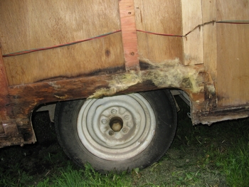

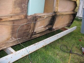

Found exactly what I thought in there too. Rot in the front corner.
and around the wheel well.

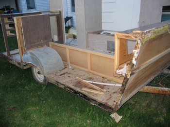

Day 3 - some more demolition work in progress. I got all the skin off today, and removed all windows, the door, any interior aluminum trim, and am almost ready to knock the thing down.
Just want to remove a few more cupboards, and internal walls for salvage before I take a hammer to it. Oh and the water tank still to save.
Here it is without any siding. LOTS of rot.

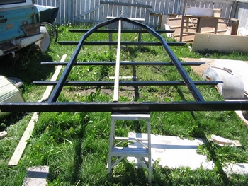

Took a wire wheel and buffed off all of the loose rust flakes and particles. Down to shiny steel in most places. Then painted. Here is the frame will anything that can be unbolted, unbolted.

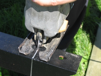

Next step is to narrow the frame by 7". Three and 1/2 inches off of each cross member on either end. I used my jigsaw (see the jigsaw thread) to shorten these pieces. Maybe not the ideal tool for the job, but it got it done.

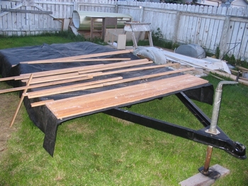

Now I actually start reconstructing! First add the 2X4 floor frame. I used pressure treated here (unlike travellaire), and so these should last a while. Down the middle, the original only had 1 floor joist. Then the floor was made from 1" plywood. Since this would have made for 24" spans, I chose to add a second floor joist down the middle section and use 3/4" flooring with only 15" spans.
Here's the wood floor frame complete.
Now I can actually start on the floor. I am using 3/4" solid maple which I recycled from a house last summer. It is going to take more time than plywood and vinyl would, but I got it for FREE, and I will have a hardwood floor in the trailer when I'm done, so here goes. Since it is used, and going into a trailer that I plan to have somewhat "rustic", I think the distressed wood will work great.

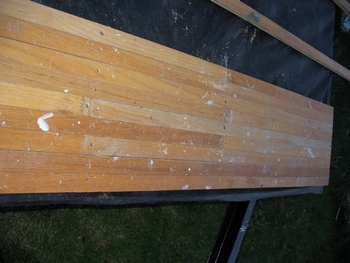

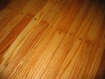

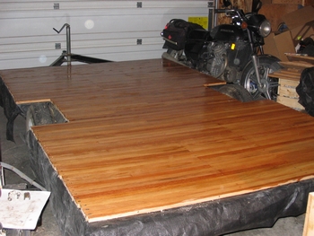

I managed to finish screwing down the flooring, and glued plugs into all the screw holes which will not be covered by walls. In addition, I drilled out and plugged any of the larger nail holes in the hardwood since it is used and recycled from an old house.
I caclulate at 85 rows times 4.5 screws per row (there are five on most rows with joints) that I used approx 382.5 screws to hold the floor down. Each joint and seam in the wood is additionally glued with PL400 for seal, and strength. Probably made and glued in close to 200 plugs to fill holes.
Got my first coat of varnish on around midnight, and I am pleased with the results. This IS NOT the faster or easier way to make a floor. In my case it is possibly the least expensive (since I recycled the wood), but there is a fair amount of labour involved here.
Results below....
Applying first coat.
Finished coat one !
Close up shot.

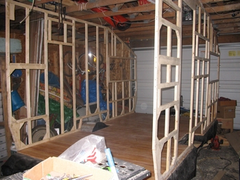

Finally some progress to report.

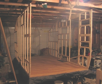

Finished framing the side walls today, so I thought I'd posta pic or two.
Next step is some end walls !!!

Postby jdarkoregon » Mon Aug 14, 2006 8:35 am
GG,
This is very pertty build, my hat is off to you! (but you need a teardrop too!)
My concern is you are putting a lot of weight in the back end of that trailer, is your construction "Weight wise" about the same as what was on that axle? The way it looks, I'm thinking (no real data to back up my thoughts) that your tongue will be lite as a feather. Oh, i'm just rambling, its early, I haven't had coffee, but the sunrise is pretty.
Thanks for sharing.
John
