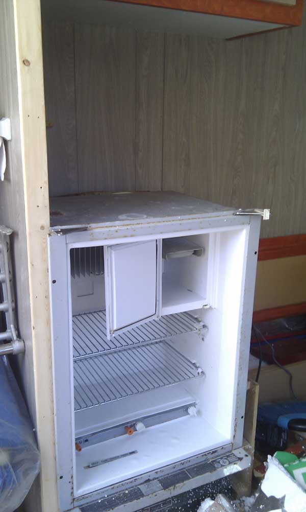

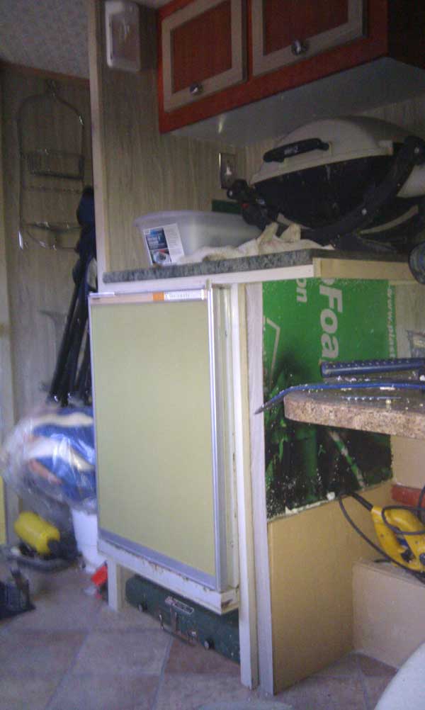

Well, couldnt not try to make it fit, after all I have a working gas fridge.
So I attacked it today

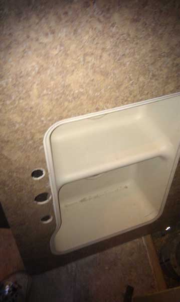

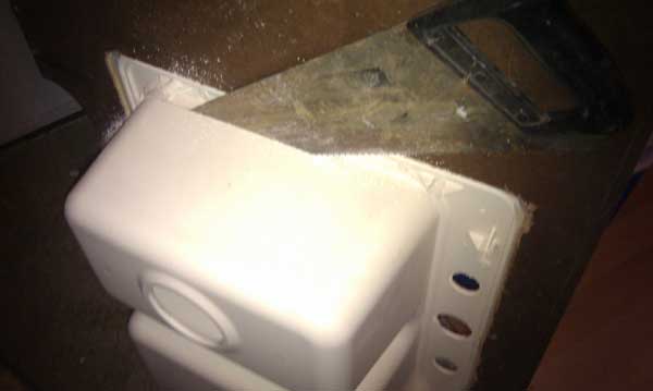

Knocked down the sort-o-cabinet
and It sets in there nice

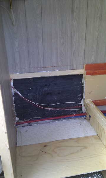

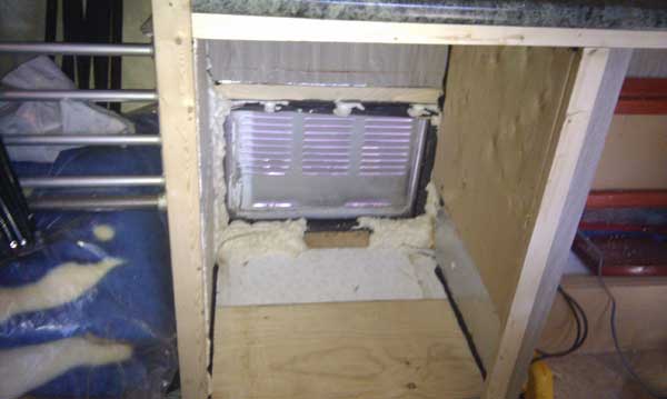

Cut back the foam, I sort of remembered there was wire buried in this section of wall....Yuppers

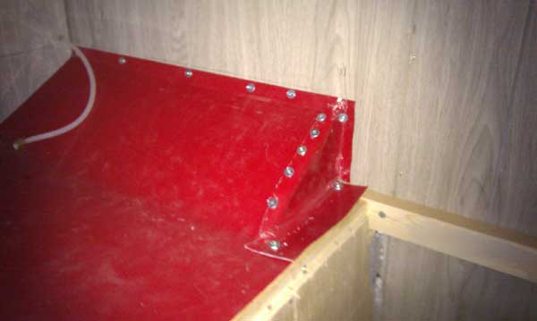

Got it cut out, wires and water lines protected and cabinet built and sealed to the inside

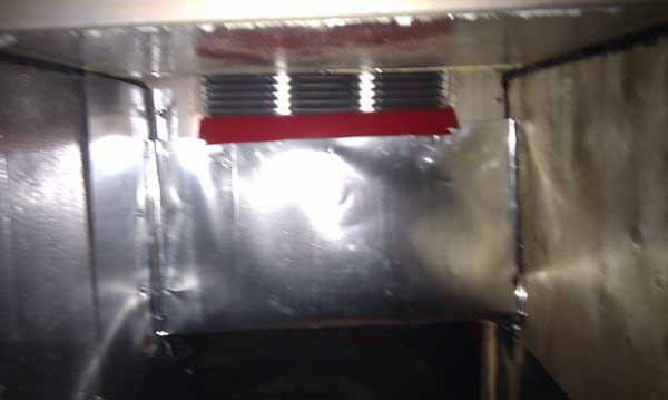

Fridge cabinet insulated with 1 1/2" foil backed foam

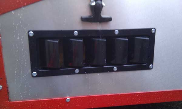

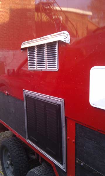

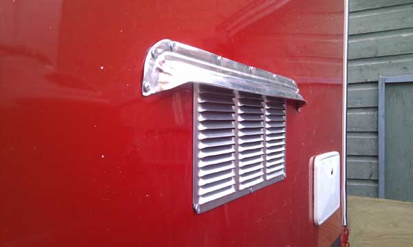

Access door vent installed on the outside

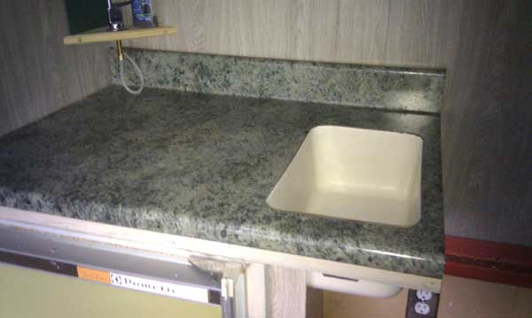

Fridge in, counter in
Just have to run propane line and source a top wall vent for the fridge
And seeing as it is a holiday, I couldn't finish the cabinet under the overhang cause the stores are closed

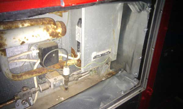

Fridge has a flint spark ignition, I tore it all apart last night cause it was seized, drilled out the stuck flint, cleaned it all up, new flint and it works

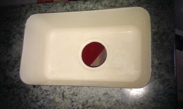

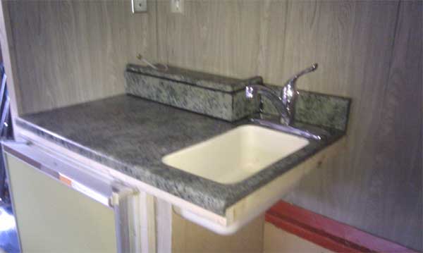

Only have about 9 inches of counter on the overhange, Need to try and get a sink in somewhere for washing up
Don't want to go vessel sink on top of counter, cause I hate them, but may have to
Do they make 9 inch wide bar sinks that don't cost $700, sheesh

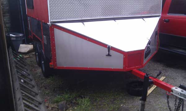

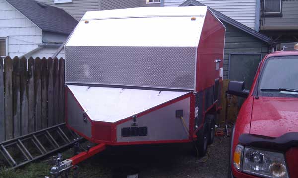

Wonder how much more I can stuff in a 6' 6" x 9' 6" box ????
