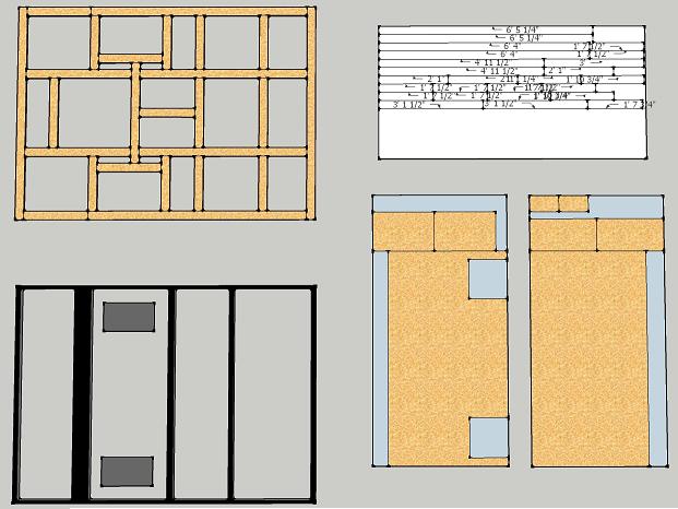

i now have my frame sandblasted, painted, and undercoated. The new tires are on, and I took off all four levelers, and bought two new levelers for the back corners. I decided it was just too much work to try to restore the old rusted ones with their broken springs. My hope it to go to the lumber yard tomorrow for my first batch of wood. I spent almost the entire day today planning all the details of my floor. I made an accurate sketchup model of the trailer frame, then a model of the floor, making sure that I would have studs to attach bed, cabinets, seating etc. Then I figured out how to cut the sheet of plywood for the framing, and lastly, how to cut the underside, and flooring out of 4x8 sheets.

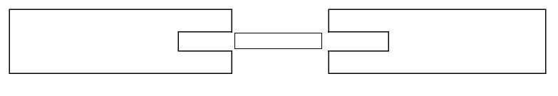

The "studs" will be cut from 3/4 cabinet grade plywood, and will be glued using 1/4 ply laid into the 1/4 grooves I will cut into them. I purchased a 1/4 groove cutter for my router. The bit cuts a 9/16" deep groove into the edges of the plywood. I will be using a very minimal amount of fasteners for the framing. Below is a crude picture showing what I am not explaining so well.

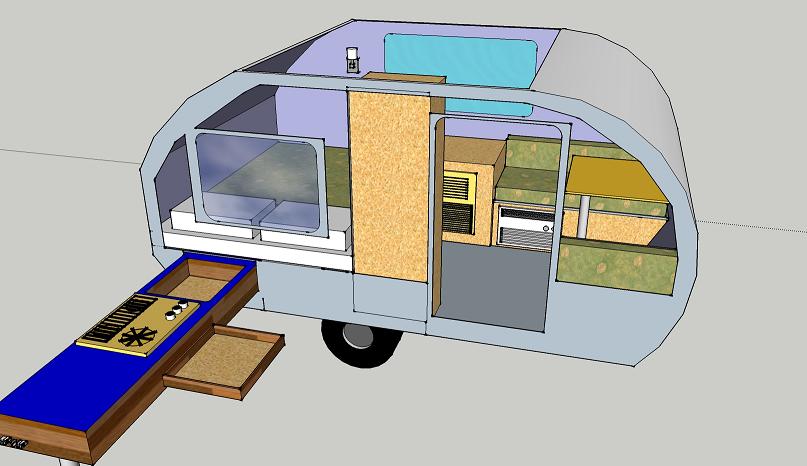

I like this so much that I am going to do a similar lay out. Funny how I laid these things out 50 times and never came up with this.

I'm not understanding the floor 'studs' and why fabricating them out of plywood is preferable or desirable when ordinary 3/4-inch framing stock is so commonly available.
Is this framing being laid on top of the plywood floor only to be covered by more plywood to form a sandwich or is this framing beneath the plywood floor? If the former, then the splined joints would be unnecessary. If the latter, then I don't understand why you simply don't cut as few transverse pieces of plywood as possible and then join the pieces with wood strips glued and screwed over the joints. That would seem sufficient without any need for the studs.
For example, the floor of my trailer is comprised of just three pieces of 3/4-inch plywood with each of the two joints covered by 1-foot wide plywood strips screwed and glued to the underside of the floor. The floor was than bolted with 4 bolts each fore and aft to the frame. That's it. There is very little frame beneath my floor but the 3/4-inch plywood is sufficiently strong that no flexing is evident even over unsupported areas around the perimeter that overlaps the frame, mostly because the walls and interior framing adds considerable rigidity.

The floor, will basically be like a hollow core door. 1/8 luan on the bottom, and 1/2 inch ply on top. My thought with doing this rather than 3/4 ply was just for insulation value, both thermal, and sound. I was also thinking it might be a few pounds lighter, but now that I'm thinking about it, I could probably shave weight by going with ply that was 11/16 instead of 3/4.
Am I overthinking this? :thinking:

parnold wrote:The floor, will basically be like a hollow core door. 1/8 luan on the bottom, and 1/2 inch ply on top. My thought with doing this rather than 3/4 ply was just for insulation value, both thermal, and sound. I was also thinking it might be a few pounds lighter, but now that I'm thinking about it, I could probably shave weight by going with ply that was 11/16 instead of 3/4.
In my humble opinion, I do believe that you are overthinking this. 3/4-inch plywood as a floor would be quite thermal resistant. Much of the interior with be cabinetry that could have insulated bottoms as I did with little effort because the cabinet framing could be 3/4-inch thick screwed to the floor. Also, the interior floor could have a covering of carpet tiles, rugs, or the foam stuff that I used. Each of these materials has insulating properties.

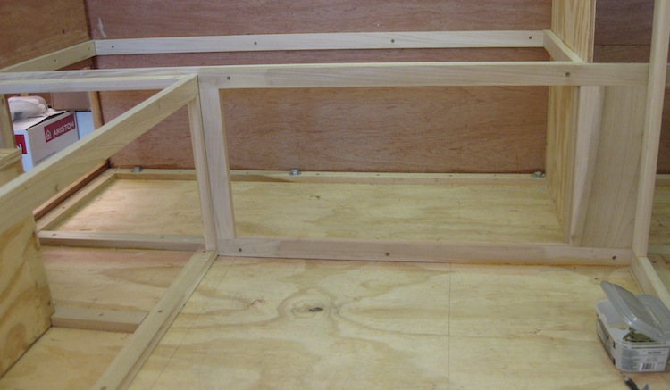

Have a look at some of the pictures of my build for the floor and the perimeter framing with insulation to see what I mean. Here are a couple:
See how the framing forms a natural box in which you could put 3/4-inch insulation and then cover it with thin plywood (I used 5mm).

The drawer kitchen is really a great idea. :applause:
I've laid mine out and am still changing it as I build. I don't follow plans very well anyway. ;)

I love that pull out kitchen.

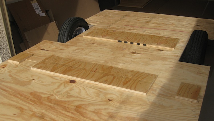

I had one of those incredibly frustrating days today. Trip to the box store this morning for lumber, uneventful. Got home, got out the special bit for my router that cuts a 1/4" groove in the edge of the plywood. I thought this would be a good solution at joining the ply for my floor. Only problem the bit required a 1/2" collet, and my router had a 1/4" collet. Trip #2 to the box store for a new router. Back home and start "grooving" the ply. I bought a sheet of 1/4" ply for the biscuit part, so I ripped a 1" strip, and test fit it. Now the steam is coming out of my ears, because this stuff that was labeled as 1/4" is really only 5.2 mm, and 1/4" is 6.3 mm. Trip #3 to the box store, and I bought 24' for lattice that was 1/4".
Did I mention that the box store is a twenty five minute drive each way! :x
Tomorrow the floor will be attached to the frame and undercoated. I will build a temporary table to work on my wall framing, and I will have my wall profile done. The wall studs will be made of cabinet grade plywood, 23/64", and from the strips that I have cut so far, very few if any voids.
