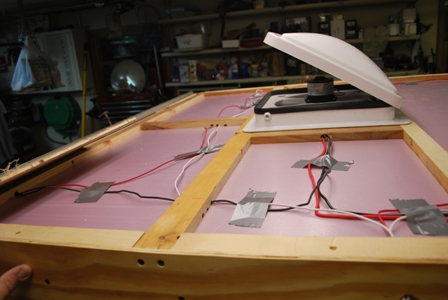

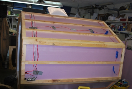

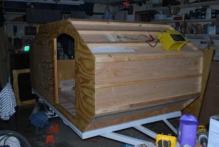

Anyway, I got the 1st layer of insulation installed in the roof. Then, after digging a water pond and moving several thousand pounds of rock (what this had to do with me working on the camper on my extended weekend I'll never know), and I wonder why my back hurts all the time? Oh ya, and "we're" still not done with the pond yet.
the wiring is installed, hooked up, and tested.
Even did a temporary installation of my Fantastic Fan to test it out, and it is FANTASTIC!

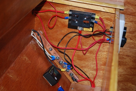

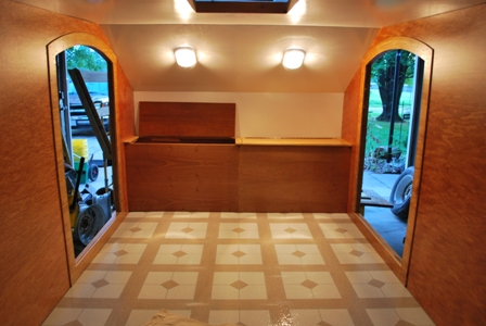

My 12V system / wiring is in the front and my battery will be located on the tongue, so I decided to put the fuse block (from Autozone) inside the headboard / storage area. Used a piece of copper flat bar stock to attach my ground wires to, drilled and tapped holes in it for screws. Should be easy to access if needed. Still kind of sloppy in the picture, but I'll straiten that up later. Used 14 ga wire for everything except the FF, ran 10 ga to it. Did I need 10 ga? Probably not, but I had it on hand and wanted to be sure.

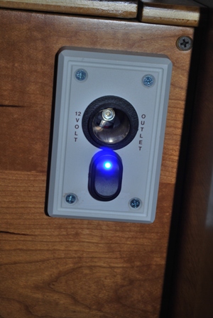

I ran my "porch" lights to a switch on each side of the headboard and located them in the wall plate below the 12V plug in for easy access, they even have a blue "on" indicator light to remind you that it's on. I'll get a picture tonight. Oh, there it is...
Hooked up the battery, installed some temporary fuses, tested everything, and only blew one fuse.
The lighted switches have a 3 wire hook up, 12V - to light - ground, got in a hurry and had the 12v & light wires reversed - easy fix, all is well.

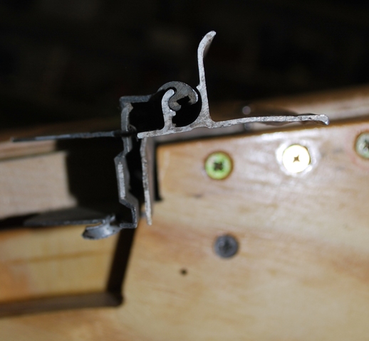

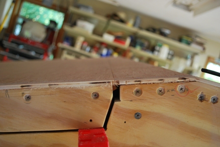

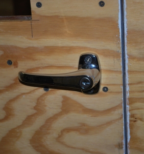

Scrapped the idea of using the camper shell hinge.
Wasn't satisfied with what I was going to have to do to make it weather proof, ain't supposed to be mounted like that anyway, would work, the function's there, just ain't happy with it. I ordered the rubber / continuous piano hinge from Frank Bear along with my 2 door & hatch latches yesterday.
Went to the local salvage yard Friday and pulled off some aluminum roof edge trim, door (knob style) latches (which I later decided not to use), along with some other miss o'lainyous "novelty" items for $20. (stinks to be poor)
