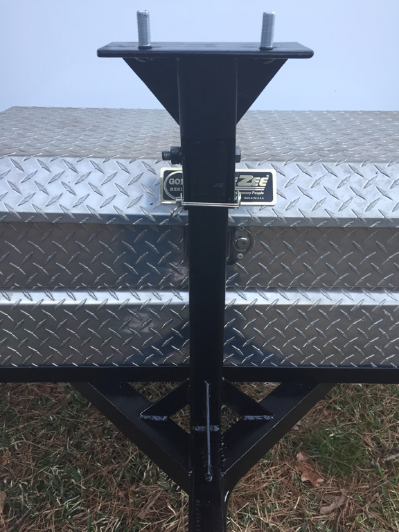

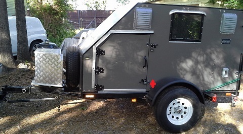

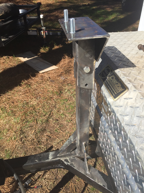

When first contemplating a location, I saw that I couldn't mount my spare under the trailer, for lack of clearance (I thought I would off-road it, later), so I mounted mine directly to the front wall (an advantage for a flat, non-teardrop front end),
  • 97624 original mounting
I have a single beam drawbar, and having the open space on top of it, I thought it ideal to let the spare tires' weight be supported by it. I used a 1/2 diameter carriage bolt to secure it to my front wall, with a self-centering bearing inside the hub. I used locking chains to make it safer. But, after I reluctantly, HAD to have a tonguebox (for balance/storage needs), I really couldn't find another place for the spare; besides, by then, I liked the look, and then again, the weight balance would change. I didn't favor the appearance of the 27" diameter tire conflicting with the width of the box, and after I found a box of similar width (to the tire),
aluminum tonguebox.jpg (22.7 KiB) Viewed 2318 times
I devised a sliding tonguebox mount,
  • 113816 made a triangular base from treated wood
  • 114027 attached boat-seat sliders to it
  • 114187 added upside-down caster to support alum.box plate (red circled)
  • 114188114350 mounting plate pull handle, locking latch (for travelling)
  • 114351 flexible connections to battery in box
  • 114373 spare tire neatly tucked behind tonguebox!
and kept the spare in its' original space (just unlock the base, slide the box forward, access the spare). A lot of work to make, sorta complicated, but it works.

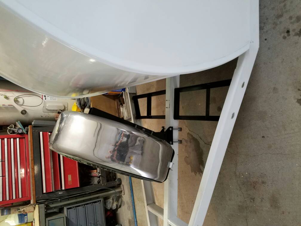

Postby bbrider » Thu Feb 02, 2017 12:45 pm
Mine is mounted on the tongue and pivots from flat to vertical when I need in my box.
