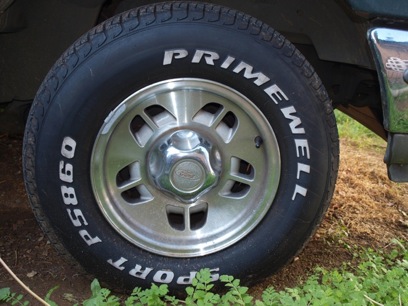

Postby StanDahl » Sun Mar 18, 2012 12:28 am
It would seem to me that that style wheel would only be found on cars from the 70's and older, no? That link Doug included will come in handy. It shows that my Ranger wheels (see below) are 5x4.5, they aren't really what I want, but they might not look too bad, just not very 50's. The front end of my design is going to look like a Stratoliner...

Postby eamarquardt » Sun Mar 18, 2012 6:46 am
I got a full set of four of those exact wheels off of Craigslist for $80. Gonna use em on a couple of projects. I picked up a nice set of Ford Ranger rims the week before last in San Diego (they have SS skins that make em look like chrome plated) for $150 for my son's truck (he's "gotten religion" and is gonna put the truck back to stock). On Friday night I picked up 4 Chevy S10 alloy wheels in El Monte (with the hub caps an special lug nuts and plastic caps) for $50. #2 son is moving to Colorado (to attend Mines) and wanted an extra set of rims for snow tires. They were $50 (I thing the scrap value of the aluminum is more than what I paid). I AM the "Rim King" of Simi Valley!
I got all of the rims off of Craigslist. There are a bunch out there and some can be had for good prices.
As trailer spindles stick out a bit farther than car/truck spindles ensure that the hub cap of the rims you choose will clear the spindle. Ford rims are typically 5X5 bolt pattern and Chevy are 5X4.75 but once you find your rims you can order hubs that match the pattern of your rims.
