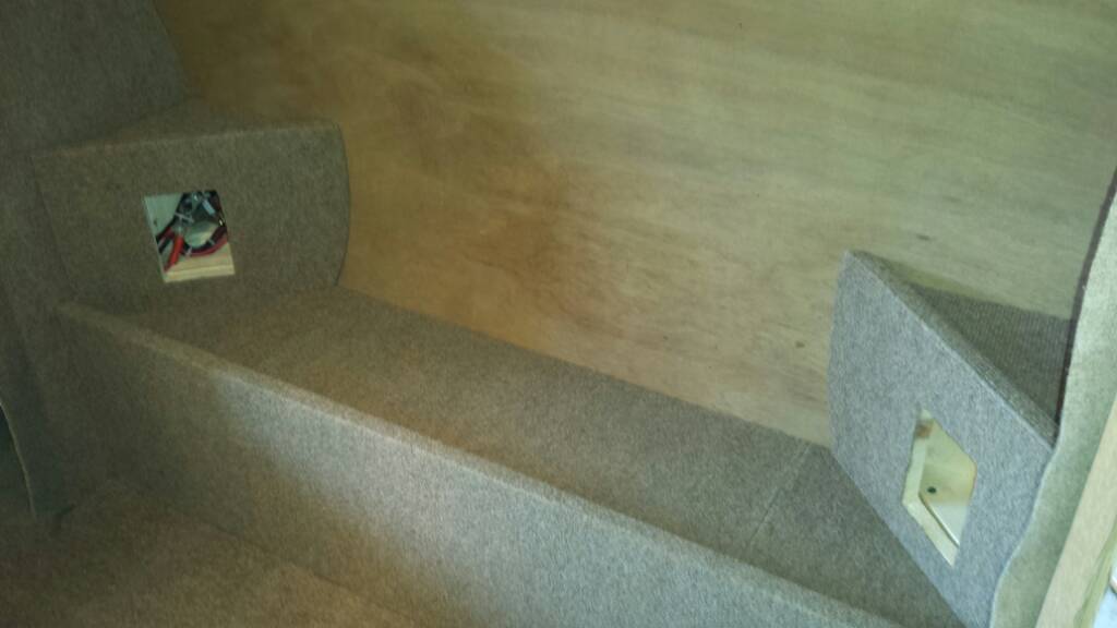

On my weekender I was able to install two full width shelves at the head of the bed. The bottom shelf was actually covering the front bottom bevel area where my DC wiring ran from the battery. The top shelf was installed with ledgers on three sides and pocket screws. The bottom shelf held our night time stuff and the top shelf held our duffel bags and clothing. If your side walls can accommodate it, a full width shelf is the way to go.

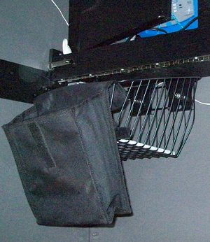

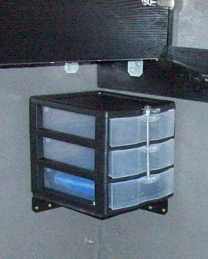

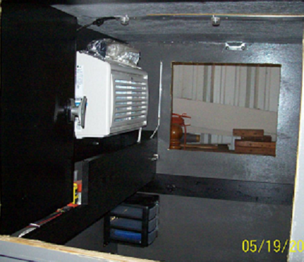

I used both ideas. I made a folding shelf, piano-hinged, with slide-locks to keep it from falling (my head is under it at night). It is slightly cut-away on one side, to access various small storage spaces, and the 120vac plugs and USB charging station behind it. Underneath the shelf, there's a hanging basket for my wife's CPAP? machine, with attached nylon bag to store the sleeping mask and hoses.She hasn't used the trailer, so I use it for other storage at night. Also, under the shelf, but mounted in the corner above mattress height, is Sterilite 3-drawer organizer, I use for my glasses, wallet & keys, and small flashlight and phone. I think I paid $12 for the basket at HD, and $5 for the drawer set at Walmart.
as seen thru window cut- electric box,folding shelf,elevated nightstand on bulkhead.png
