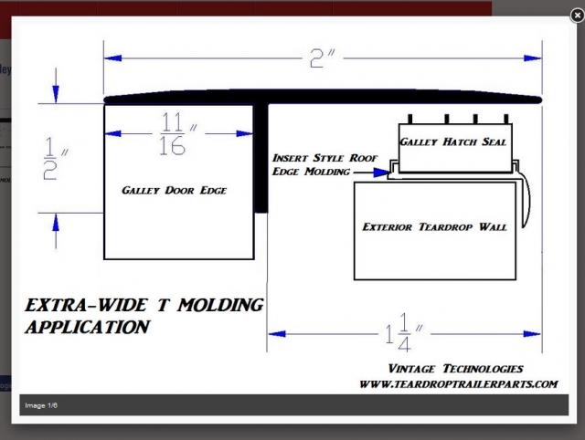

Are you using a metal skin on your trailer? If so you will need some sort of edge molding to hold that skin down. So you must consider that thickness when you plan. If not I would suggest some sort of metal. There is an edge molding that is about 7/8" wide and has a 1/4" leg. (makes an L ) This can be put down on the edge of the side where the galley lid will close. This helps with the water not being trapped against wood when the galley is closed.
I do not have a great picture to show you. This is a different hinge then you are using but is a flush style hinge. I cut a notch for the gasket in my side walls. The side of the trailer had edge molding without the insert. The top piece on the galley lid had edge molding with an insert to cover the screws. If you want to do a real good job, I cut a thin strip of aluminum under the galley lid where the seal will go and drill through the insert molding on top of the galley and tap some small screws to hold the aluminum strip in place. This gives to a metal to metal area for the gasket and no trapped water can destroy your galley. But you need to make a sample mock up with all the thicknesses of everything to be sure that the gasket works. If you can not make sense out of what I'm saying I can draw a picture to clear it up.
in this picture you can see how the hatch works with all the metal.

WB, thank you for your time on this. I think i see it now. I had envisioned the roofing to run all the way to the outer edge of the walls, but using the wide t molding the roof will run to the t moulding, and the t moulding will bridge to outer of walls leaving a 1/4" gap. Using the offset hing will get me another 1/4" less the thickness of my trim on the walls? Thank you again for your time.

This is what I think im trying to do? :D This image is from Frank Bears website. If I do it like this the roof would stop at the inside of the t moulding and not go a the way to the outer edger of the the wall?

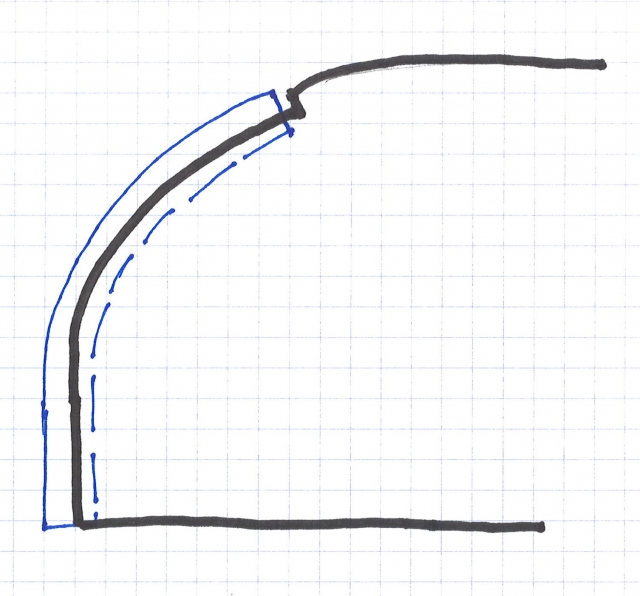

My approach was to think backwards. I used a 3/8" seal. As a general rule of thumb, you want to compress the seal about 1/3 of the way. This worked out to a 1/4" gap. This gap needs to be 1/4" all the way around the sidewall - 1/4" up and 1/4" out.
I wanted to keep the hatch profile on the same general profile of the teardrop sidewall. To do this, the outer edge of the hatch "ribs" matched the profile, but the sidewall was notched to create the gap. Here is a (poorly drawn) sketch of what I did:
The sidewall edge is the heavy black line. The hatch rib is shown with the blue lines.

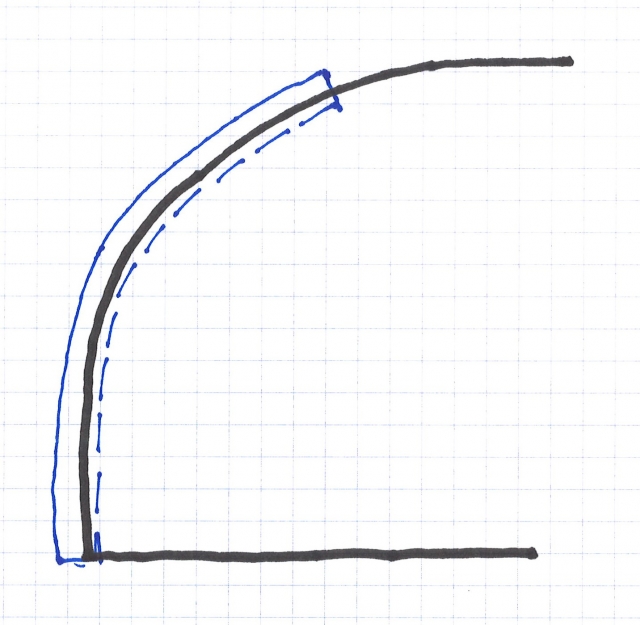

The other option is to offset the hatch "out" from the sidewall profile. In this example, the hatch ribs need to extend the chosen gap distance beyond the sidewall. Here is a sketch of this approach:
If you go this route, you have to use an offset hinge, and the ribs must be cut the gap distance beyond the profile.
If you use an offset hinge, but cut the ribs to match the profile, you'll have the desired gap at the hinge but you won't get the desired gap at the bottom of the hatch. The offset hinge will lift the ribs "up" but it won't lift the ribs "out". I believe this is the situation you are trying to work around.
