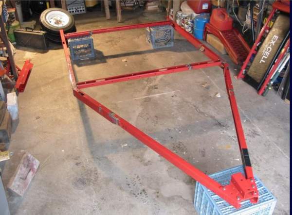

If you have 48" of tongue sticking out, as many do, running the tongue back under the trailer just 20-24" is just not enough.... 48 in front should have 48 in back to the 3rd x member, not 24 to the 2nd x member..
My current t/d has a 26" tongue in front of the frame and is A shaped tongue.. the 2 pieces of the tongue run back 40" to the sides of the trailer which is much more rigid than running it down the middle to an x member... The sides of the trailer become part of the tongue support..
I consider this A tongue to be far superior to the traditional straight tongue even if triangulated, as it is really 2 full length tongues and much stronger.

All Harbor Freight stuff is cheap so you don't want to ever push the envelope on them, and you must maintain them.
Teardrops don't typically push the envelope on them except for bearings and modifications.
Repack your wheel bearings, and run the tongue back to the axle if you decide to extend it, and yes the frames are thin chinese C channel, but alot of people like to go trippin out just because it isn't the Tim Taylor Binford brand ruff ruff tough strong stuff that you don't need anyway. Harbor freight frames are cheap and pretty flimsy, but at the same time they WORK as long as you work within their operating limits... I will build my next teardrop using angle instead of square tube for this same reason. The original Cubs were made this way and lasted until TODAY! :)
I custom built my frame because I have a custom designed frame and wanted a torsion axle and I have a friend who welded it for me for free ;)

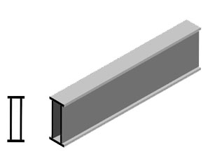

By the way I think your looking for the phrase BOX BEAM not tortion box , a tortion box allows a certain ammount of tortional movement (twist)

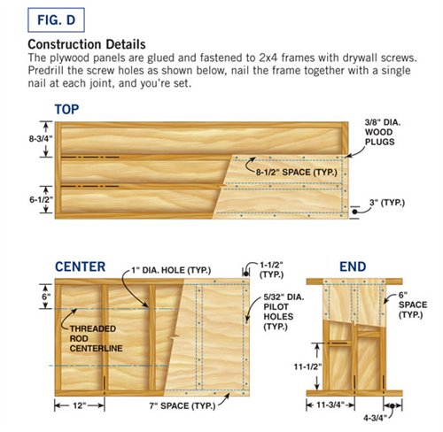

In common everyday woodworking speak, a torsion box is a component made up of two skins separated by a framework. It is lightweight, rigid and resistant to twisting, sagging and bowing.
This picture represents a the components of a workbench employing what woodworkers call torsion box construction. I could not find any other definitions for torsion box on the web.
While a box beam is a defined as a hollow beam made of of boards;
The insulated floor of my teardrop is a torsion box. The insulated roof/ceiling of my teardrop is also a torsion box. Should I mention that the walls are also a torsion boxes? The roof, walls and floor combine to make up a torsion box. So with an insulated teardrop, I have a torsion box made up of torsion boxes. There is not a box beam in the mix as far as I can see.

Yes larwyn That is a tortion box!!! Now add walls and a roof and it is no longer a tortion box But a box beam. Your doors and rear hatch would not continue to operate if it was a tortion box. You do understand wat the word tortion meens . The walls and roof take all the tortion out of the equasion.eaven if they are also tortion boxes. 1+1=2 not 1 you are taking tortion boxes and creating something entirely diferent by fastening them together. Guess I did remember something.....

boxcar wrote:Yes larwyn That is a tortion box!!! Now add walls and a roof and it is no longer a tortion box But a box beam.Your doors and rear hatch would not continue to operate if it was tortional. The walls and roof take all the tortion out of the equasion. Guess I did remember something.....

Re read my post .... I wasent through. Add some curves to your box beam drawing and walla its a cutaway of your tear.Thanks for the help.....Boxcar [img]:thumbsup:[/img]
