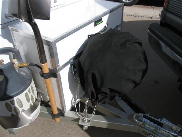

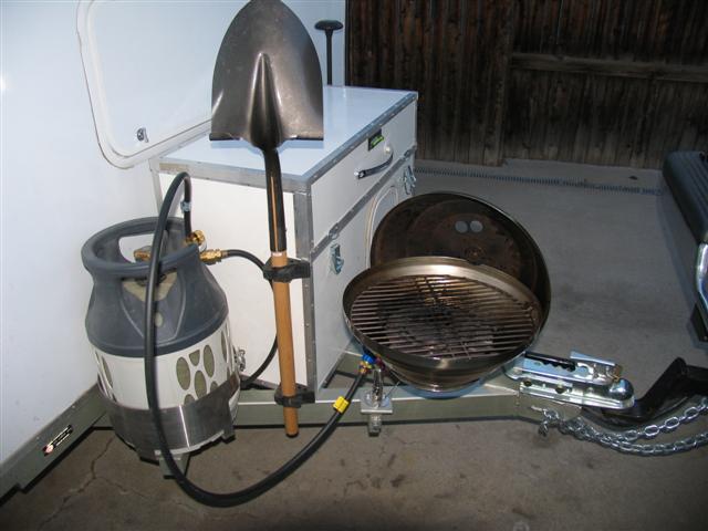

For fun, we camped out in the driveway last night and tried out the Magma grill I mounted on the tongue. I grilled a medium rare steak and it came out great.
Here's the grill in the extended/cooking position.
Its tapped of the main propane tank so we don't have to use the little green containers anymore.
Here it is in the travel position.
The Magma grill is pretty spendy but I found a lightly used one on eBay for a lot less than a new one. We grill just about everything we don't cook in the DO so I don't mind spending more on a nice grill and the Magma is the only grill I could find that had a different kinds of mounting hardware.

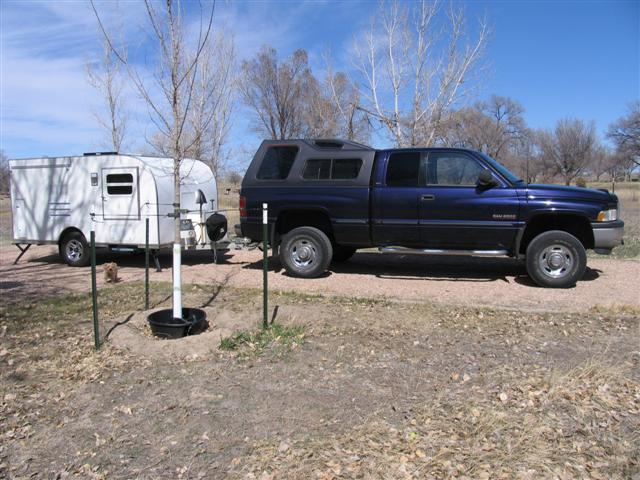

I had the trailer weighed yesterday on the way home from the first camping trip of 2010. Jean's traveling so it was just Misty and me for a quick overnight at Crow Valley Campground.
The axle weight is 2,460#. I didn't have the tongue weighed but that's at least another 300#. :shock: The good news is that the trailer was fully loaded with all our gear as well as water, propane and diesel so it won't get much heavier in the future. I'm glad I stayed with the 3500# axle, I almost went with a 2500#. The tires are rated for 1,820# each so I'm good there. I bumped the tire pressure up to 45 psi, which should give me a 75 mph top speed according to Goodyear.
I'm also glad I went with a composite tongue using 2"X3"x1/8" tubing as it should be plenty strong according to Andrews Tongue Strength page. I tried to save weight during the build but I didn't sacrifice on strength - everything is rated to 3,500#. That includes the trailer brakes as I still have to have to stop this pig....
One of the goals for this build was to get every luxury I wanted into the trailer and that adds weight. On the other hand, the truck didn't have a single camping item in it, *everything* was in the trailer (another goal). My guess is that the total weight isn't that far off from what we were at in the teardrop considering all the stuff that used to go into the truck. I wish I'd weighed the tear before we sold it. I bet I could shave 500# off the total weight by emptying out all the chairs, awning, dutch oven, generator, water, etc. Still, I'm over my weight goal by 300-400#.
The truck weighed 7,300# so the Gross Vehicle Weight was 9,760#. I got 16mpg which is amazing to me now that I know how much everything weighs. I guess I better start paying attention to those bridge weight limit signs... :lol:
