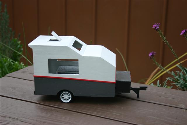

Postby DougH » Sun Jul 06, 2008 9:53 pm
Finally, a fan. I feel like a rock star with my own groupie :)
The thinking on this model/design was that I really only needed a small place to stand and dress so why make it full height full trailer length? And I really wanted a front skylight or two. ( and I really kind of liked the old Olds Vista cruiser!)
