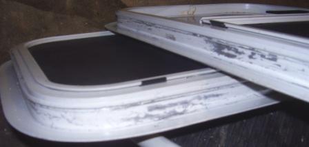

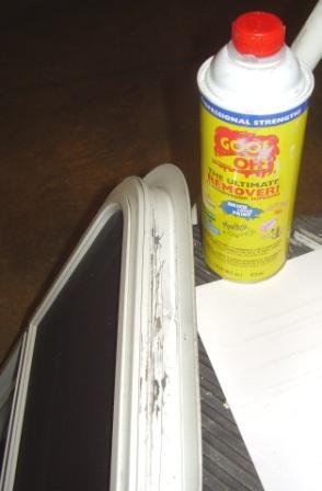

Postby Alfred » Sun Mar 28, 2010 10:18 pm
Hey Gang,
OK - So here's the update. Sharon's right, Goop-Off is awesome. Helped me get the silicone crud off the windows. Still had to use a little elbow grease. It got easier as it went along, as my technique improved.
Basically a two step process:
1. Apply Goop-Off liberally (buy the bigger can of it).
2. Work hard and work fast. It is easier to get the silicone crud off right after you apply the Goop-Off.
OK, here's the "before":
Here's the "afters":
Still took a couple of hours, but now the silicone crud is off the windows and I can look to installing them in my doors.
AL in Asheville :thumbsup:
